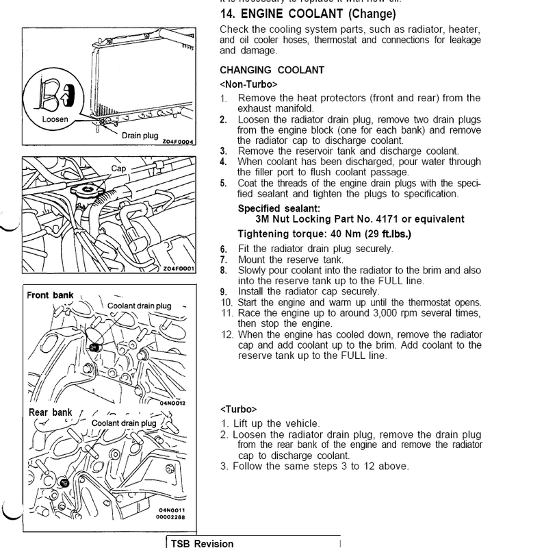

Just read that the coolant system takes 8 litres (if including the heating and coolant reserve)
Just had a quick look at the service book. Each bank of the engine has a drain plug. If you want to properly drain it and properly fill it up you will need to follow the procedure below . I’d probably replace the thermostat after you’ve drained the system whilst your at it as the service book gives this as one cause of not enough heat from heater.
coolant swap
Oh wow. In that case i definitely did not flush the system properly as it only took about 4 litres of coolant after flushing. I thought you only need to release from bottom radiator drain plug.

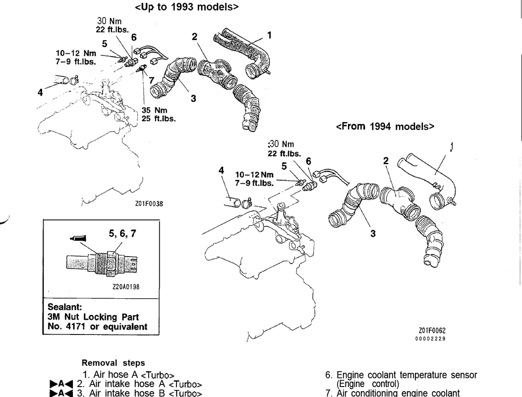

There are 2or 3 temperature sensors on the thermostat body. Might be worth checking they are connected properly. part number 6 in particular
