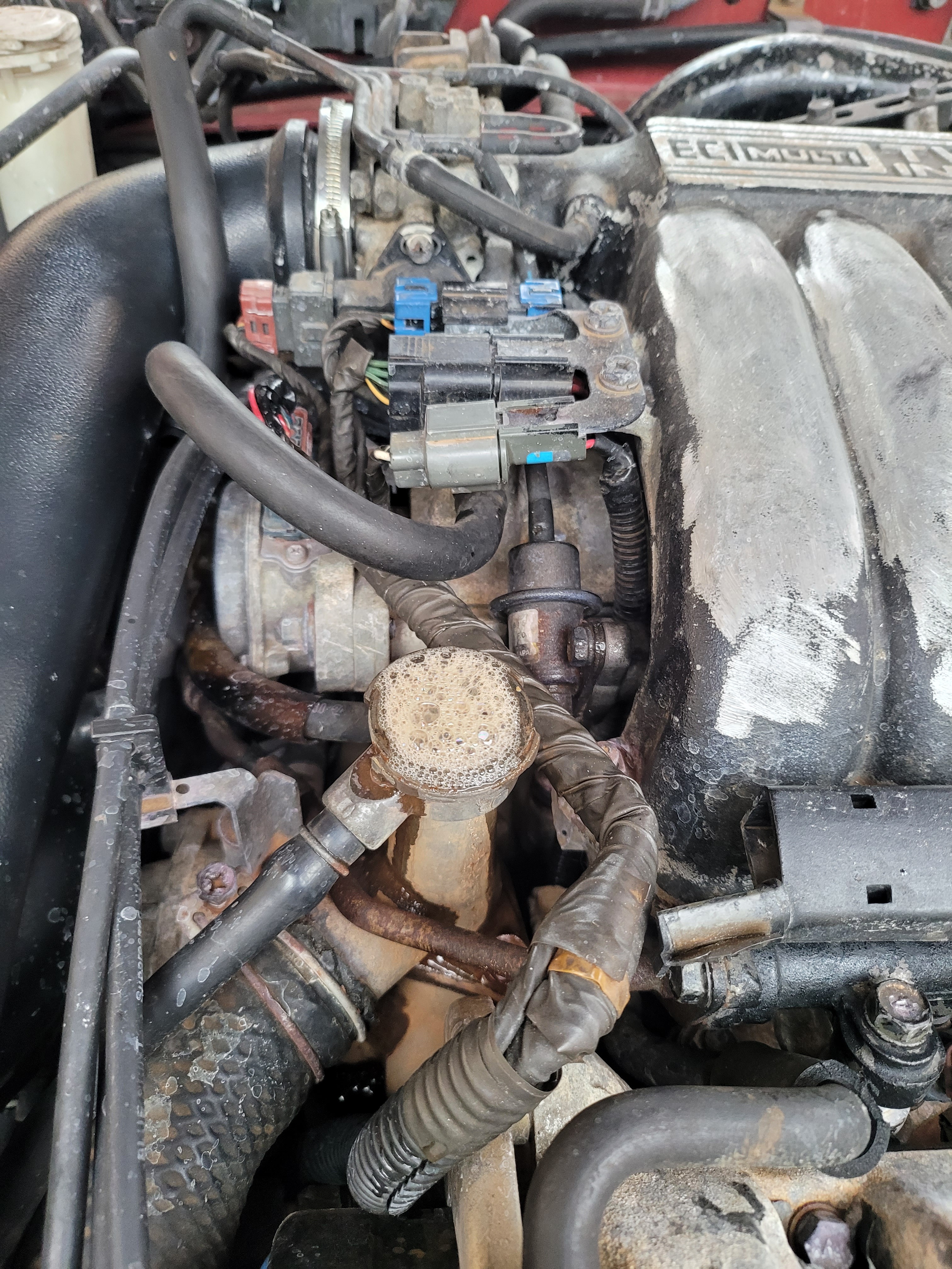

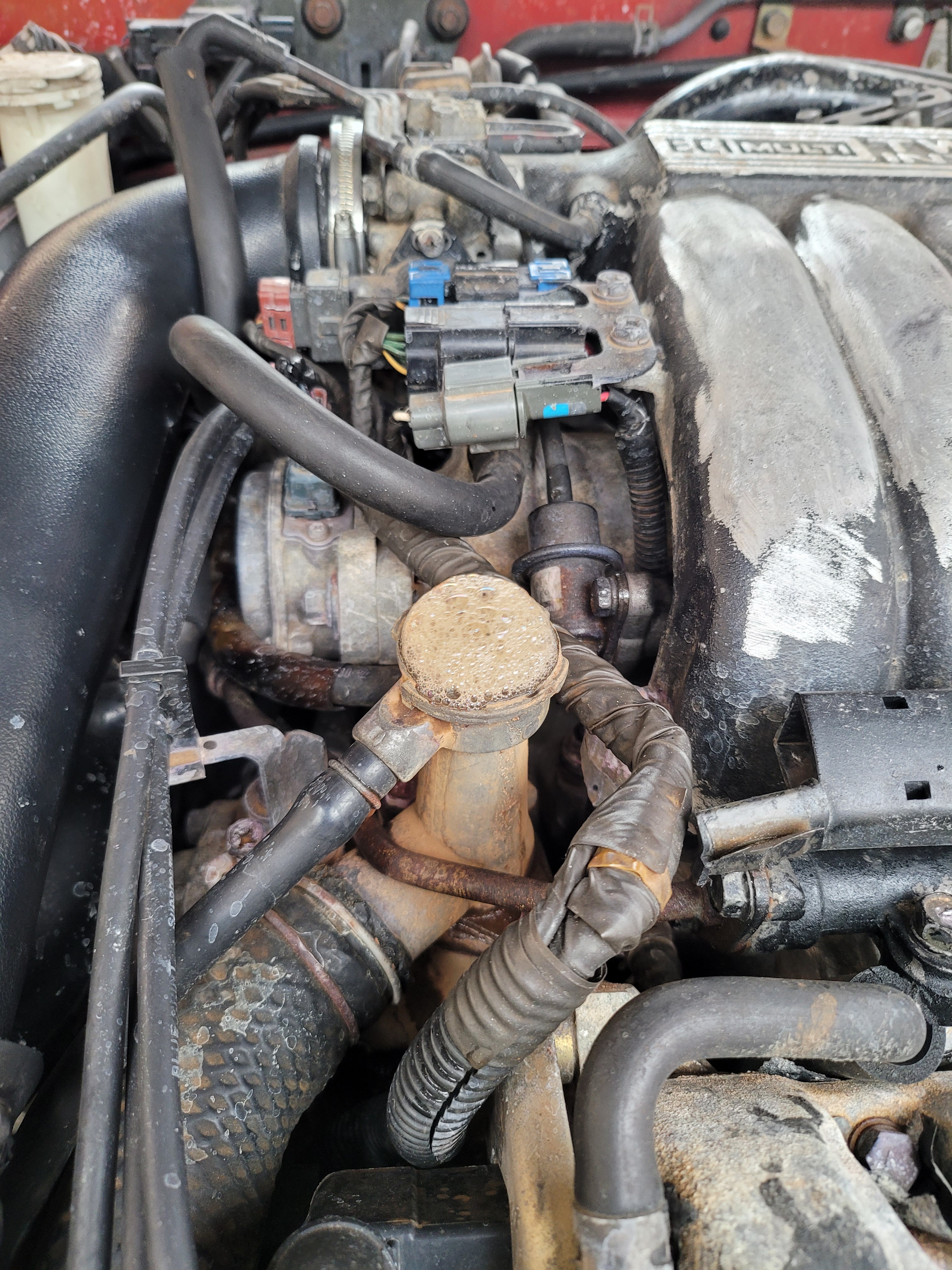

I let out some coolant from the bottom release tap and refilled from top to bleed a little more. This is what its looking like. Tiny air bubbles,

In an ideal world when refilling you’d have both drain plugs removed. Then start slowly filling up until coolant came out of the lowest plug,put that plug back in,then keep topping up until it comes out of the 2nd plug,then put that plug back in ,then top up as you have been doing the rest of the way.

I flushed the system again and tried to bleed but still had no hot air from the vents. I then disconnected the heater in and out hoses, connected my garden hose to the output hose and extended the intake hose to a bucket and turned the water on. There was alot of junk in that heater matrix. Result… I now have heat
So it was a junk lock instead of an air lock
