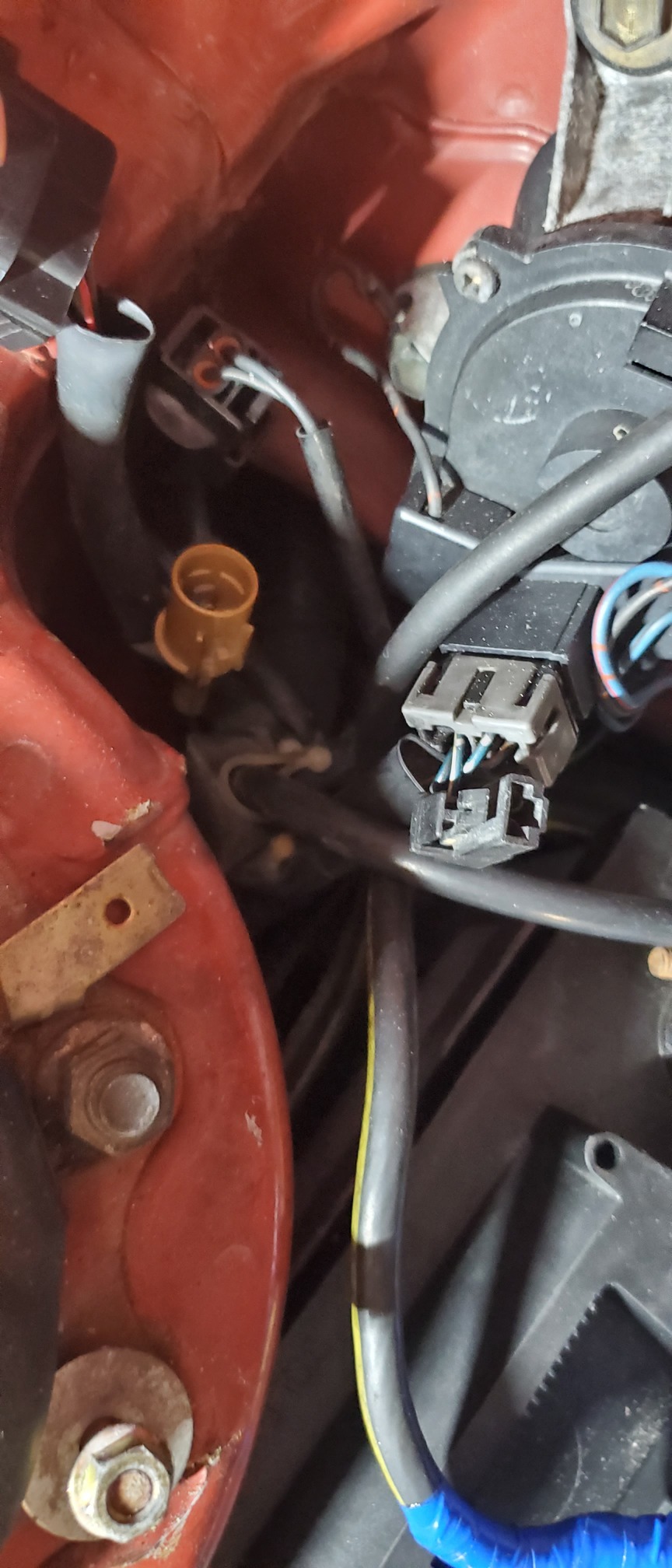

Also i have a couple of wires i cant find any sockets for and a broken interior switch and a switch thats added of which i cant find out whats its used for any ideas?
Rear fog light switch ?
That’s probably a good shout. My '98 car has a headlight adjustment dial where the missing/broken switch is, but I believe on the earlier cars it’s a switch for the active exhaust.
That rocker switch maybe to isolate the electric motor on the radio aerial ? I did the same on mine to stop the aerial going up every time I was only listening to mp3’s etc. Saves on wear and tear and reduces the amount of water getting into the motor etc

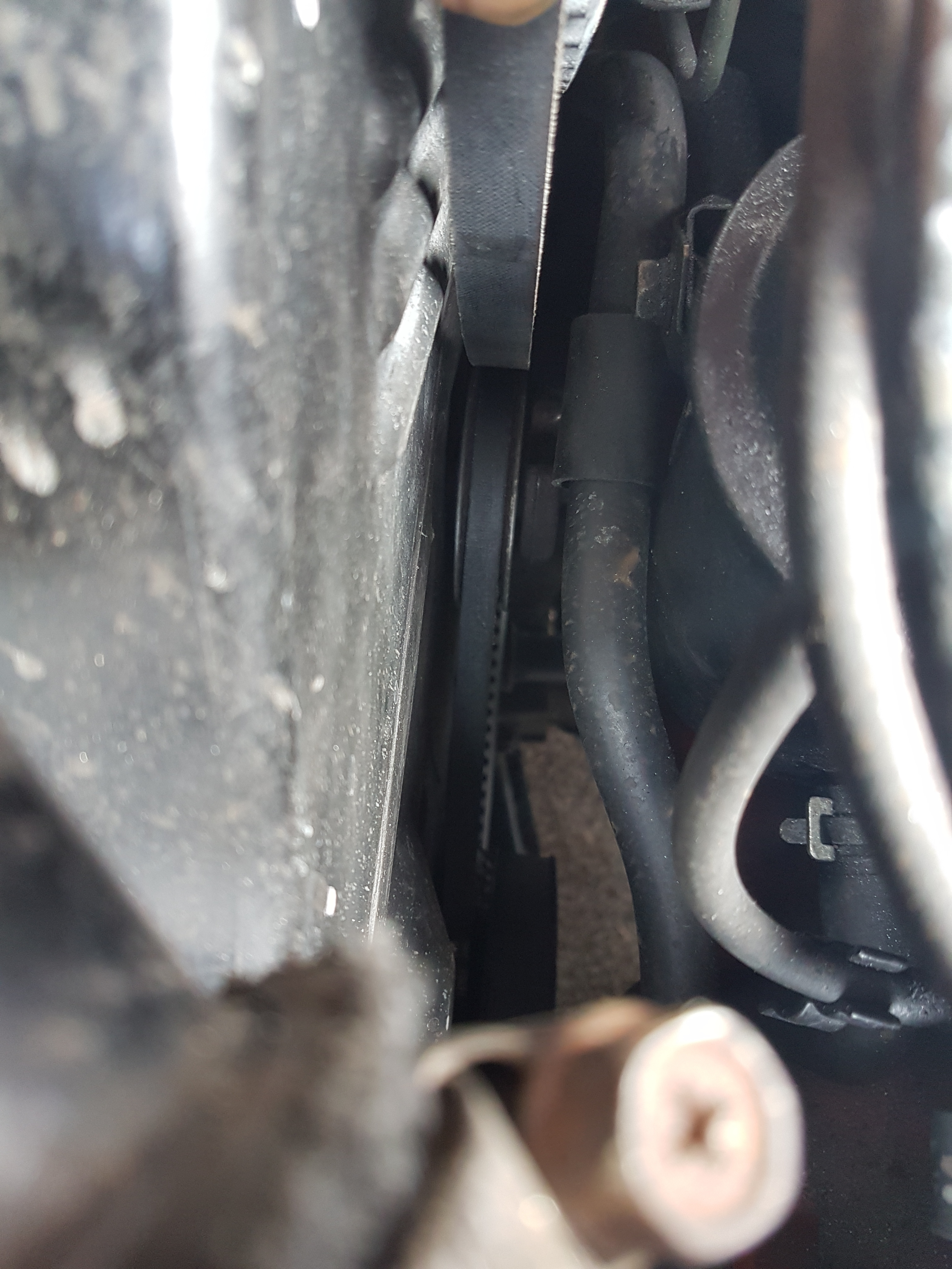

Ello ello gents. I received my new power steering belt and its the size redmonster900 very kindly advised me of. However, when i compare the width to the very noisy belt that is currently on the car its thicker. It appears that they installed a belt for a tumble dryer
I just realised to get the power steering belt off you gotto take the alternator belt off first. Gutttteddd
Is there a easier way of installing the power steering belt in place? I have released the tensioner but it’s so tight it just doesn’t wanna fit in
Could be the wrong size belt ?
:disappointed_relieved: i hooope not. It looks like its the right size but i think i need another person to stretch the tensioner so i can bolt it in place.
