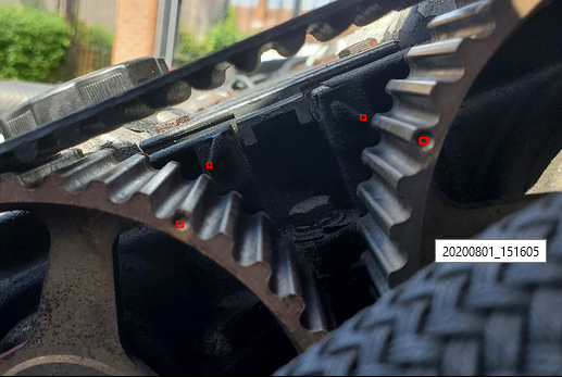

it was a second hand one for 35 quid. it sounds like its much easier to buy the right one
the engine started every time (and still starts and runs) but very loud. i never ran it more than 30 secs
Not sure about this one, better to do a compression test first as Joe suggested, when mine had jumped a couple teeth was cranking over but didn’t start, and there was not further damage !
So the fact that it starts and runs is a bad thing? i thought the opposite :pensive:
Starting and running the car with the timing off is the bad thing. Everything else is down to luck. None of us can tell you if you have damage. It is only a guess as to the likely hood. You will have to do a compression test to know the answer.
IMHO the 1st picture looks like they are perfectly lined up ? The 2nd pic looks like the crank (not cam) needs a slight rotation to line up with the cam timing marks…without adjusting anything… but still best do double check. along with the timing mark on the crankshaft.

I think picture 1 is the front bank of cylinders and picture 2 is the rear, hence the two banks are about two teeth out of time with each other. Looking at each bank in isolation, the two cams appear to be correctly timed with each other if you see what I mean. I wouldn’t start or crank the engine anymore until a compression test is done as described by Joe and Spiros.
Wow, you guys are greatttt. Honestly much appreciated.its getting looked into as we speak. I will find out how lucky i am in a few hours :smiling_face:

Ah, good spot Matt. My mistake. In my defense it’s about 3 years since I did mine :zipper_mouth_face:
As you rightly saycheck everything is correctly aligned first before starting the engine again
No worries. I did exactly the same thing when I first looked at the photos until I realised what I was looking at!
Hoooorayyyyy. Timing belt changed, alligned and no damage :partying_face: . The noisy power steering is still there but witha working engine doesnt evenbug me :rofl:
