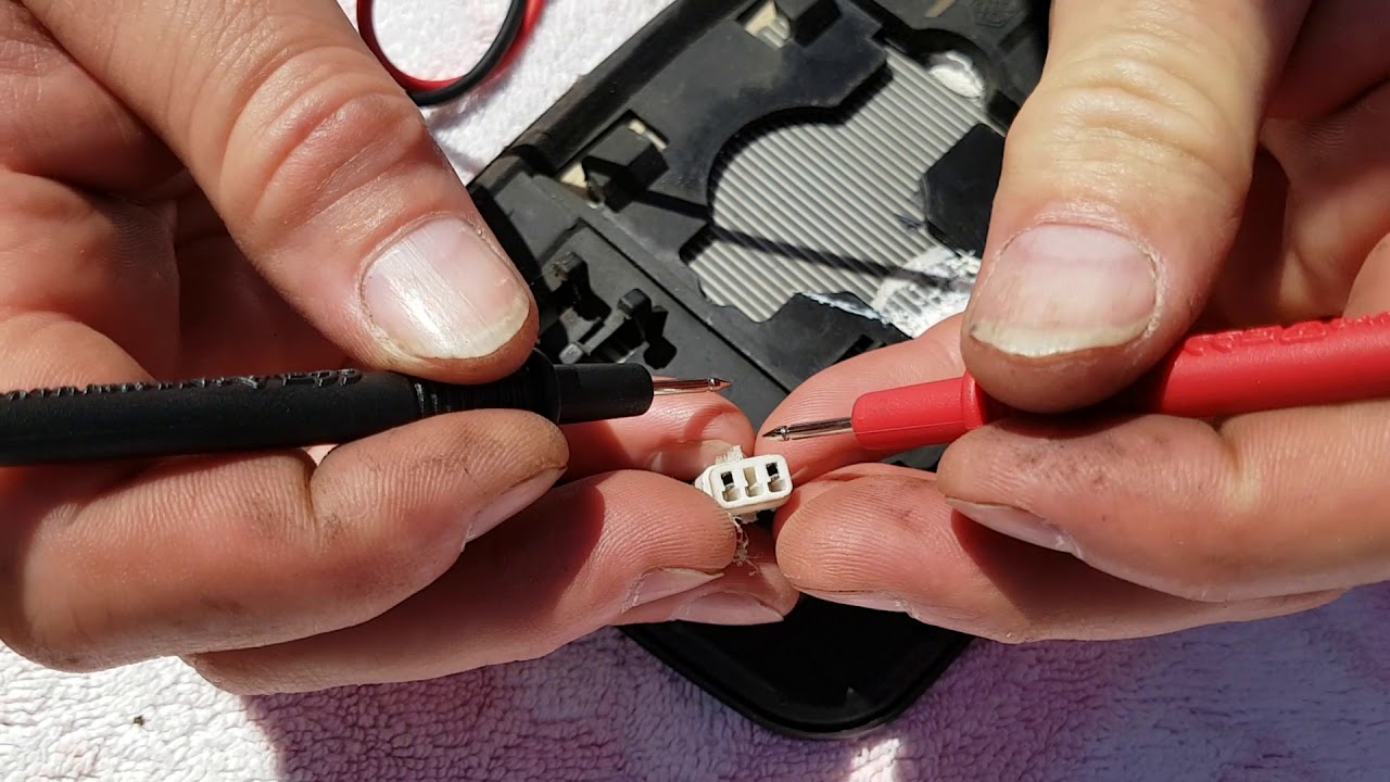

Hi Anton
I still think that cleaning the contacts in the switch may help, but if you want to take the Mirror glass out of the Mirror shell, Joe has made a excellent video showing how to remove it
