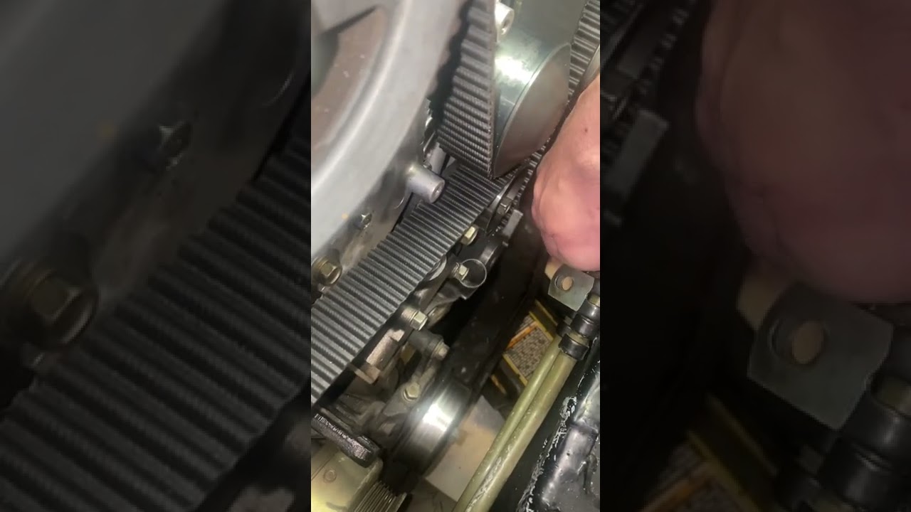

I found this video that shows a noise at each timing belt revolution and how he adjusted the tensioner to eliminate the noise.
I did send you a message about it, it very well could be the issue, regardless it needs to be further investigated, with such a noise its not recommended to rev the engine let alone drive it. I would do the following if I was you for starters: remove the front valve cover, remove cylinder 1 spark plug, make sure the piston is at TDC on the compression stroke and NOT the exhaust ( a lot of people do that by mistake) and check all the timings marks, if there is no issues there then yes the belt keeps the required tension and has not skipped a tooth or two, however, considering this is a fresh build meaning you have not gone out on a road trip, no damage has occurred yet due to complete tensioner failure. In my PM to you I explained the theory of how the hydraulic tensioner works in conjunction to the applied required tension on the belt as soon as the oil pressure gets into the tensioner reservoir, and then there is an air release valve, interestingly that noise could very well be the sound of the air gushing out of the tensioner at each precise revolution of the belt. time to touch the tensioner with the scope. Not sure about this video clip you sent but I shall check it out, a faulty hydraulic tensioner ultimately needs to be replaced, or else you are playing with fire.
Thats funny i just read my message, I meant to say when the lubricant ( oil ) that is sealed inside the tensioner that has components that moves the tension pin up or down is activated when the belt starts to rotate moving the tensiner pulley assembly. I was thinking about other hydraulic tensioners that are directly provided with oil by the main component. These ones are sealed, sorry for that confusion.
yeah all he is doing is altering the tension on the belt to reduce that noise, bottom line is that the specific required tension in inch/ft pounds on the belt needs to be precise and consistent at all RPMâs and the tensioner needs to be replaced if its faulty.

Could it be this tensioner arm causing the belt to walk? Itâs the only part I havenât replaced. I wonder if a bad tensioner arm could be the source of my noise too.
The tensioner arm is a possible cause of the belt drift but I havenât had one making a noise.
Iâm having a hard time getting the tension set to where it wonât change.
I rotate the tensiorer pulley so that the pin is loose, I tighten the tensioner pulley bolt to 48Nm. After tightening the bolt the pin is still loose to where I can remove it easily.
I step away for 2 minutes and the tension changes to where the pin is unable to be removed. What is changing the tension after everything is torqued down?? Itâs not a big tension change. If I back the torque down a little on the bolt, the pin moves freely again.
Do I need to rotate the crankshaft the 2 turns immediately after the pin is loose and not give it a chance for the tension to change?
The point of the auto tensioner is for it to go slightly slack after the car sits without running. The tension will change on its own no matter what you do. It is by design.
After several failed attempts I have finally achieved perfect belt tension after rotating the engine 2 revolutions. Pin is easy to remove and even spins freely!
