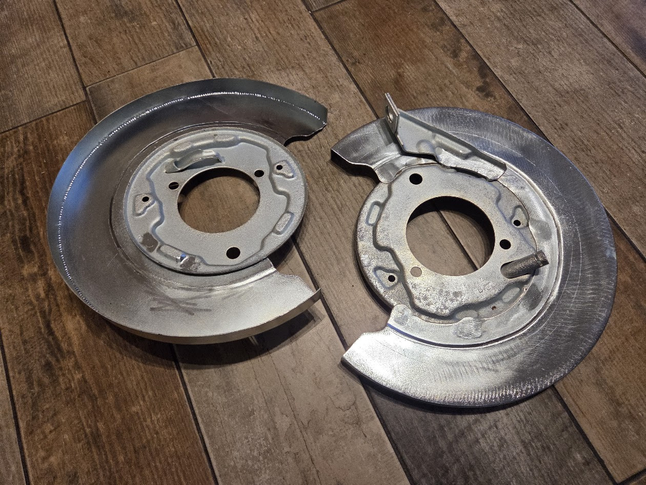

This is the final product that I hope to achieve.
Every dust cover and backing plate requires a separate high pressure press die and they take a long time to make so as with everything else, please be patient.
It is worth the hard work if you want perfection.

That’s a great effort !
I am definitely signing up for those… Need, need, neeeeed :point_up:
Really impressive stuff Joe! Press tooling doesn’t come cheap :grimacing:

Wow, that looks fantastic! With just the dust - do you plan it be to srewable on the backing plate or spot welding will be required? However probs best to get both together, not sure how nicely the backing plate would clean up. Will be definitely worth the wait. I am in!

The rear dust shield will be as from the factory so you can spot weld it. I have a industrial spot welder now so I can spot weld them for you for free if you want.
In the video, I will also show how to mig weld them or rivet for those without any welding facilities. They are welded in 8 places so 8 rivets will be more than sufficient to hold.

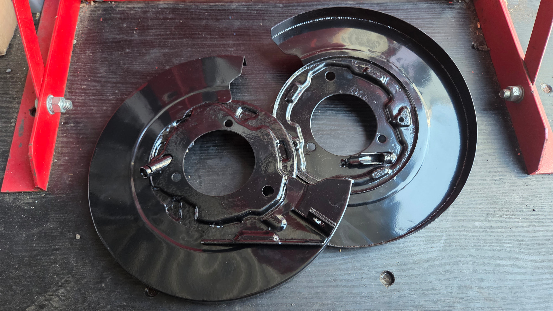

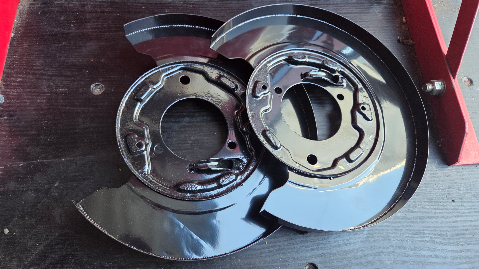

I have one pair left I had fabricated in the UK, these have since been powdercoated. These are for 297mm rear discs, but I’d imagine there’s a chance they would actually fit the 284mm brakes too with little or no modification.

Here’s the only pair I have left ready to go if anyone is interested;
