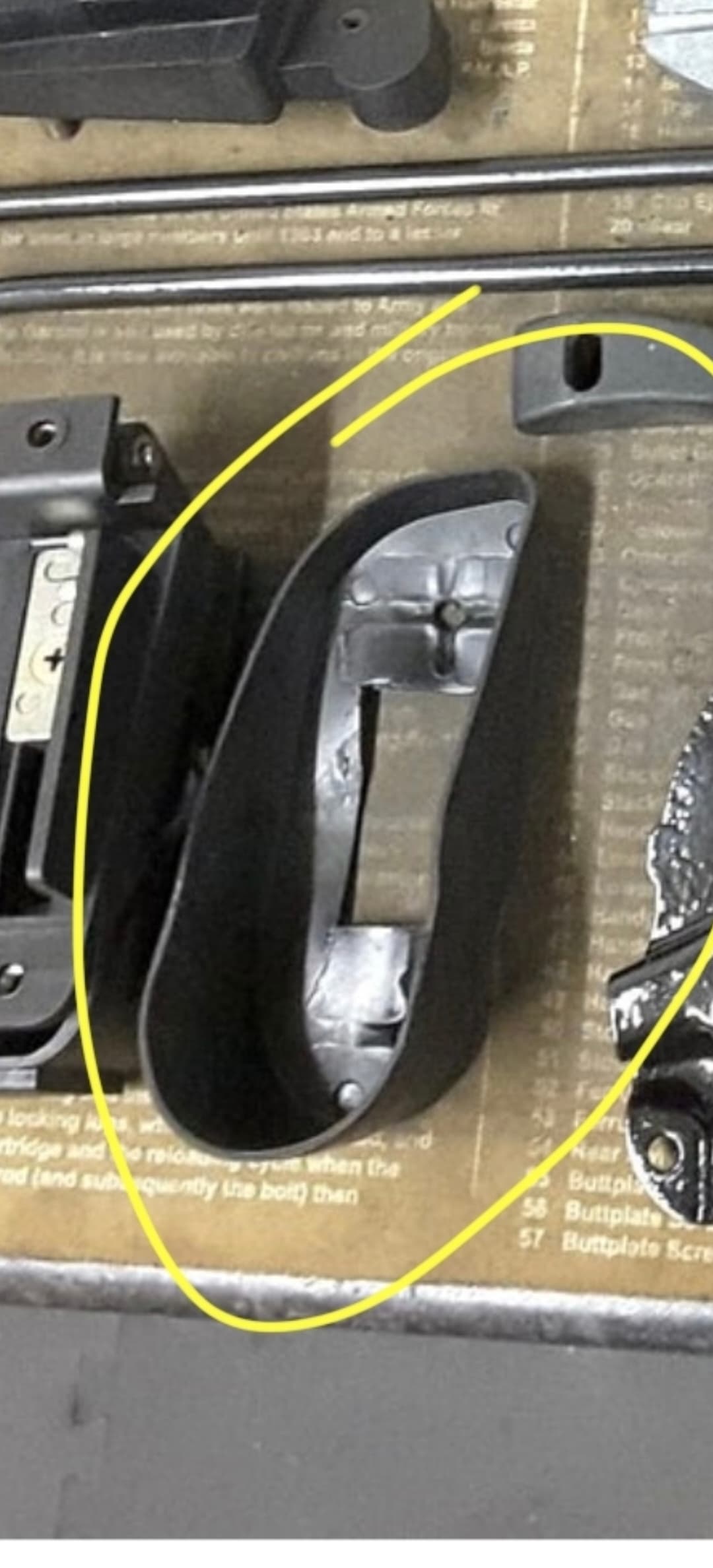

Rear Active Aero Working Parts
For info if needed, here is the inside workings of the rear active aero. Again, easy for it to seize up and stop working but very easy to strip, clean and put back to last another 20 years. This is a spare that I have refurbed before storing. There is someone on ebay that sells the three gaskets needed which I got and they seem very good and comparable with the originals.

Very cool! Thanks for posting the pics. I’ve had mine apart a couple of times and am ready for new side gaskets. Do you have the ebay link for those?
