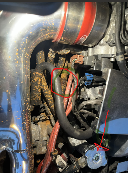

  • I have a coolant leak coming from a pinhole in a rubber pipe near the inlet/idle speed control valve. It’s the bigger pipe that connects to what I think is a coolant reservoir entrance (labelled below). Does anyone know where I can get a spare pipe like this? Or I’ve heard that you can use some sort of plastic amalgamation tape to fix it but not sure if they’re any good?

As for your questions. The water hose that has a hole is just a standard piece of high pressure water pipe and you should be able to buy this from ebay or a local autoparts store.

Thanks for your response, I’ll look into GTO UK and try to find a replacement pipe. As for the other bits, I thought I had written that it was the slave cylinder - I’ll edit that in now. I’ll try again to see about the oil leak, but I was partly hoping to learn if there are any known failure areas/pressure points then I could focus my search a little.

You mentioned a great shop on here - is that just the ‘items for sale/items wanted’ sections here? And Joe mentioned buying my coolant hose off ebay or an autoparts store but I’m not sure what to actually type into eBay/how to describe it to a store. Do you have ideas? It might be worth taking the pipe off and bringing it to shops so they can assess the size and material?
