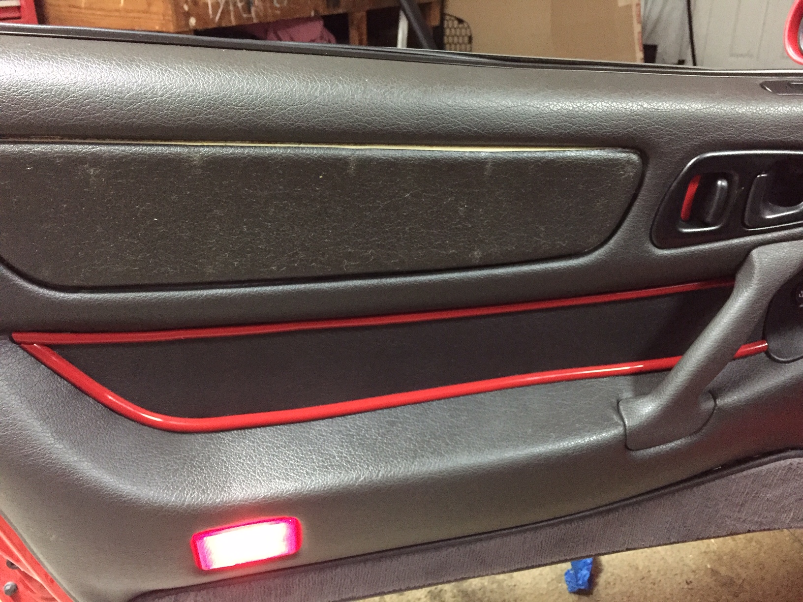

Have not dealt with the rear quarter yet. Have tried removing and gluing with multiple varieties but nothing has worked. currently my best solution at least for the doors was stapling at the crease of the arm rest and then covering with red 7/16" moulding. Have uploaded some pics. I believe with a little more practice this can be a viable option not for the doors but also the quarters… I can go in more details if anyone is interested.

I have taken these panels to multiple auto interior shops. All give the same answer, not repairable. appears that the vinyl was vacuum pressed and glued onto the panel using industrial/manufacturing machines. I found at one time a Calif shop that look like they did this but i didn’t make note of the you tube video and can not re-locate. I would have loved to avoid the method I used, but short of a MNO (money no object) restoration, I figure it would have to do. sometimes you just can’t get back to OEM.

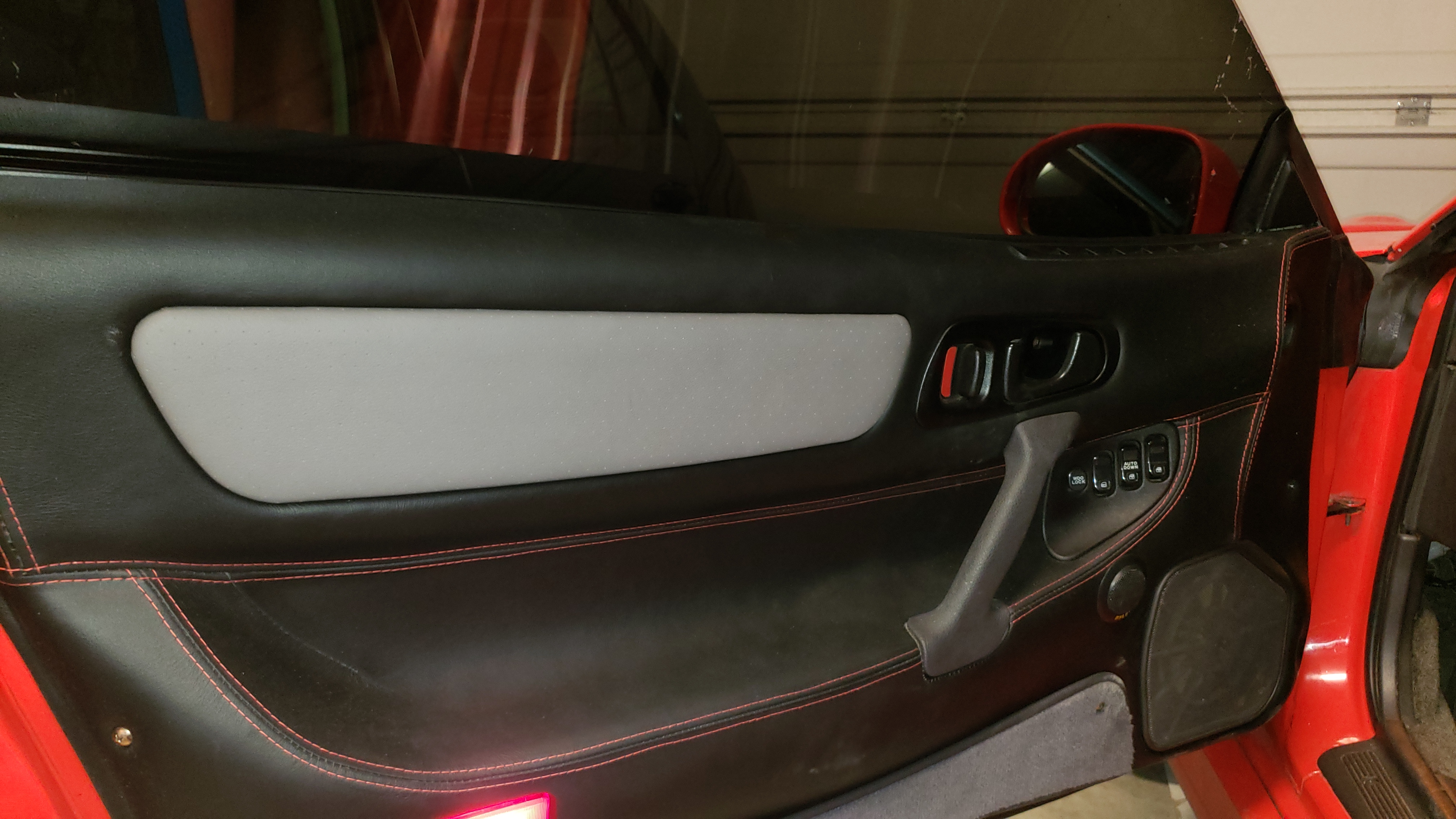

I took my door panels with the same issue too an auto upholstery who stitched in sobre leather. Very nice job.
