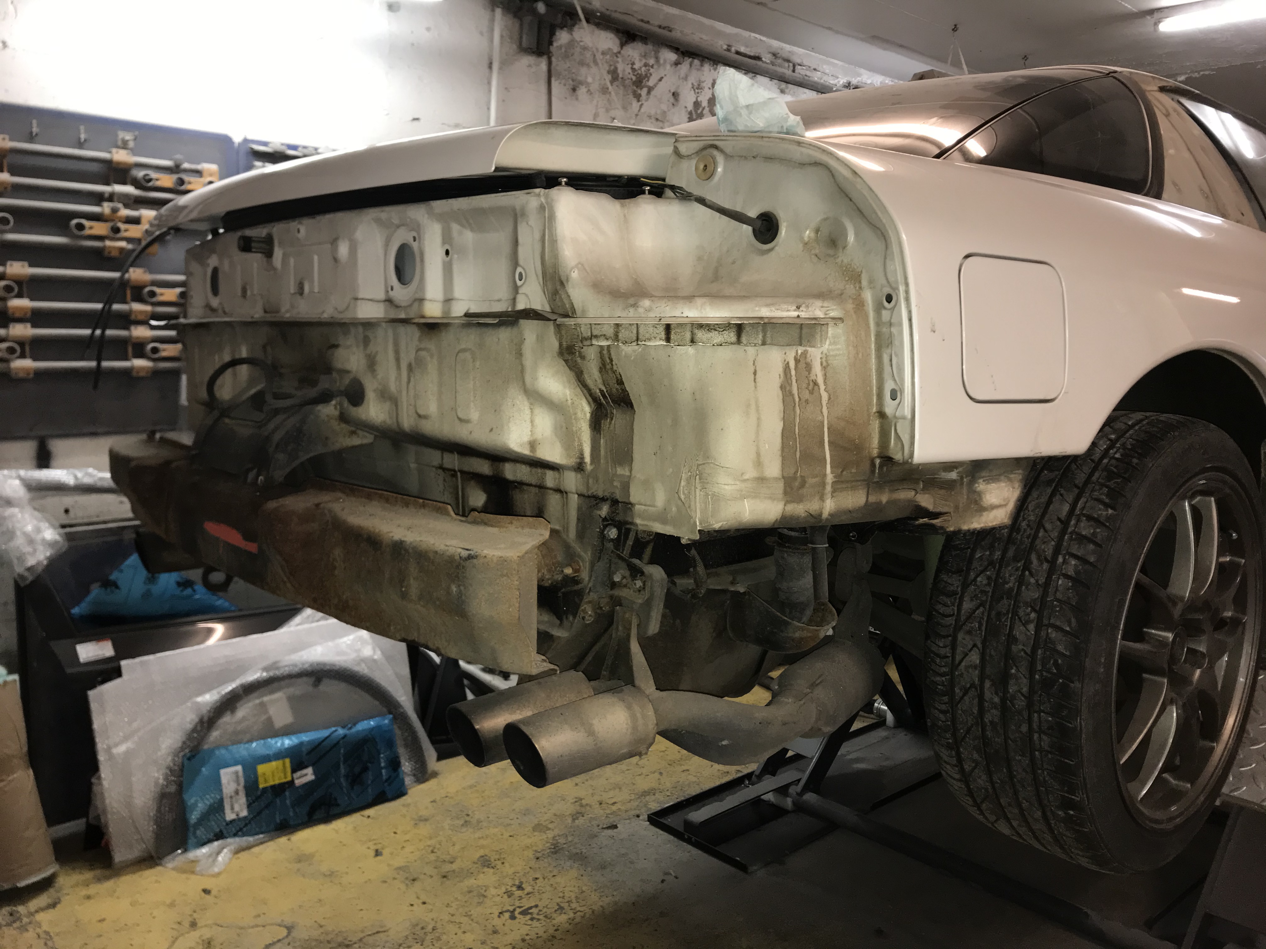

I had a brilliant day today doing the last dismantle of the car before they start sanding and doing their job, so I thought I would take some pictures because I am amazed of how little rust there actually is on the car considering it is 30 years old.. And as the icing on the cake is the fact that I got my front aero working again today by cleaning the motor and the rod that makes it go up and down, so I am a truly happy camper today.
This is the only rust area I have which came from a little dent I got when somebody decided they wanted to kiss the side of my GTO
It is very good
