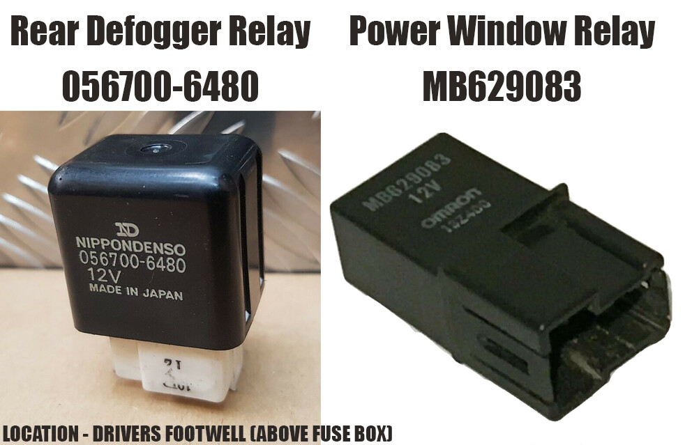

Could you post pictures or just the referance numbers of the relays here just incase somebody else needs those and cannot find the numbers they are labelled :slightly_smiling_face:
no problem, attached is an image with the part numbers. I haven’t got the MB number for the Defogger relay but the guy at Mitsu found the part from the Denso number.
