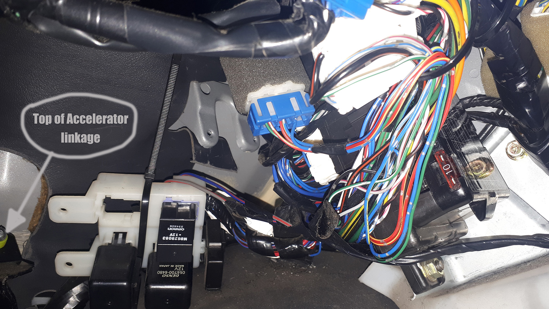

Hello, I know I am being really stupid here but I have looked again and again for the Etacs Unit but just can’t find it. I have looked around the accelerator area and the whole footwell with no joy.
any help is much appreciated! thanks
I have found this on a US model, is it located more behind the dash? thanks
wth… You gotta take the dash apart to get to that box?? :man_facepalming:
Found it now - I just got confused as the the Part number is mb629051 - and when i googled it was showing as another unit but that was incorrect. Thanks for the help

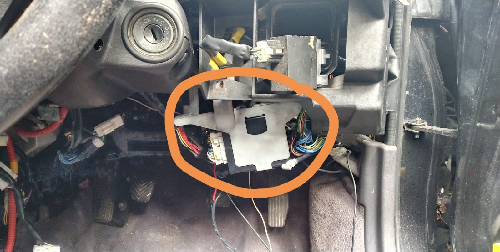

I am glad you have found yours as I have been looking on my car since you first posted but it still eludes me, any chance you could circle it on the photo you posted of the footwell.
Best Regards
Marc
No problem, I will get one in the morning for you when it’s light. It looks like 2 screws to get it out and 2 plugs to take out. It’s more behind he lower dash, under the steering wheel on the right hand side, black plastic about 5 inches in length.
Still havnt got around to do the halos yet but hopefully soon!
Hi, just tried to take a photo but its very hard to get one as its a very tight squeeze. When I remove it (I have ordered a 2nd hand one just to try first) I will get a better photo. It is basically right behind this area circled.
Thanks Lee I will try and locate it, did the part number you quoted turn out to be the correct part you required
