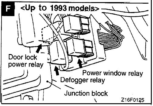

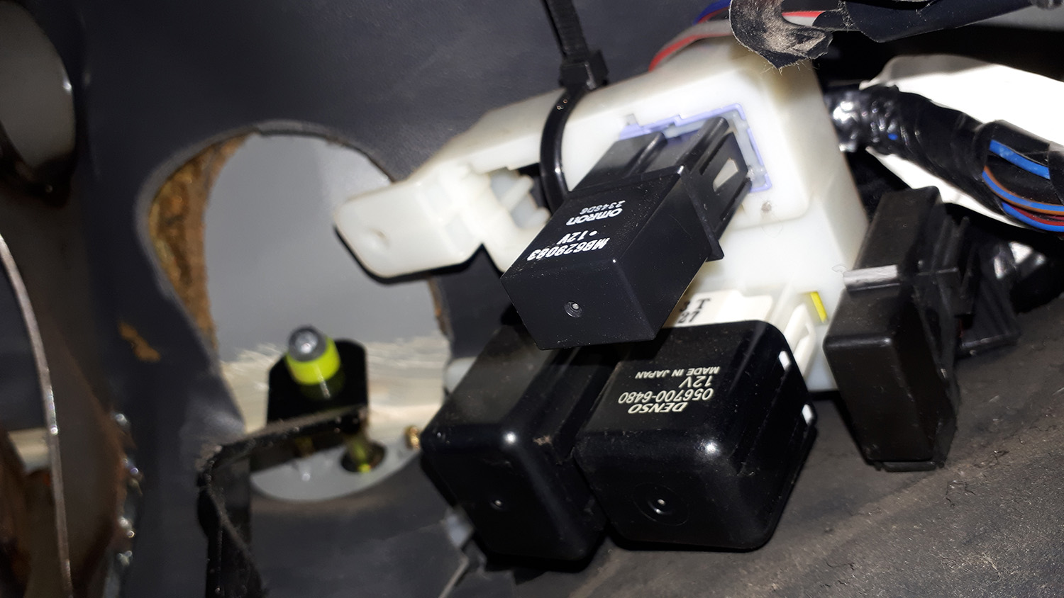

Here it is.. You cannot miss it from seeing this picture, and it is a proper nightmare to get out of there.. You will need a small hook tool as the relay lock pins are really hard to get to and you cannot yank it out…
But I doubt your troubles come from there, as they just sound much more severe then mine, but who knows.. Cant harm anything out by atleast diagnosing that it aint from this relay that something goes wrong.

Those relays sit in that box/flat thingy which has wires running into the etacs … It is possible that somebody has kicked/yanked it sometimes in the past and the wires have gotten some damage… Look around the relays and check things around there, as you can see alot of things connected to etacs sit there.

So I went to look more into this today and I can’t get them to work once again…I checked all the wires and looks like the door locks have been re wired in the past (possibly due to having a toad alarm fitted). This works fine and is on the same relay box as the Defogger and power windows. so Im guessing all the wires going to the relay box should be fine? The only thing I need to do is check the connections of the actual 2 relays for the defogger and window. I can’t think of it being anything else now? Everything looks really clean and connected fine. cheers

Feel like this post is dragging on so apologies! I have just removed the defogger relay and the power window relay - visually they look fine and I cleaned and polished the ends. The only relay left on the unit is the door locks - which have always and still do work fine. When I put the 2 relays back - still the same. The Defogger Relay clicks when I press the button but I can’t hear a relay click when I press the window and sunroof button. All wires are solidly connected - I am at a loss now why it come back to life the other day (even the power mirrors worked!) and now it doesn’t again…
