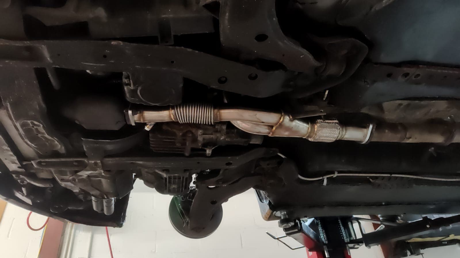

I can confirm that it fits :slight_smile: didn’t need fabrication! for reference, mine is a 1997, UK model 3000GT
There are some plug holes, what goes in there??? Or what are they even for??
hi mate what part are you talking about? I’m a bit confused, where are the plug holes?
At the front, there is a sidebranch sticking out to the right and it looks like a plug is on it or something
