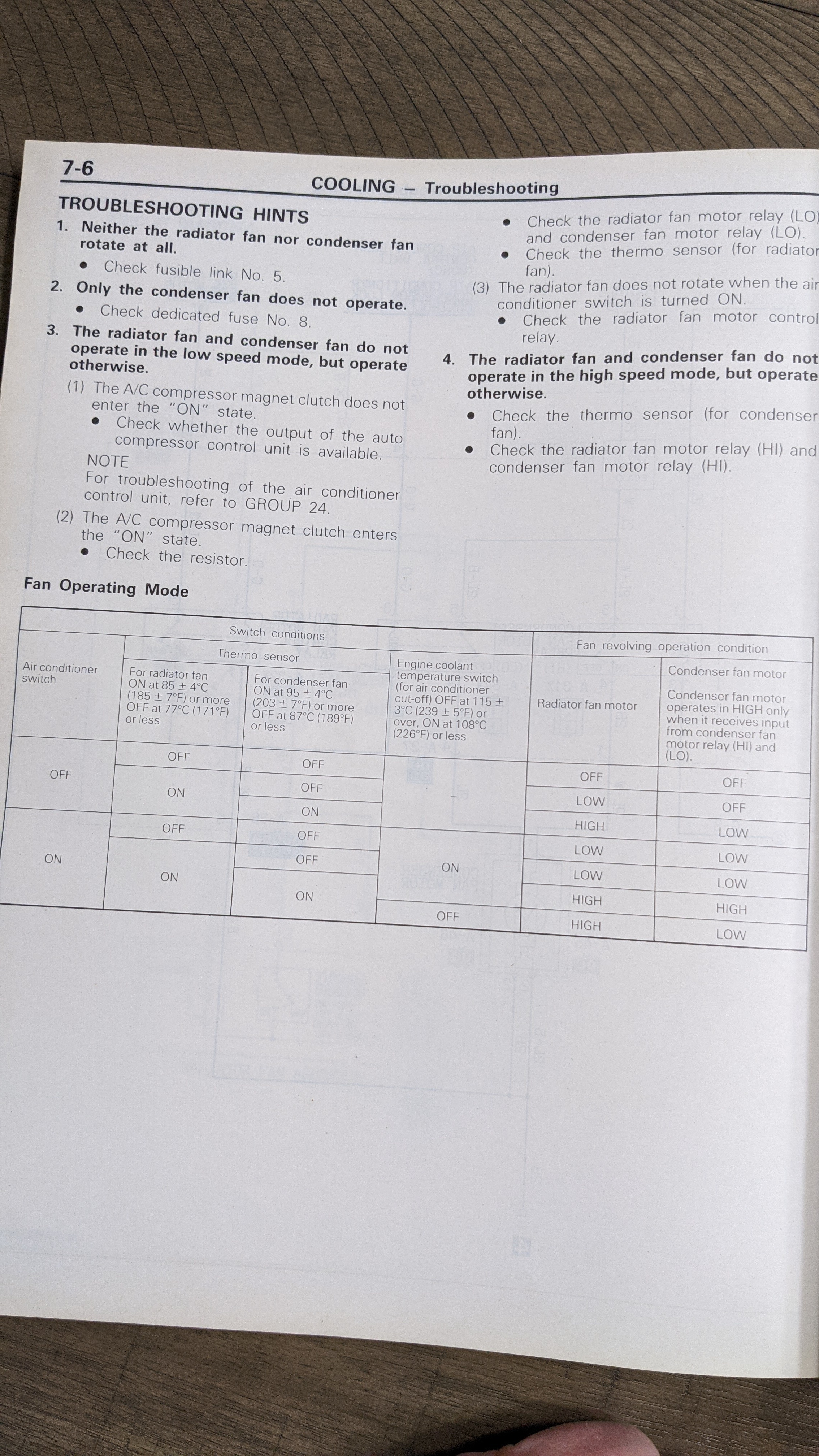

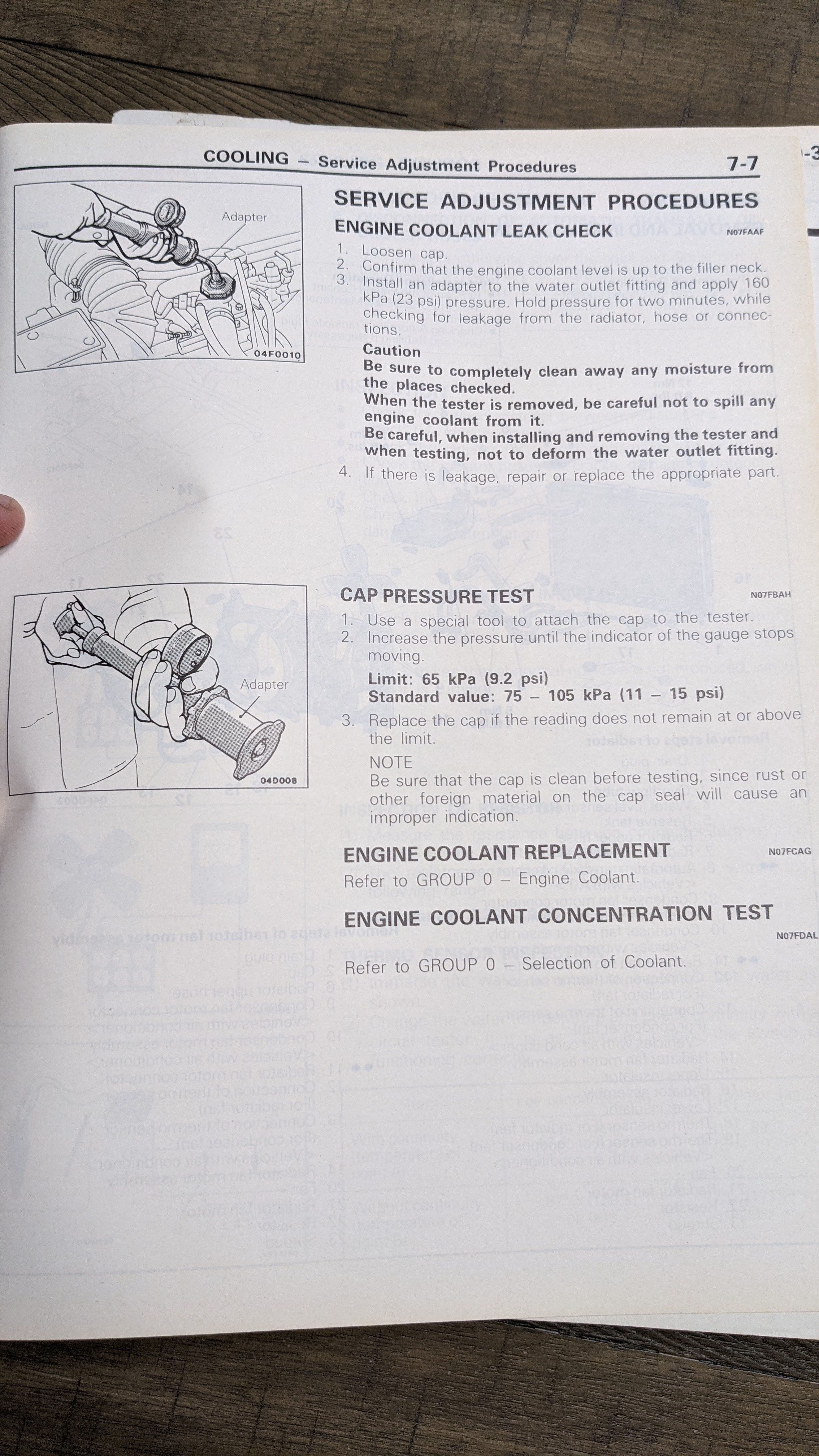

I’ve attached the pages for the cooling system from my service book.
Thanks buddy, that’s very kind of you. It’s all sorted now!
