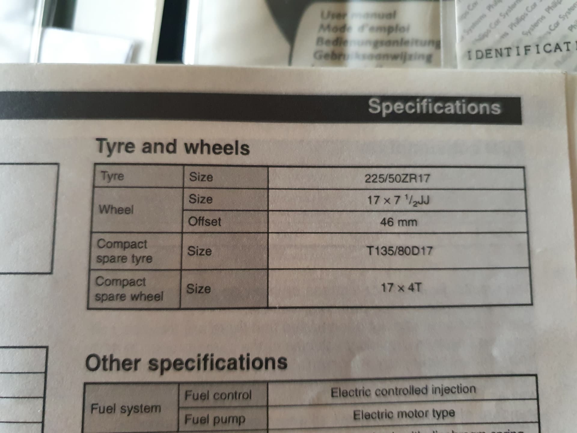

Here’s the standard wheel size according to my owner’s manual:
To keep your speedo reading right u will need 245/35, hope that helps.
