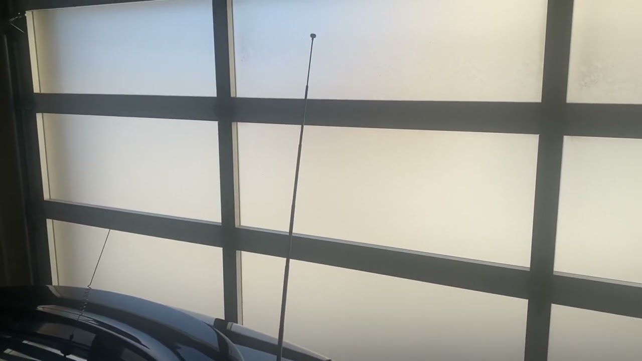

It has the following issue: I replaced the power antenna mast. Antenna fully extends but grinds gears for about 10 seconds after fully extended.
No issues with antenna going down.
Why won’t the motor shut off?

Mine has a new antenna mast so not sure why it’s still grinding
You could always just remove those rear trunk panels and take the whole assembly out. Open everything up.
Already did that. I removed all the broken pieces of the old mast.
It still doesn’t know to stop grinding after antenna is fully extended
When you replaced the antenna, did you remove all the old broken bits of the plastic track from the motor? Only other thing I can think of is a broken switch in the motor.
Yes. I opened the motor and removed the broken pieces.
Is there a switch that tells the motor to stop after the antenna is fully extended?

Buenos días Fernando, compré e instalé un nuevo mástil. El mástil se extiende completamente pero el motor no se apaga. ¿Por qué el motor sigue rectificando los engranajes después de que el mástil está completamente extendido?

Desmonté el motor y quité los dientes rotos. No vi nada más malo con el motor. No estoy seguro de lo que se supone que debe hacer que el motor se detenga después de que la antena esté completamente extendida.
I wonder if it is a bad antenna relay that is preventing the motor from stopping
Anyone have a relay (Part# MB6279590) I can try?
