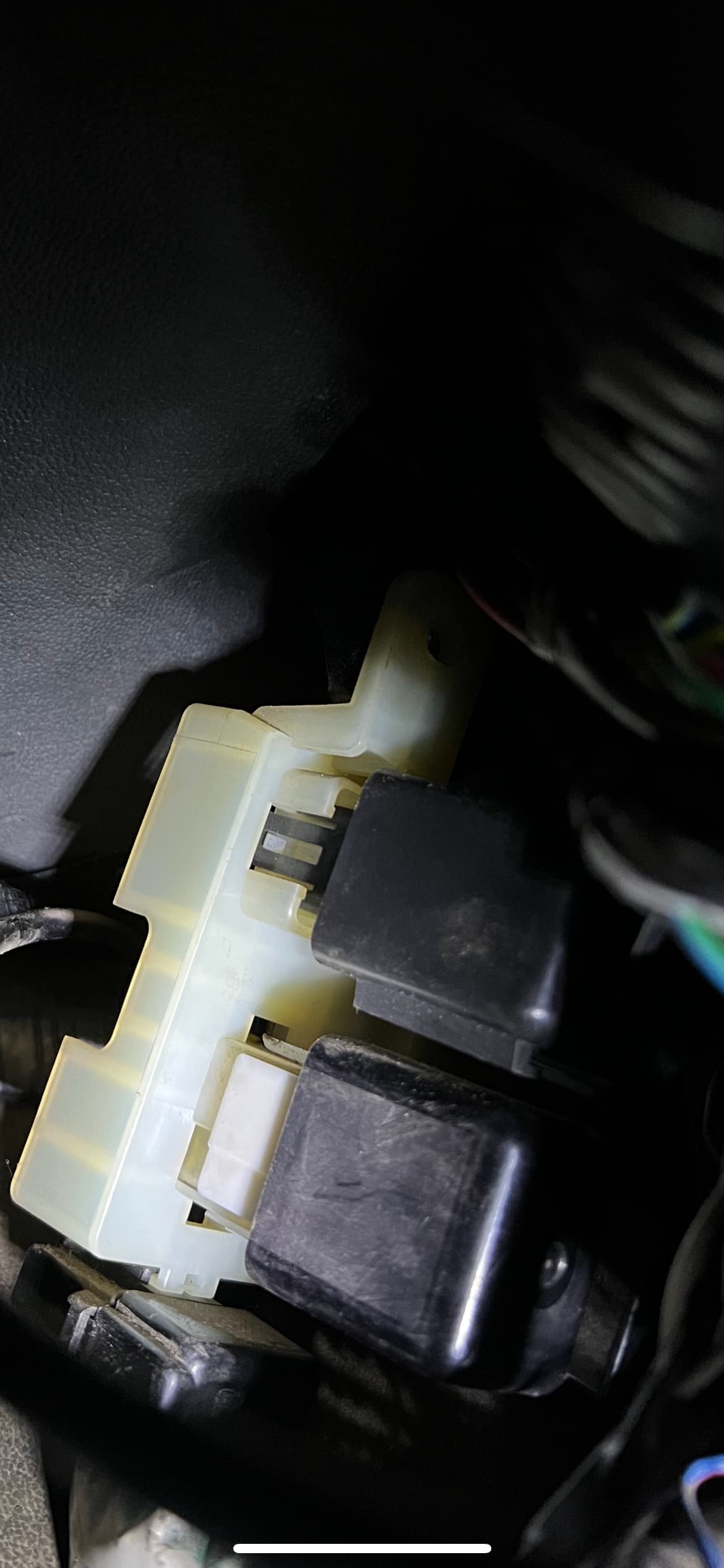

Hi All
Can anyone tell me what this relay bank control ?
It’s in the drivers foot well behind the main fuse box
Many thanks
Darren
