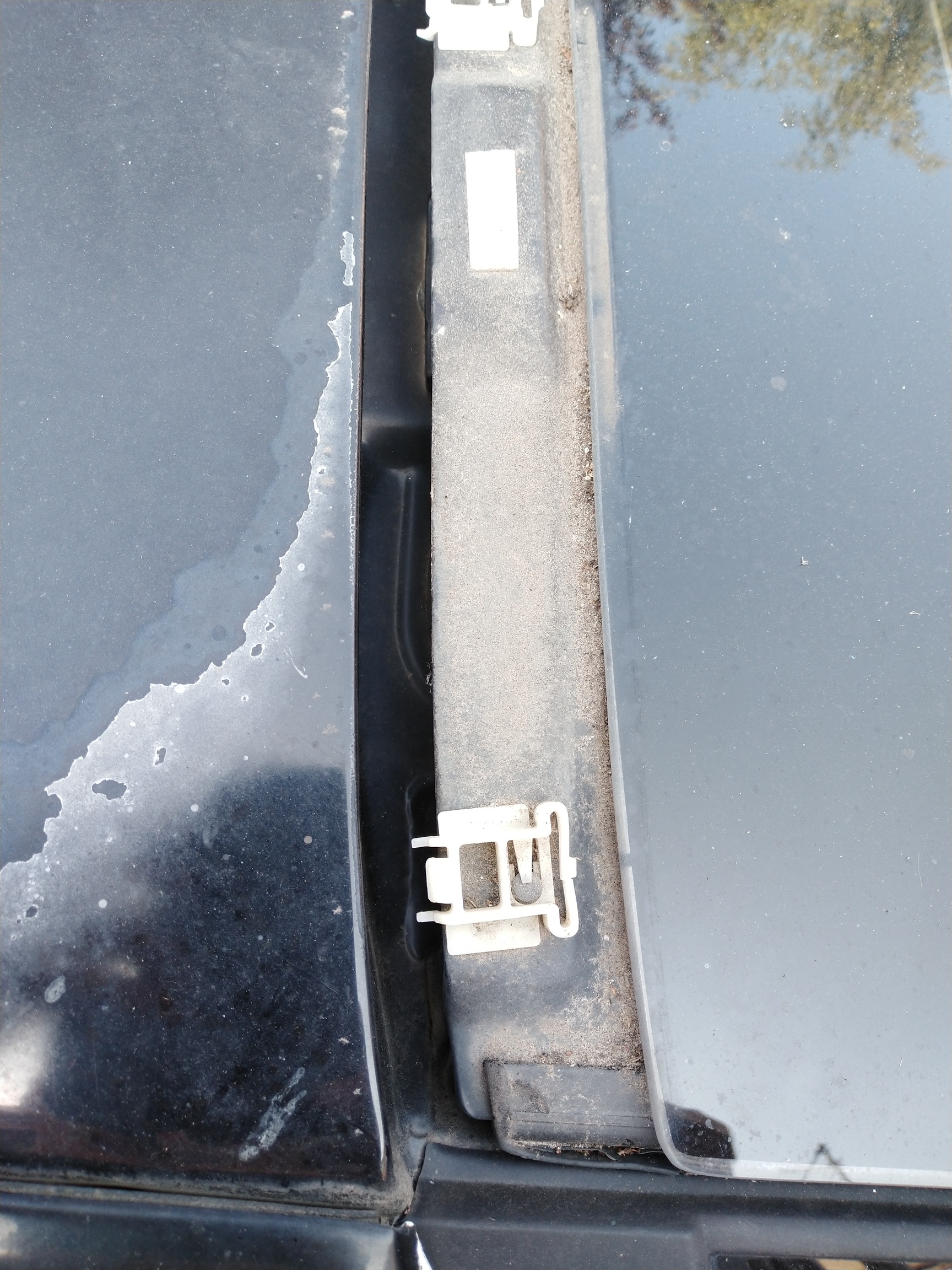

This is what it looks like behind the strip. As you can see, there is nowhere for the water to get through unless the glass has become un bonded.
Thanks for that picture, I think I might sit in the boot and get the Mrs to hose the back and see if I can see any possible breaches that might indicate the window bonding before I attempt those clips as you say. Appreciate the help tho mate.
