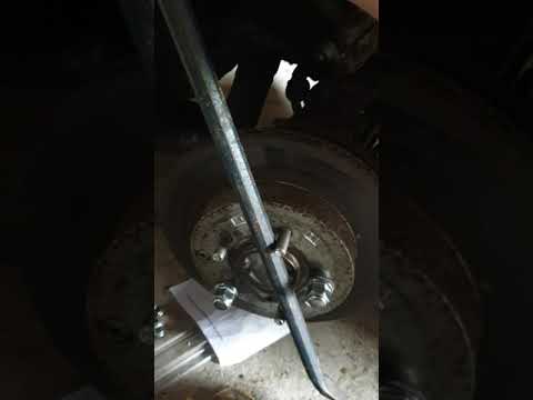

The handbrake now bites hard after about 6-7 clicks, but the original problem still remains, i’ve made a (bad) video to show exactly what’s happening.
The wheel shown is the drivers side.
I’m not even sure if this is normal behaviour but the car did fail its MOT because of this, the tester said there shouldn’t be any movement whatsoever.

This is how they’re set up now:
I notice it springs back after releasing the bar so it suggests the springs are involved or the locator “Knobs” that the shoe ends sit against might be worn.If I recall there is a bit of play on my handbrake in one direction but it passed the MOT. looking at your last pic … the shoe ends might be sliding up and down on the “knob” but they should only be pivoting at that point and not sliding … if that makes sense ? . The springs won’t be able to stop this. I think if you can somehow take up the slack by beefing up the “knob” there will be alot less excess play … ooh err missus
Hmm, are they supposed to pivot at the top? if I pull the brake with the drum off, the ends of both shoes come apart from the top locator and seem to use the bottom adjuster as the pivot.
Thanks btw you can probably tell how little I know :sweat_smile: I hope it’s not the top bit thats broke as it looks to be part of the backing plate which seems impossible to find for sale.
My memory is fading. Yep pivots at the bottom and expands at the top. I’m wondering if there is any movement up or down at those points.
