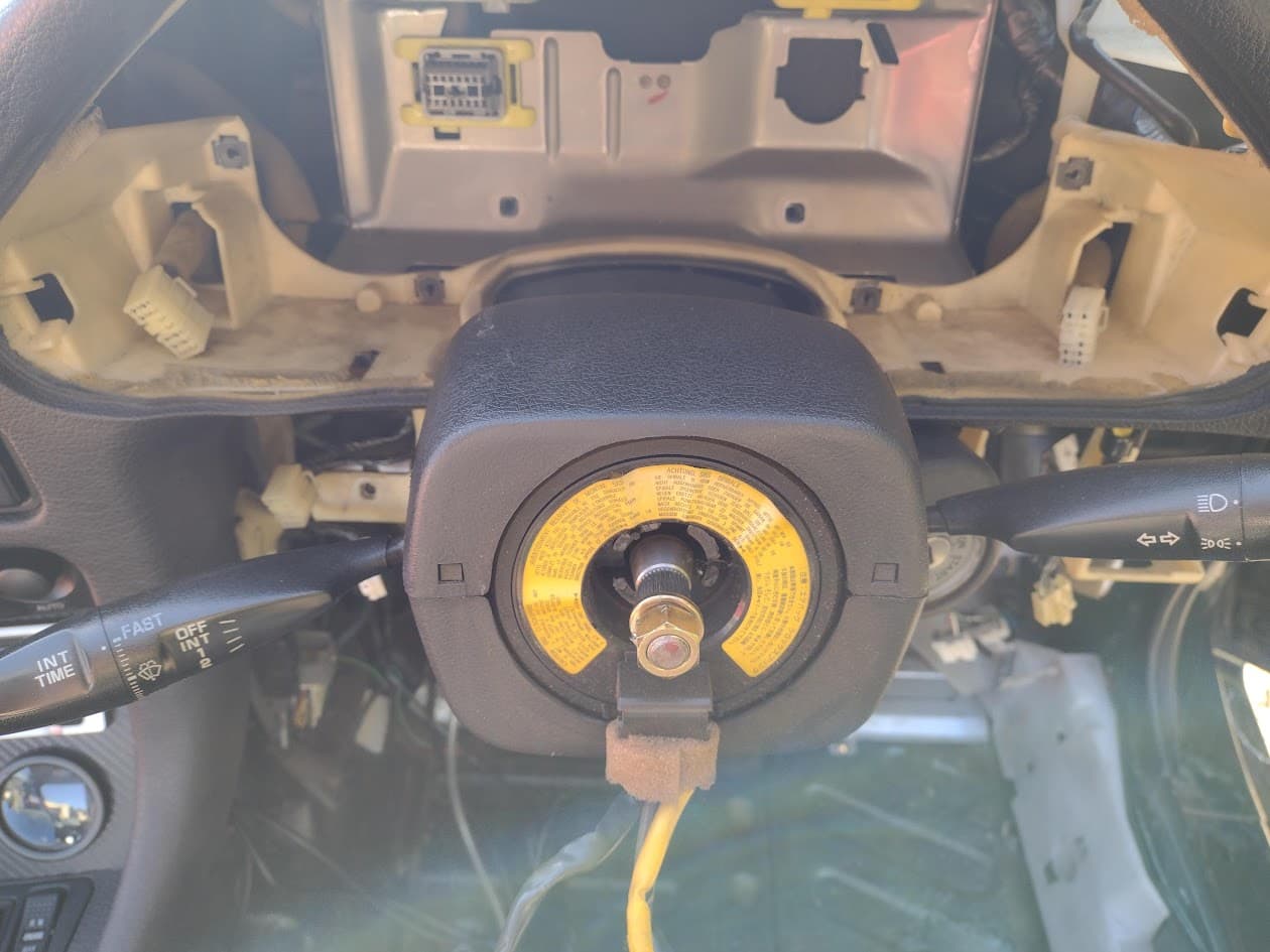

You will need to find the correct clockspring design for your car, so first you will need to disconnect the battery, leave a few minutes, remove the steering wheel and take pictures of the clock spring unit to see what type you need.
This is a clock spring, there are I think 2 maybe 3 types.
A.
