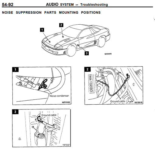

There’s this part MB543146 for a noise condenser which checks out with what Joe suggested, comes from this schema for a 90-93 GTO TT.

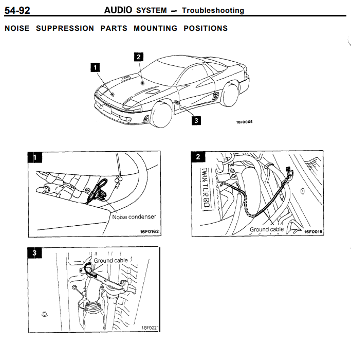

There’s also the below from the ‘volume 2’ service manual for the 1991 3000gt, section 54 page 92:
I’m no good with wiring diagrams but the manual has some for the audio system in section 54 pages 82-84. Maybe worth giving that a read to see if there’s a spec for the capacitor in there.
Hi Elliott
Thank you for the information, as you say this does seem to back up Joe’s explanation and presumably if there is no interference on the cars audio equipment then this item is working correctly.
Its a relief that this has no direct connection to the performance of the coil packs, thanks again for the information and the drawings from the manual.
