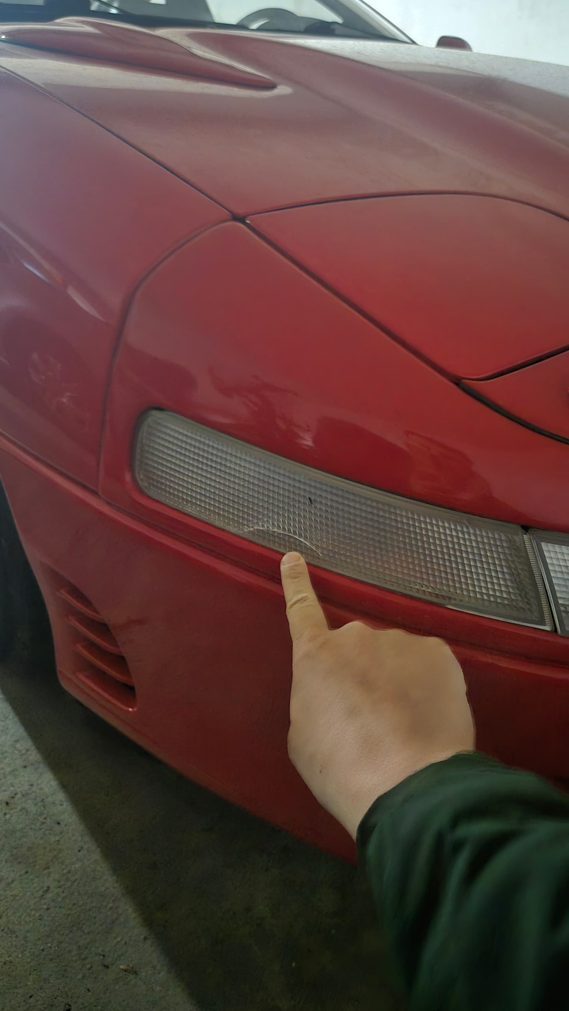

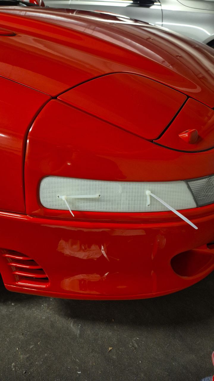

Old photo of my car where it was still there.

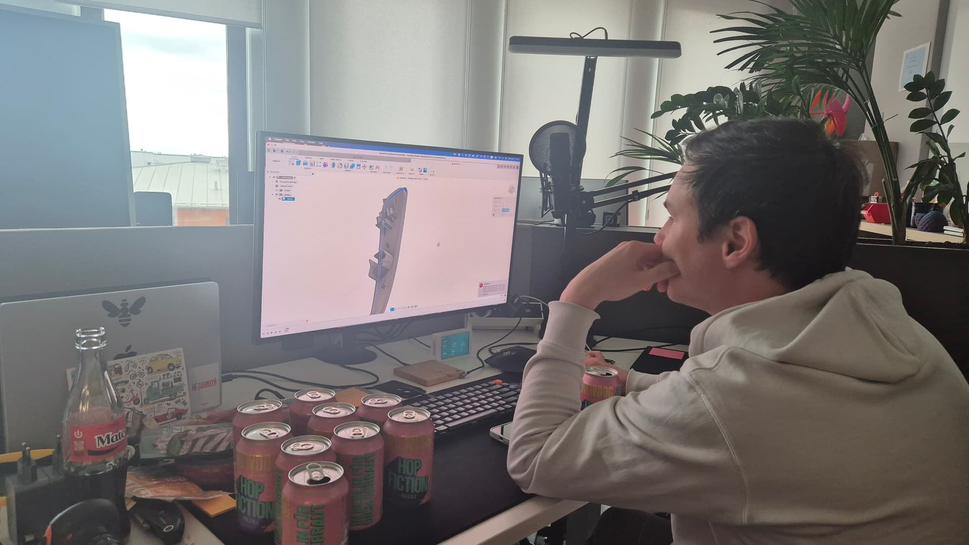

And let the reproduction journey begins! 3D scans are done. Now it’s time to split this part to inner and outer layers.

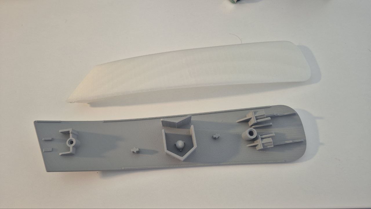

Separated lens and foundation links

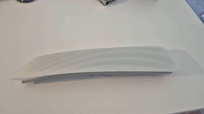

Prototype printed on simple printer:

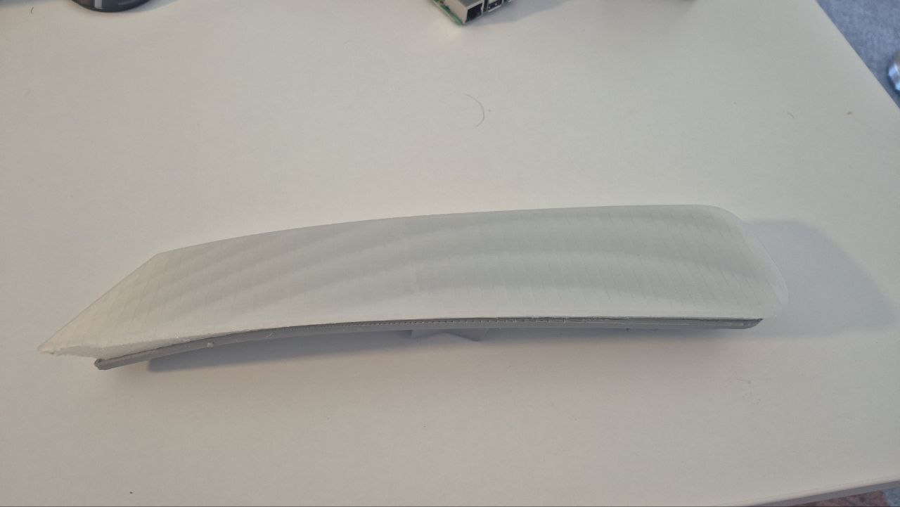

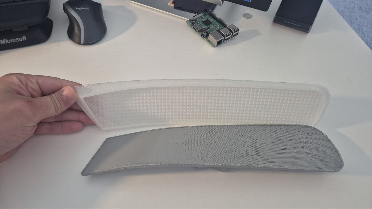

Printed from simple scan looks like that. Barbaric holders is done because i’ve lost original springs.
Printed from “splitted” scan does not fit well and needs some kind of work on.

To be honest this print doesn’t look bad. Maybe the lens material should be different to better match original functionality, but Im also looking forward with the progress on this part. 3 years ago I bought refurbished part for ~200 euros and now I can’t find anybody who sells this element - only whole front bumper
