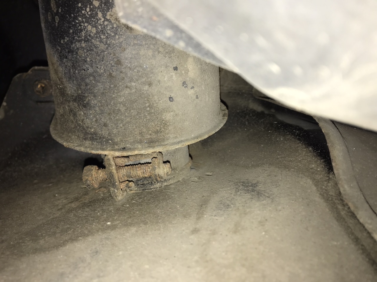

Im not sure if this helps, but I just noticed that my tank is not held up by bands, but is bolted up instead.. I took some pictures as a referance..
I also added the line that goes to the fuel filler cap as it might help you to see how it looks like

I havent seen any 3000GT or GTO fuel tank held up by straps! It’s bolted up. The tank protectors are rare to find in one piece but if caught early you can save them. Tanks are still available to order from Mitsubishi, £1k but includes a new sender unit, flexible line and the lower protector.
You are absolutely right about the straps. I was working on a different vehicle recently and got the two mixed up. Doh

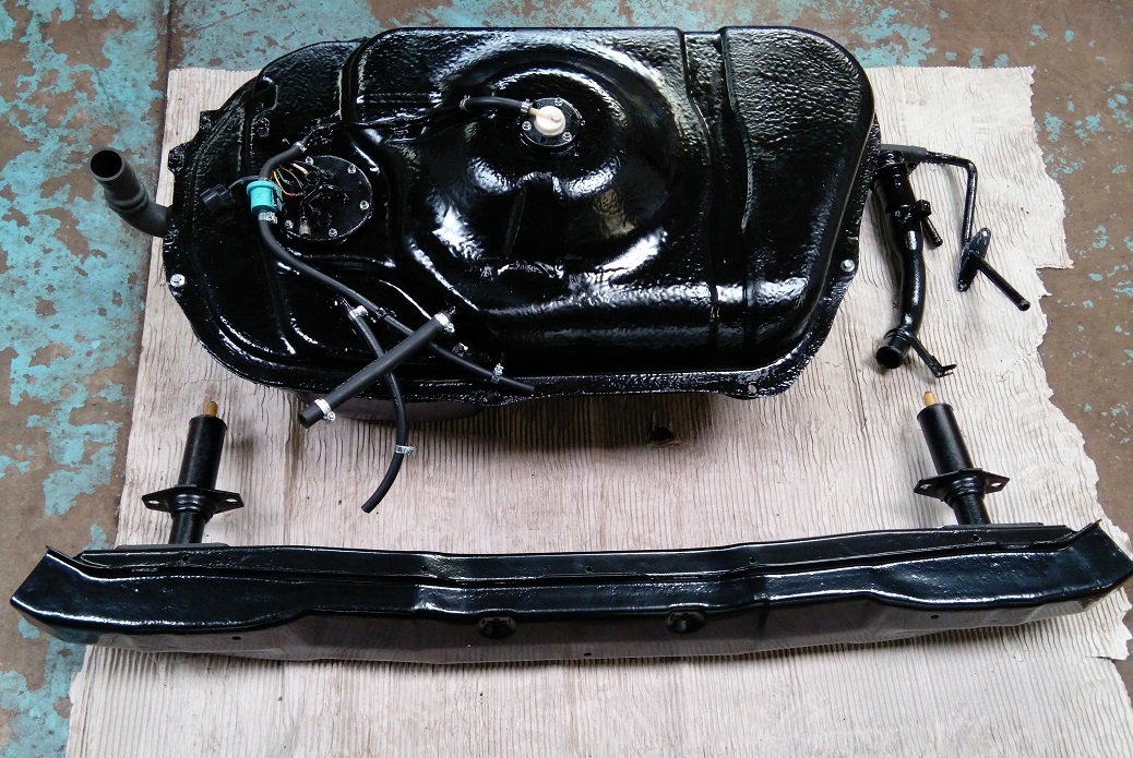

Was really pleased with the way that turned out! Complete underneath restoration seven month job fun times..
This is a nice job !
Great job ! what did you spray the tank with ? Or is that the original finish coming through ?
