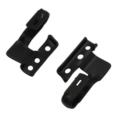

When I put my number plate into the Euro Car Parts site, they list a standard looking Bosch 19" blade (SP19) as fitting the rear wiper. However, there’s a little note under the fitment detail that says “must also use 48577504”. I tried searching the site for that reference number but nothing comes up
Evil Empire have a rear wiper blade adaptor fitting kit: GTO & 3000GT Rear Wiper Blade Adaptor Fitting Kit
So I suspect the “must also use” note on the Euro Car Parts site is something related to the interface between the wiper arm and the blade.
Hope this helps
Measure the length of the current wiper and get that then you can buy the adapter like this off eBay:
Job done
Thanks I have one on its way from Rob I would rather support 3kgt businesses than ebay!
Thanks, I went with the evilempire one.
Update my bosch ar19u arrived, doesn’t fit the arm from evilempire as the adapter doesn’t have enough space on the side by about 1mm to get it to fit.
Ordered one from ebay. Also looks like you could easily fir an ar21 on size wise too.
