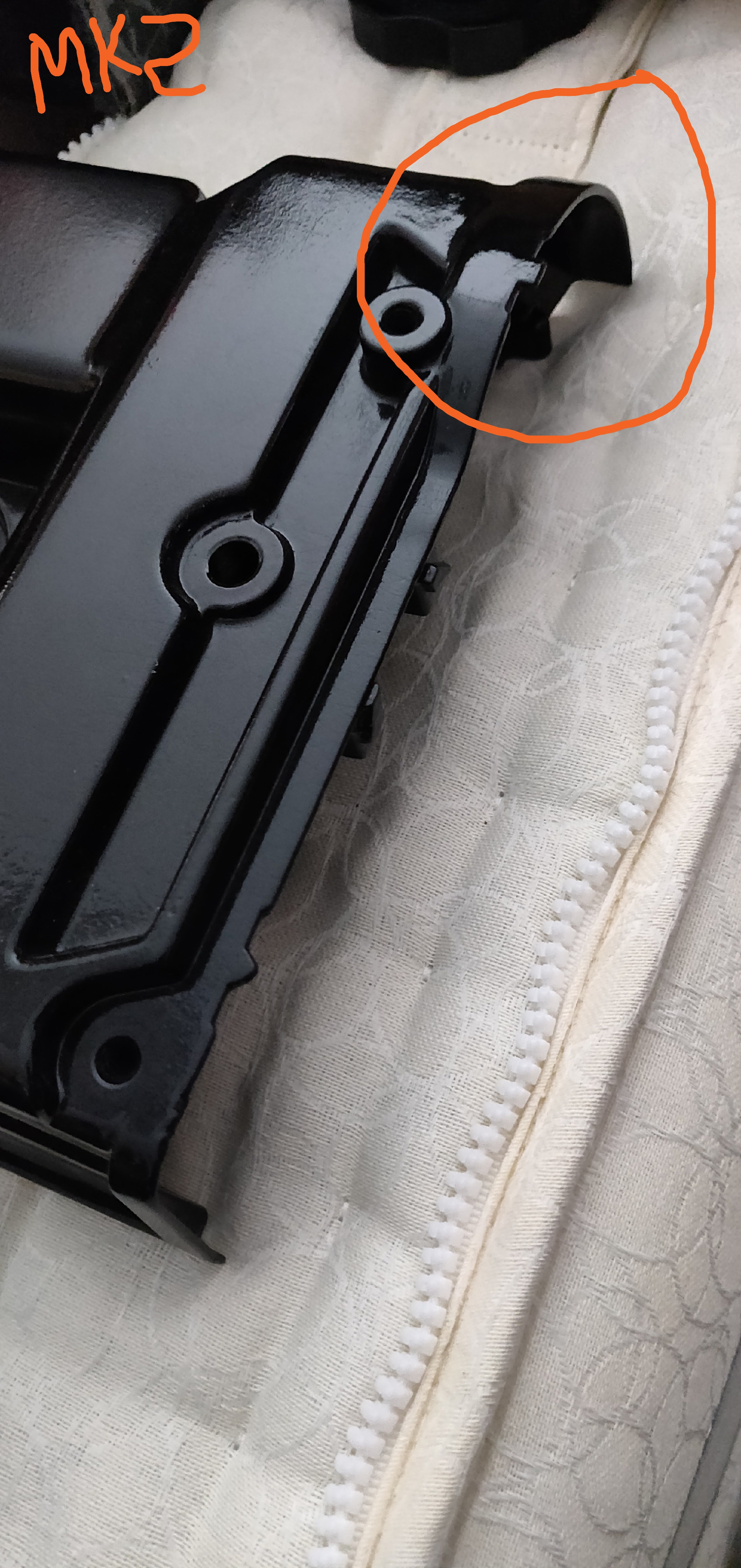

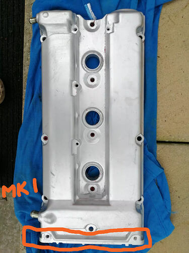

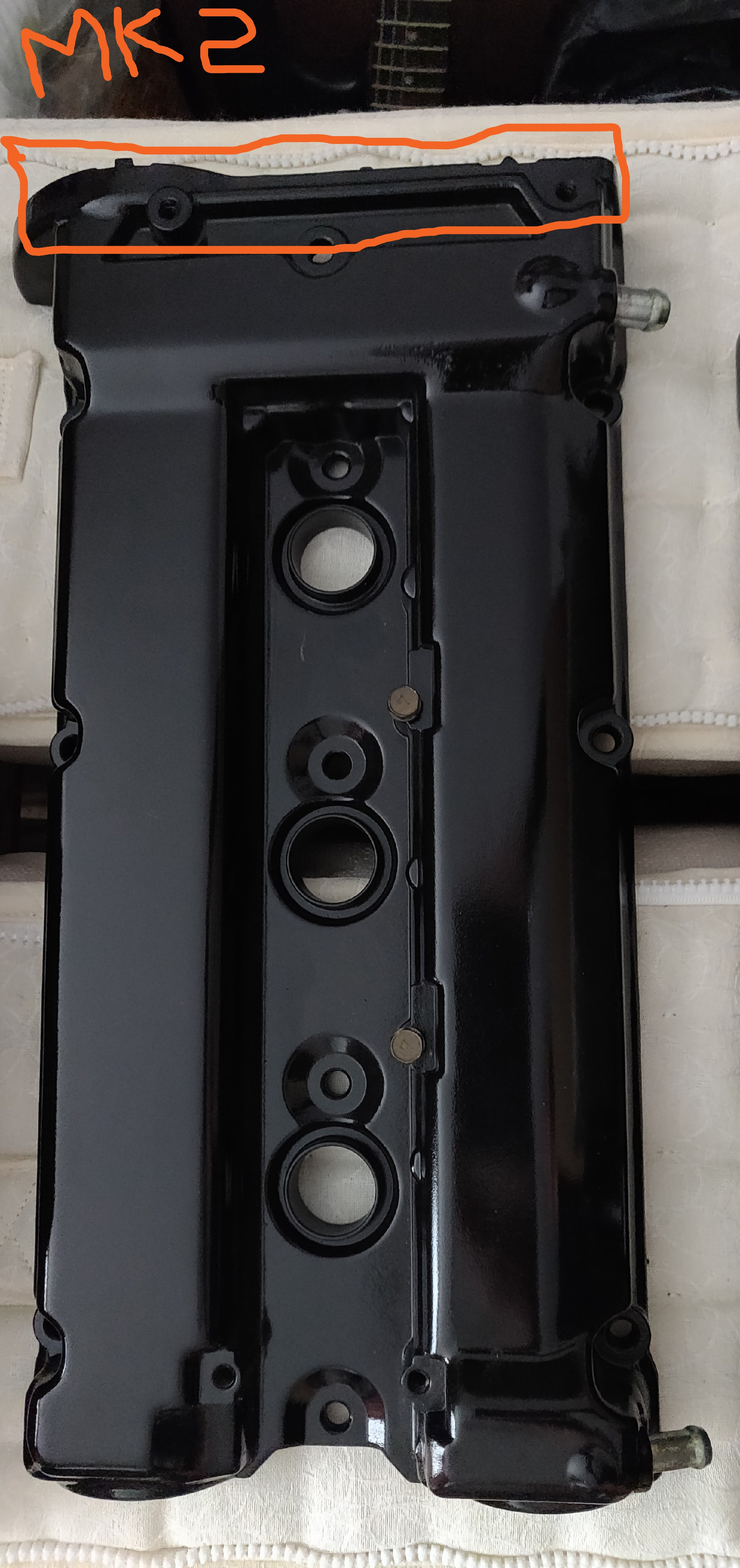

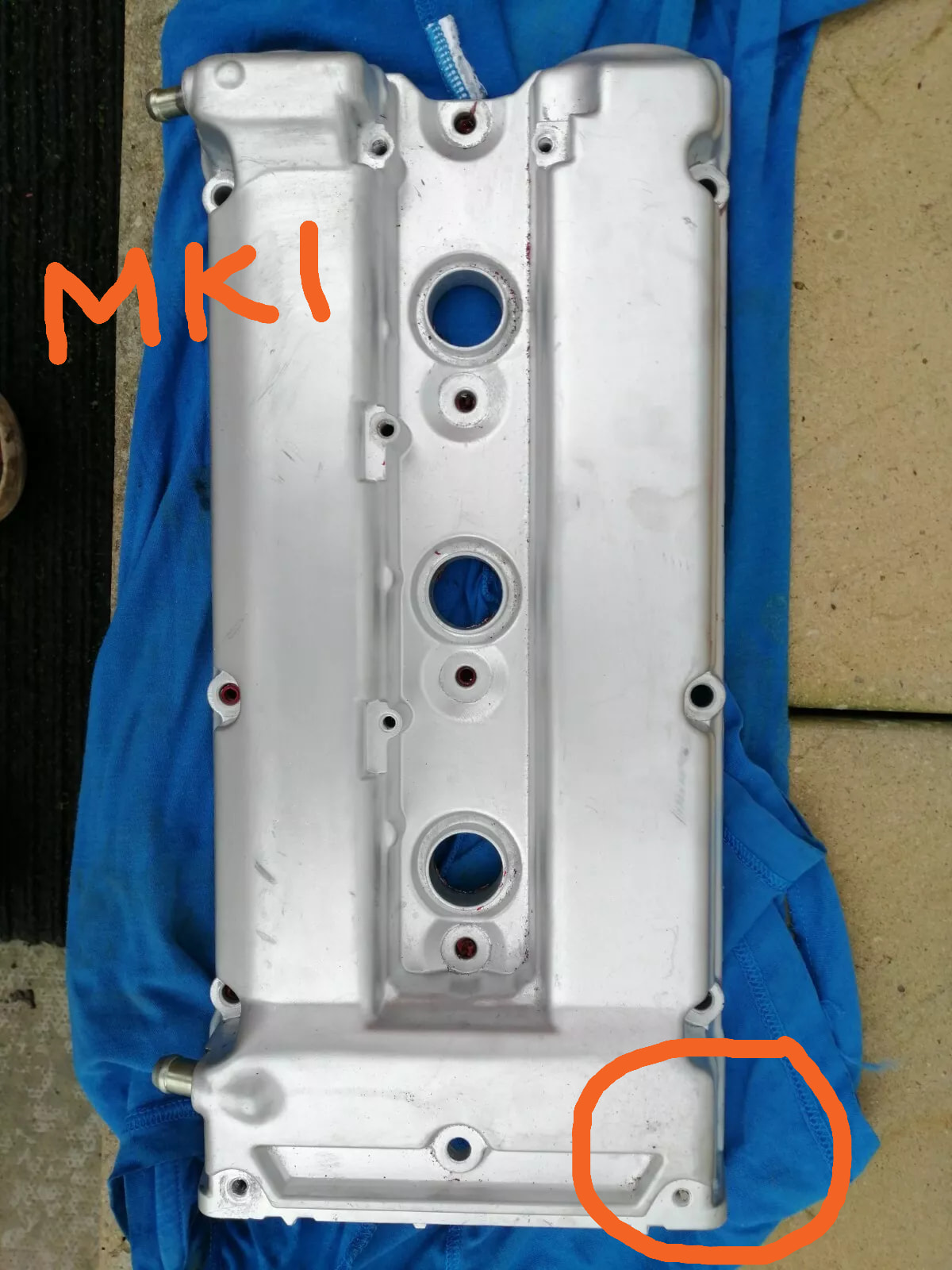

The “Not fitting” is confined to the side CAM side of the Rear rocker cover as far as I can see the MK1 Rear rocker cover has two threaded holes at the Cam belt end of the cover that are in line with each other front to back if standing in front of the car and are designed to line up with the holes in the plastic Rear Cambelt cover.
Where as the MK2 Rear rocker cover also has two threaded holes but the rear of the two holes is offset to the left again if standing in front of the car.
So my assumption is that the remark “It does not fit” refers to the fact that the end of the Rocker cover at the Cam end differs from the MK1 (Gen 1) to the MK2 (Gen2) by way of the fixings for the plastic Cam covers and the fact that the MK2 has a pronounced curved protrusion towards the back of the cover (Nearest to the bulkhead) whereas the MK1 is
Squared off
I am attaching photo’s of both types of Rear Rocker cover with the differences ringed in Orange
I am afraid that this does not answer the question “are these units interchangeable” I am assuming they are not, but it does give an Idea of the two types I have found. The part number for the MK1 (Gen1) is MD173788 and the part number for the MK2 (Gen 2) is MD186132.
