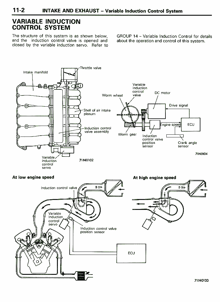

Hopefully this can help someone else! Fuel and other parameters were fine upon checking with one of BlackStealth’s scan tools.
It transpired someone had refitted the VICS motor incorrectly, it didn’t turn and the engine wasn’t getting sufficient air flow above 3k RPM. As a new owner I had no idea this was a feature on the DOHC NA cars.
I found a very helpful explanation of the system in a 3si thread here. I used the first reply by mothsmoths near the top of the thread (there are further explanations in later posts). Helpfully, the scan tool has a feature which allows you to test the VICS motor by activating it while the engine is off so you can hear if it is functioning at all!.
The volume 1 service manual covers the VICS in the ‘Fuel System’ and ‘Intake and Exhaust’ sections if you search for ‘variable induction’ or ‘induction control’ but there isn’t a full explanation from what I can see. I checked the Mitsubishi engine service manual covering the 6g72 but wasn’t able to find more info there, nor in the 1993 3000gt technical info manual. For that reason I’m not sure where the image above comes from.
