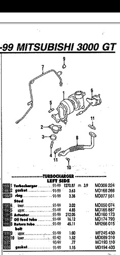

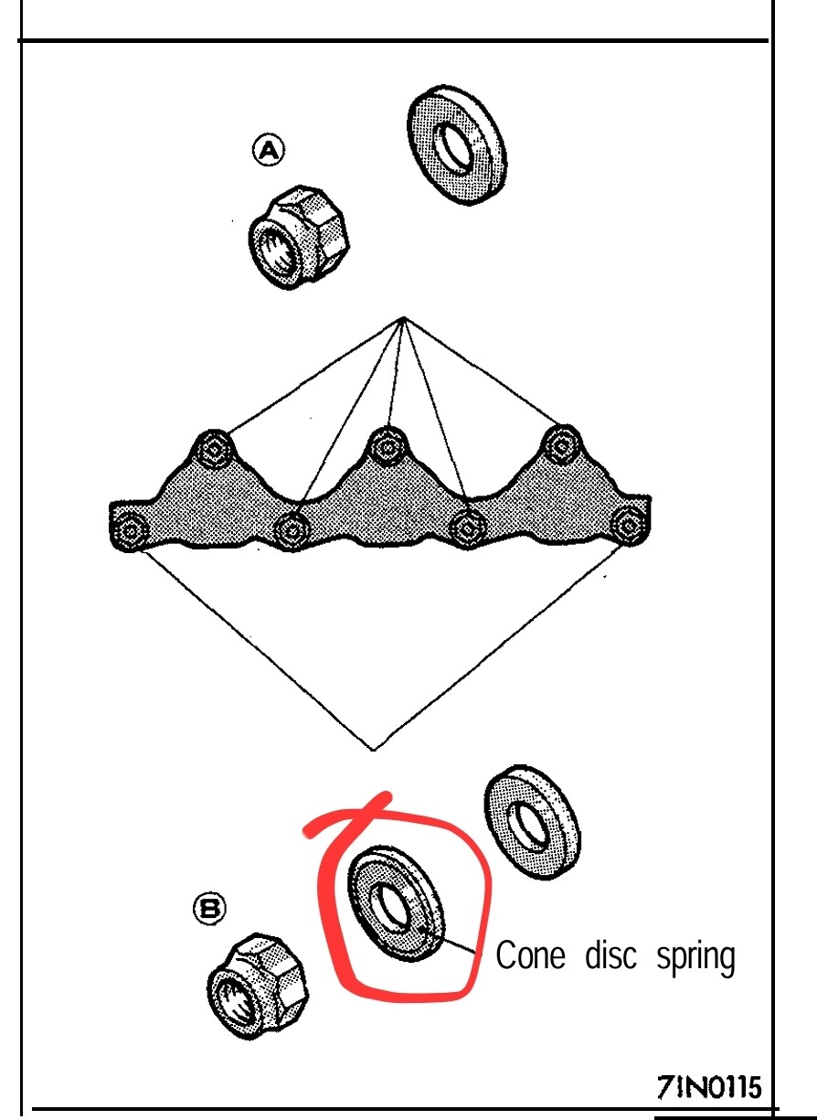

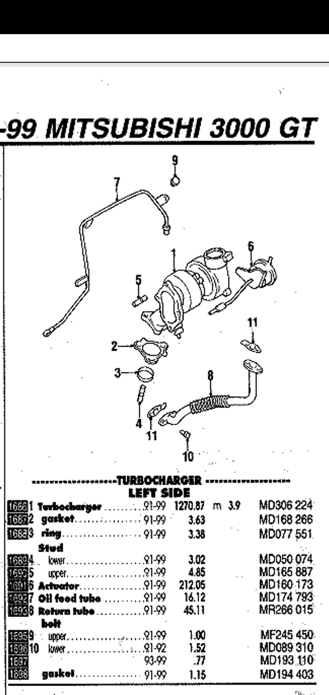

I need the pipe labelled ‘7’ and the cone spring washer for the exhaust manifold. If not available is a universal flexible hose okay to use?
I actually used stainless steel Braided lines to replace the hard lines on the turbos
I was thinking of doing the same but am stuck in choosing the right one. Do you have any suggested sites/brands you’ve used?
I got mine off Amazon, the parts were listed as
“ FZJDSD-4 AN 90 degree straight Steel Braided Turbo Oil Feed line 36” Length Hose Super sturdy scratch-resistant and wear-resistant “
and it was about $16 and then I bought
“ Evil Energy 4AN Male Flare to M10 x 1.25mm Male Metric Thread Fitting Adaper Aluminum Black 2Pcs “
for about $9 and then
“ SYKRSS 4AN Aluminum Anodize Finish Male/Female 90 Degree Flare Bulkhead Fitting Adapter AN-4 Black “
for about $10, to adapt to the threaded ends. This replaced the rear turbo oil feed line. Hope this helps.
