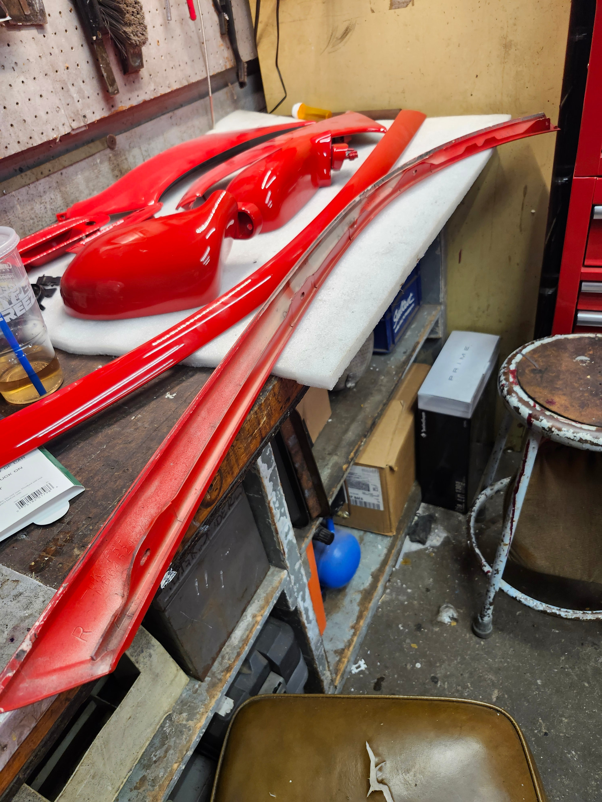

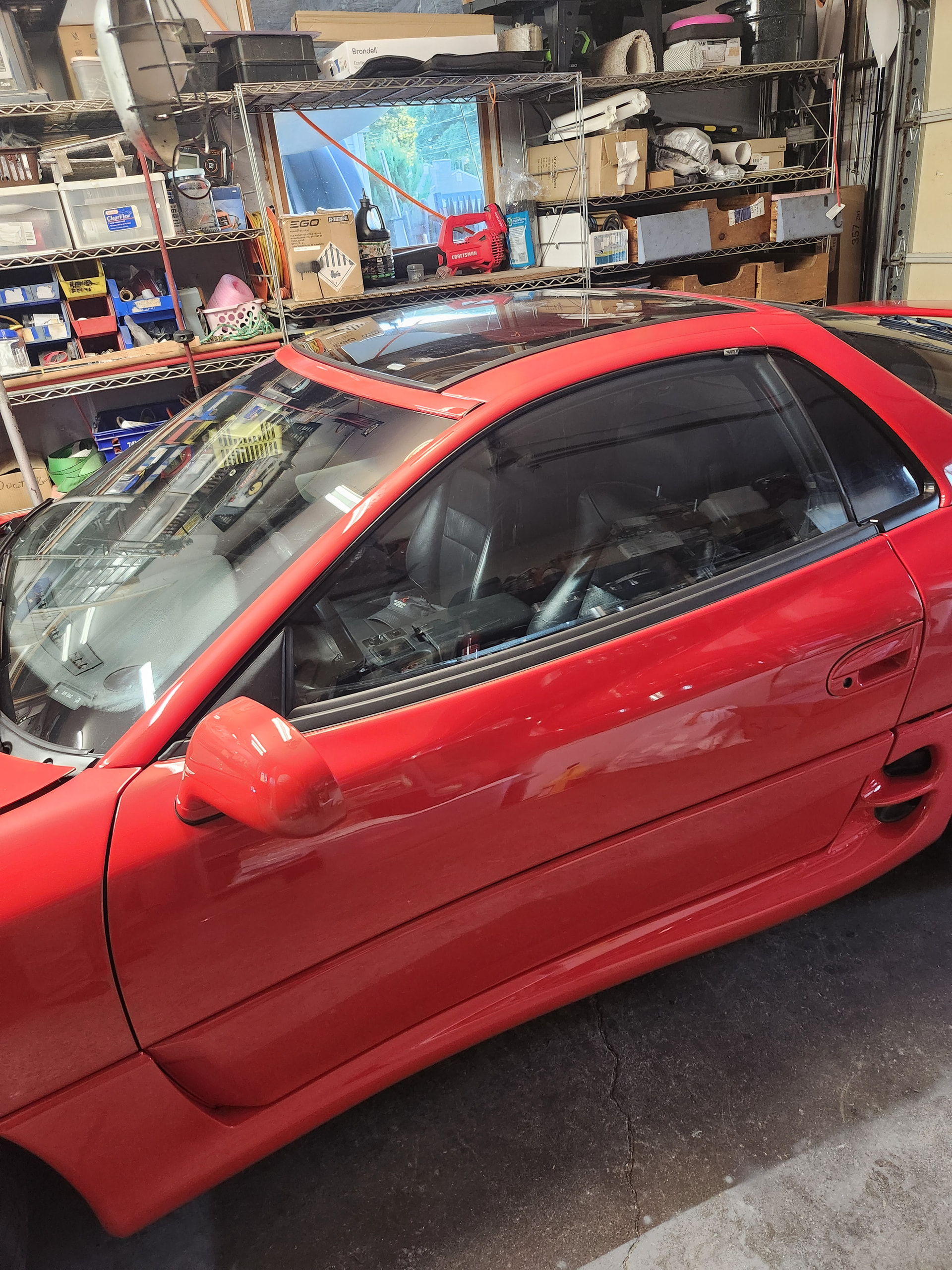

I have had the car painted and am in the process of reassembling it. All is going well but there are two questions that have come up.

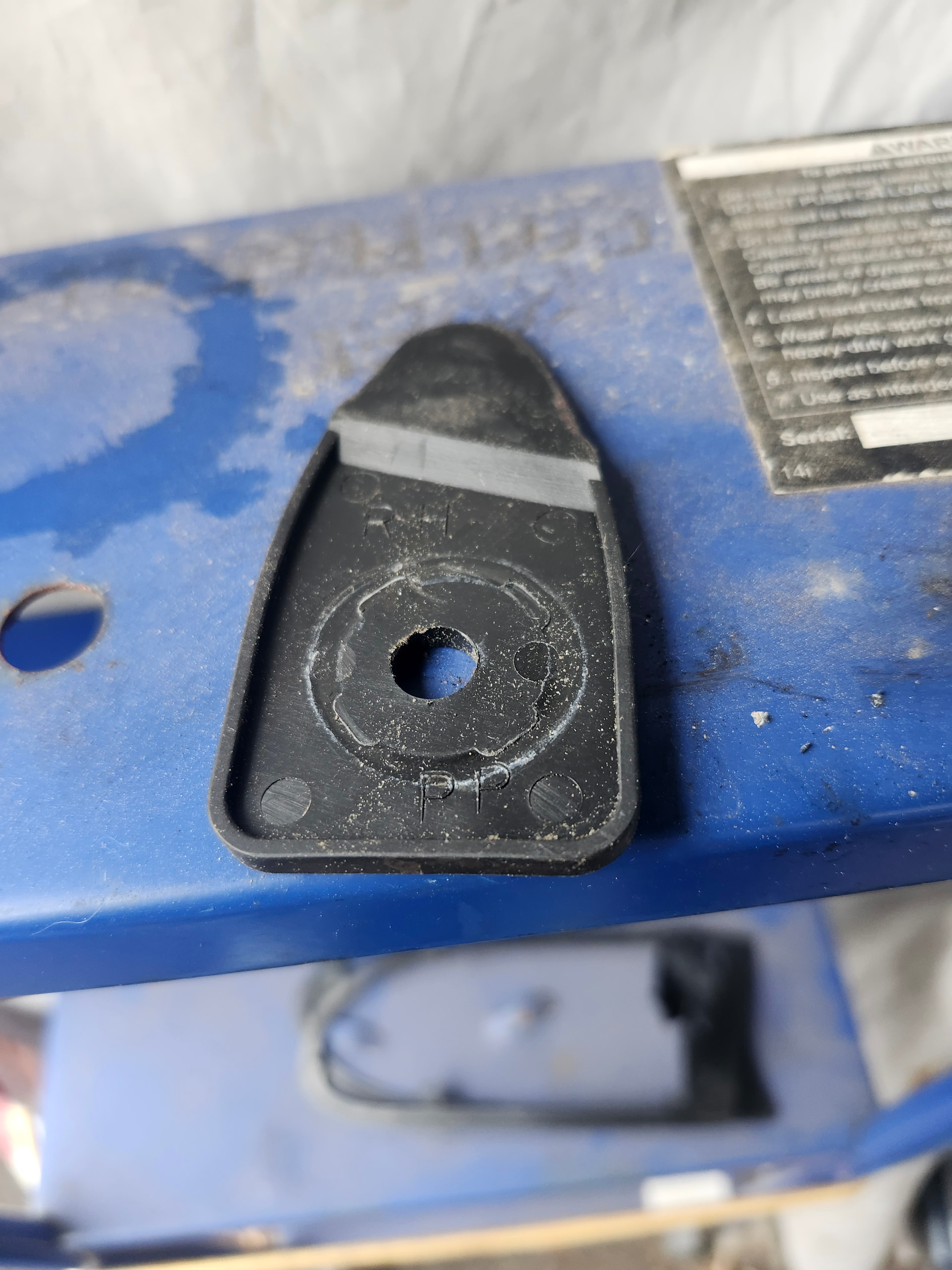

  1. What is this part (pictured)?

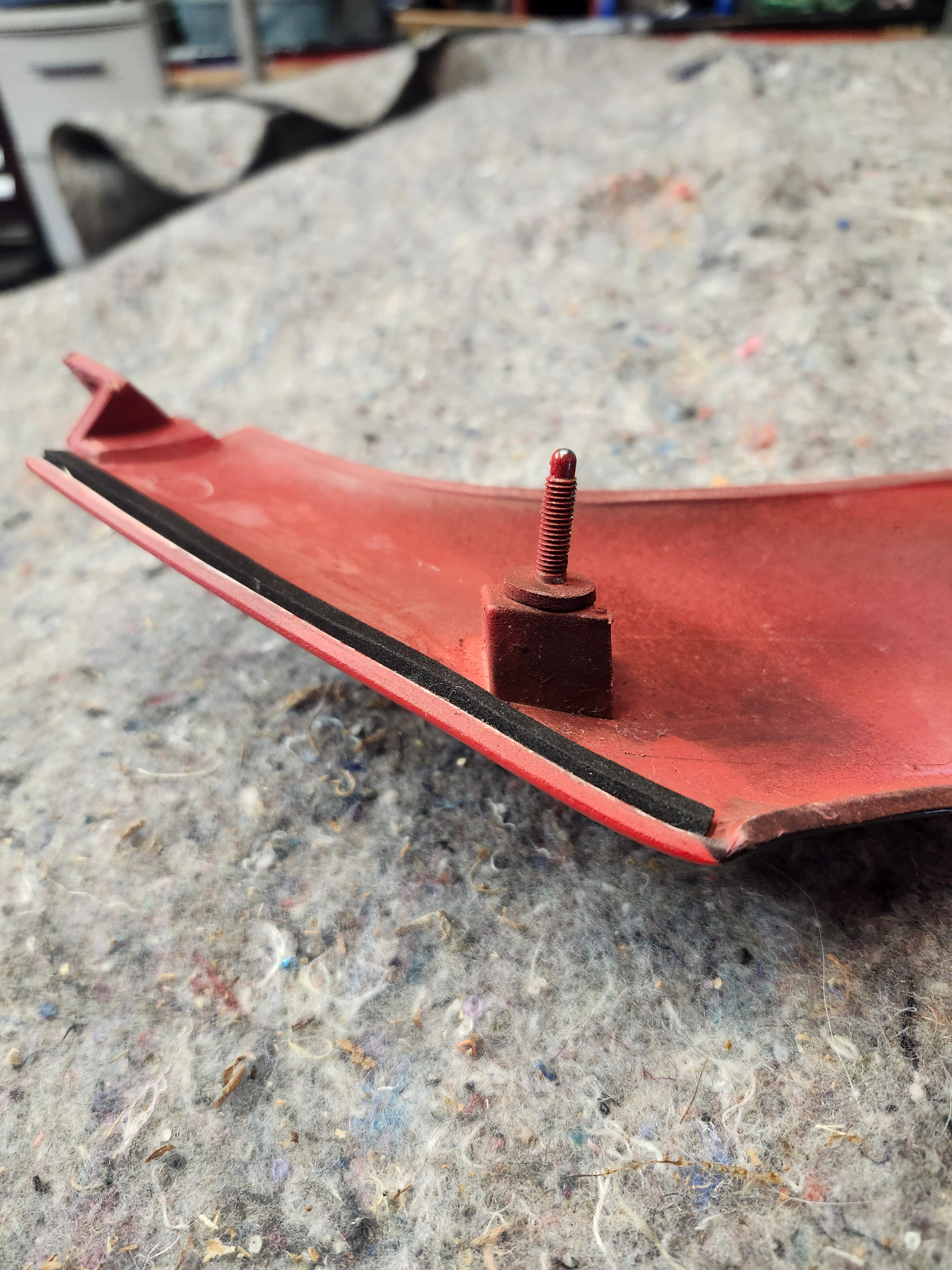

  2. What can be used as a rubber gasket on the upper window garnish? (Also pictured)? It appears two types were used. One against the body which is about 1/8" wise and one against the windshield at about 1/4".
I have checked around for a thin adhesive rubber gasket but come up empty handed.
Thanks a lot for any advice rendered.
The plastic part is usually on the door glass and acts as a guide, it is held in place by the fittings on the glass.
The A pillar seals are unavailable and I never found anything exact to replace with. When I restored my GTO I used some 8mm adhesive backed foam tape but I stuck it to the body of the car and windscreen edge insteas of the trim, otherwise an adhesive edge would be exposed if you tried to stick it to the trim

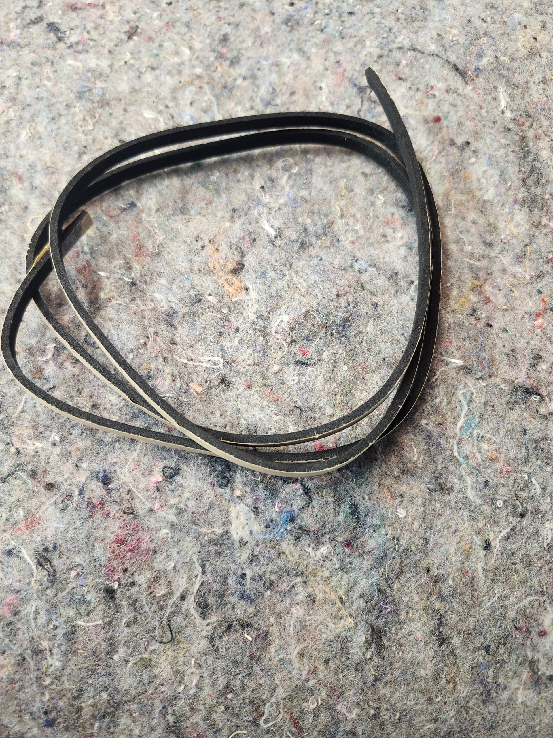

I have some foam speaker tape I got from Crutchfield Audio a while ago with some speakers that I was considering. I needed a lot but I only had a little. I called Crutchfield and since I’m a previous customer, they are shipping me a roll for free and free shipping.
Here are some shots of the tape by itself, and installed. I found it is also used on the sail panel so am starting there since its smaller.
Thanks again
The only thing I would say is that the stuff I used was closed cell neoprene based and more water resistant, I think that stuff you showed me there is more porous foam type?
Its pretty dense. The existing stuff was pretty cracked and porous that way. I had no rust or corrosion behind. I may take my chances.

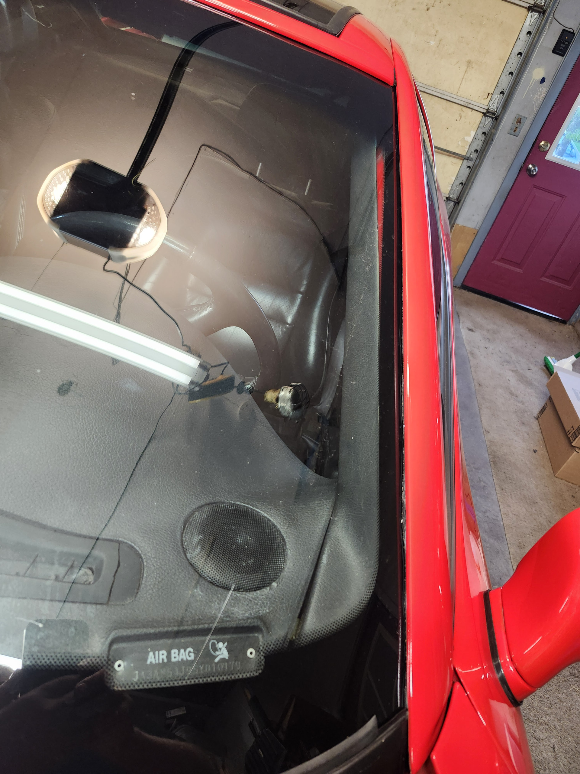

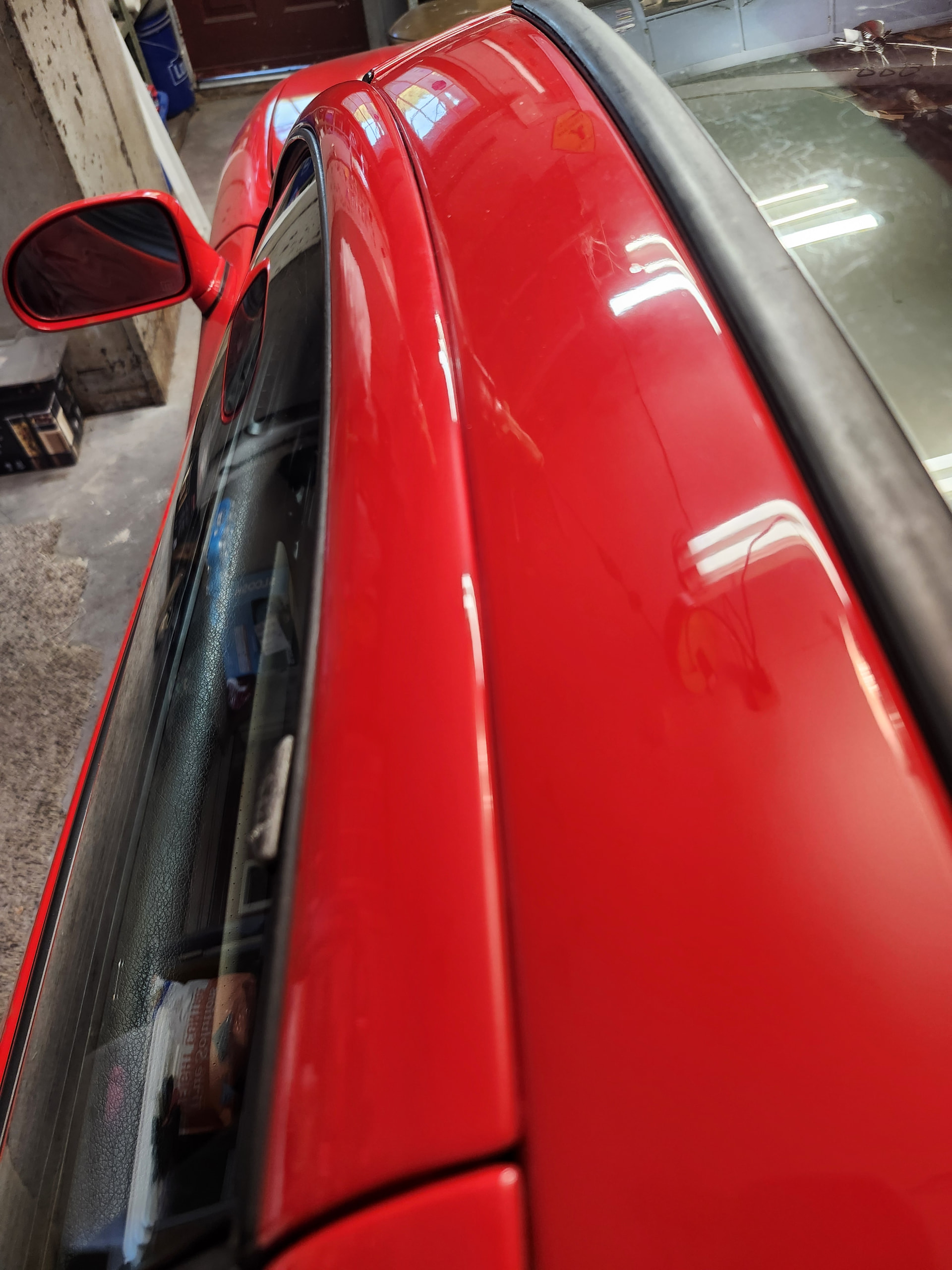

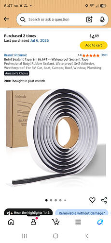

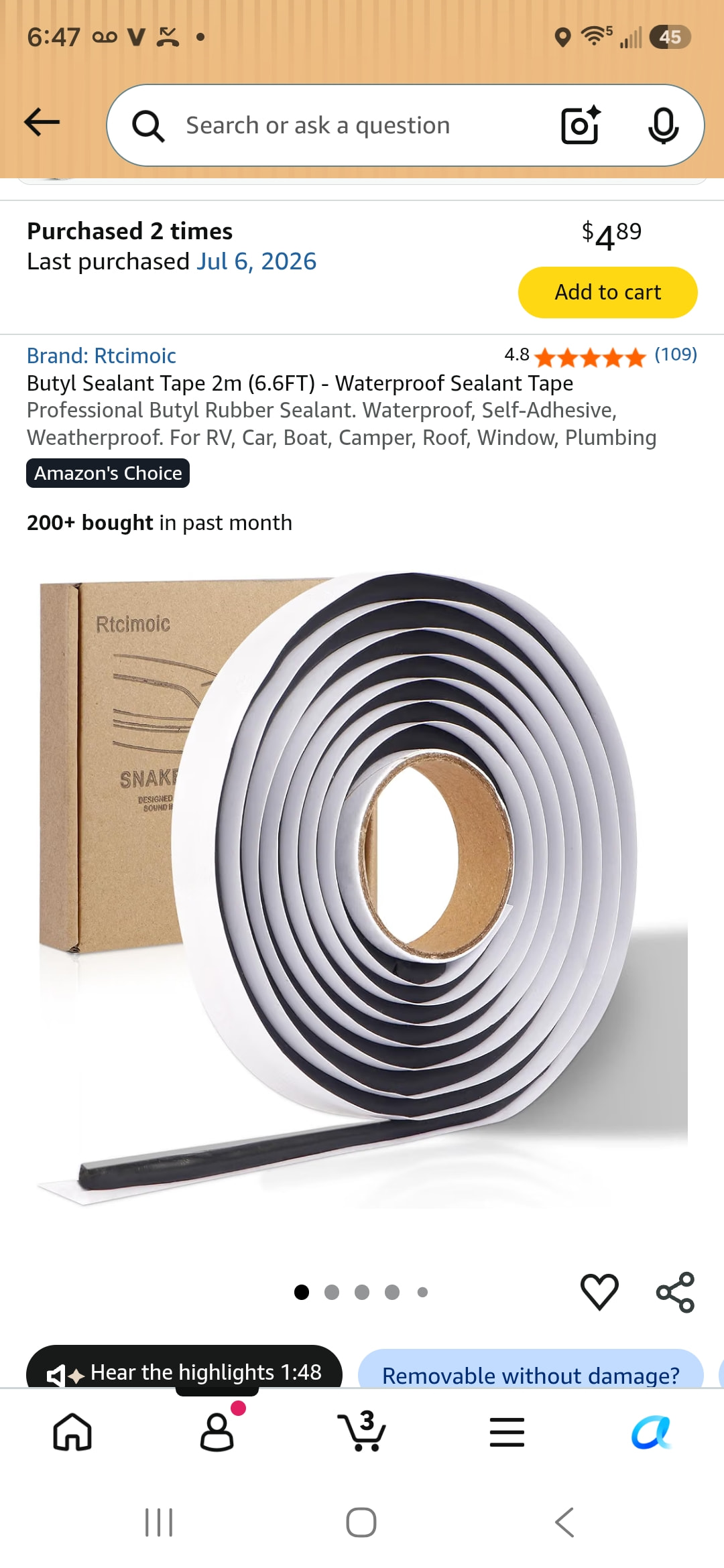

I ended up using Butyl rubber. It comes as a round cord and can be molded for various thicknesses. It seems to work perfectly.
I think you’re going to regret using butyl. It is very sticky and is going to cause issues.
There’s a lot of things I’ve done over the years I regret. I’m sure this is pretty low on the list.
It’s going to be messy. Butyl tape is what is used to stick the inner plastic shield to the inside of the door under the door panel. It’s also used to seal headlights.
It will be a disaster using it as you have used it.
I apologize but perhaps I was misunderstood. I am not considering using the butyl rubber, i did use it. I found it very easy to use. It seemed extremely forgiving and compliant. It could be bunched up for larger gaps or stretched out for smaller ones. It was not overly adhesive and if I moistened my fingers it could be worked with without sticking to them at all. I believe the gaps are sealed against water and that was my objective.
I did not misunderstand. You will regret using it. It is not a gasket, it is a sealant. It will be a disaster.
Ok.nothing like a few disasters to keep life interesting. Thanks for your comments.
