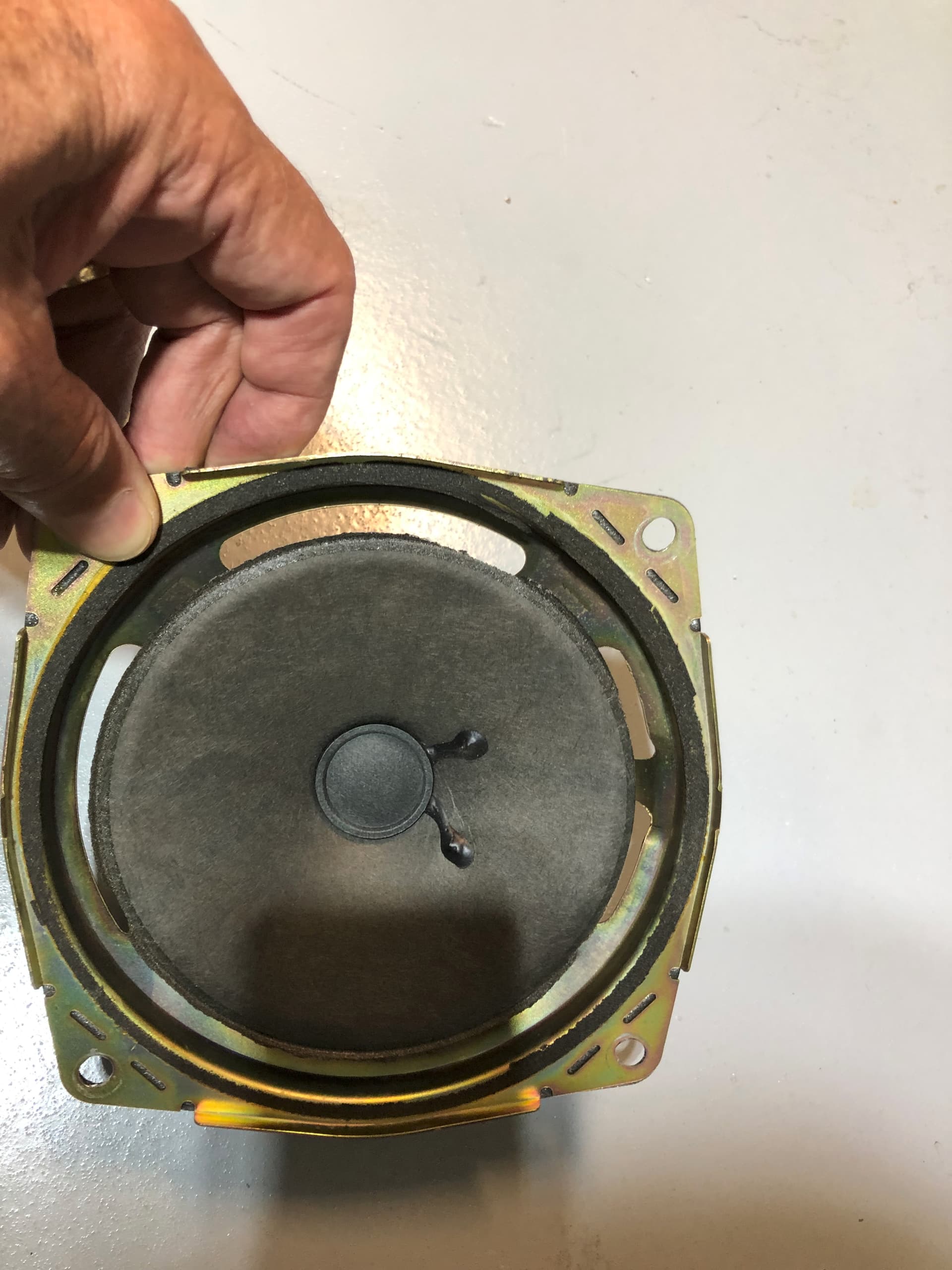

The '92 3000GT SL I recently purchased had pretty much failed in the radio department. I replaced with a 7" flat screen radio with backup camera. Then I noticed the speakers sounded… well… crappy.
I used Joe’s video on door card R&R to get to the originals so I could replace them (and install some sound deadener in the process).
Thought you might be amused at the look of the originals. I’ll try to figure out how to upload the pic of one (both had suffered the same fate).
Important clue to look for here: where is the suspension that connected the speaker cone to the frame!
This is very comon now. You can buy replacement foam lips if you want to repair them.
