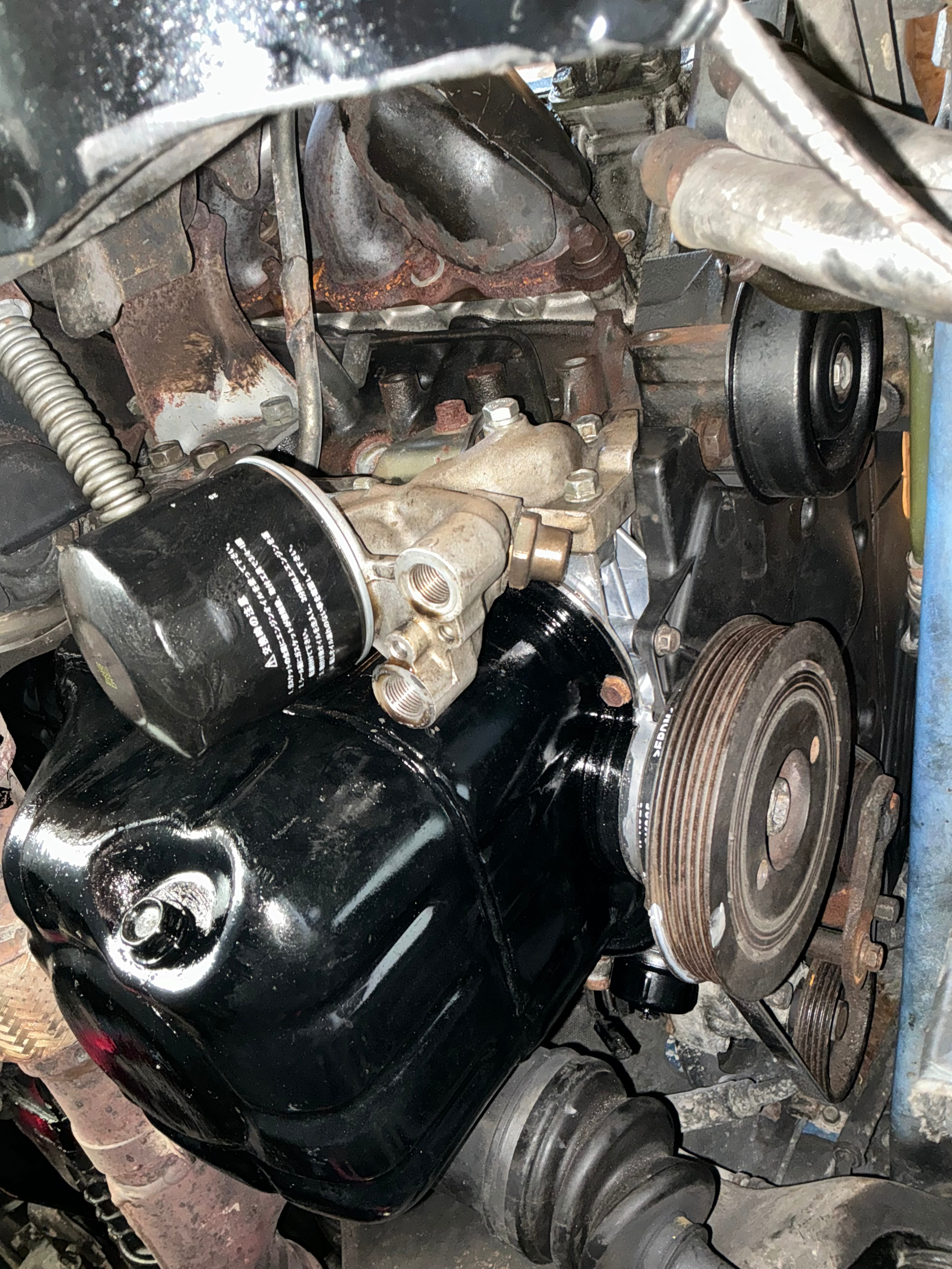

Also what is the large nut/plug on the oil filter housing,see photo.
In that picture the connector for the oil pressure gauge isnt on the sensor.
The thing on the side is the oil cooler bypass valve.
The large nut/plug you’re asking about on the oil filter housing is the thermal relief valve; it opens when oil gets to a certain temp and sends oil to the cooler (like a thermostat for the oil).
