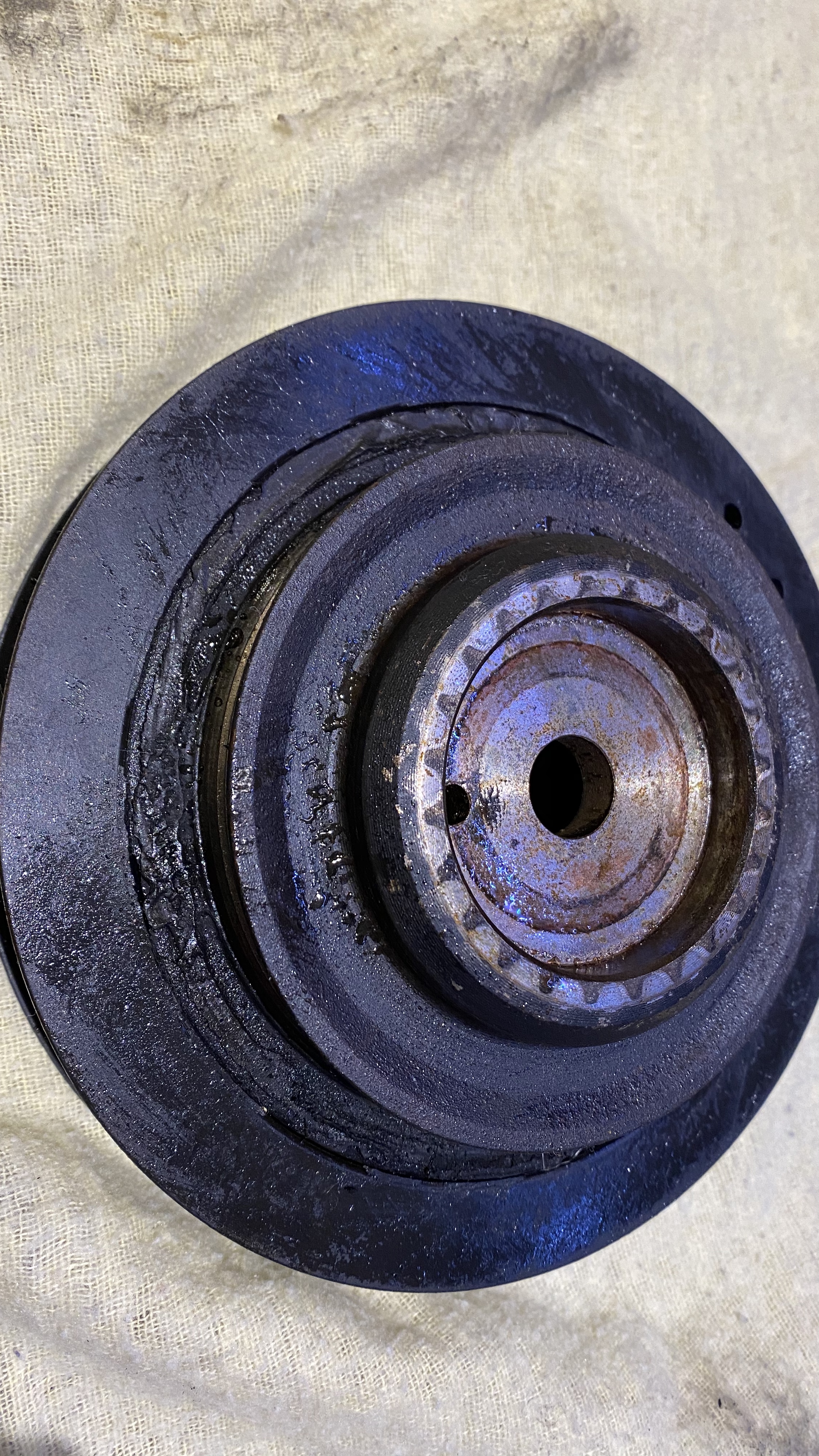

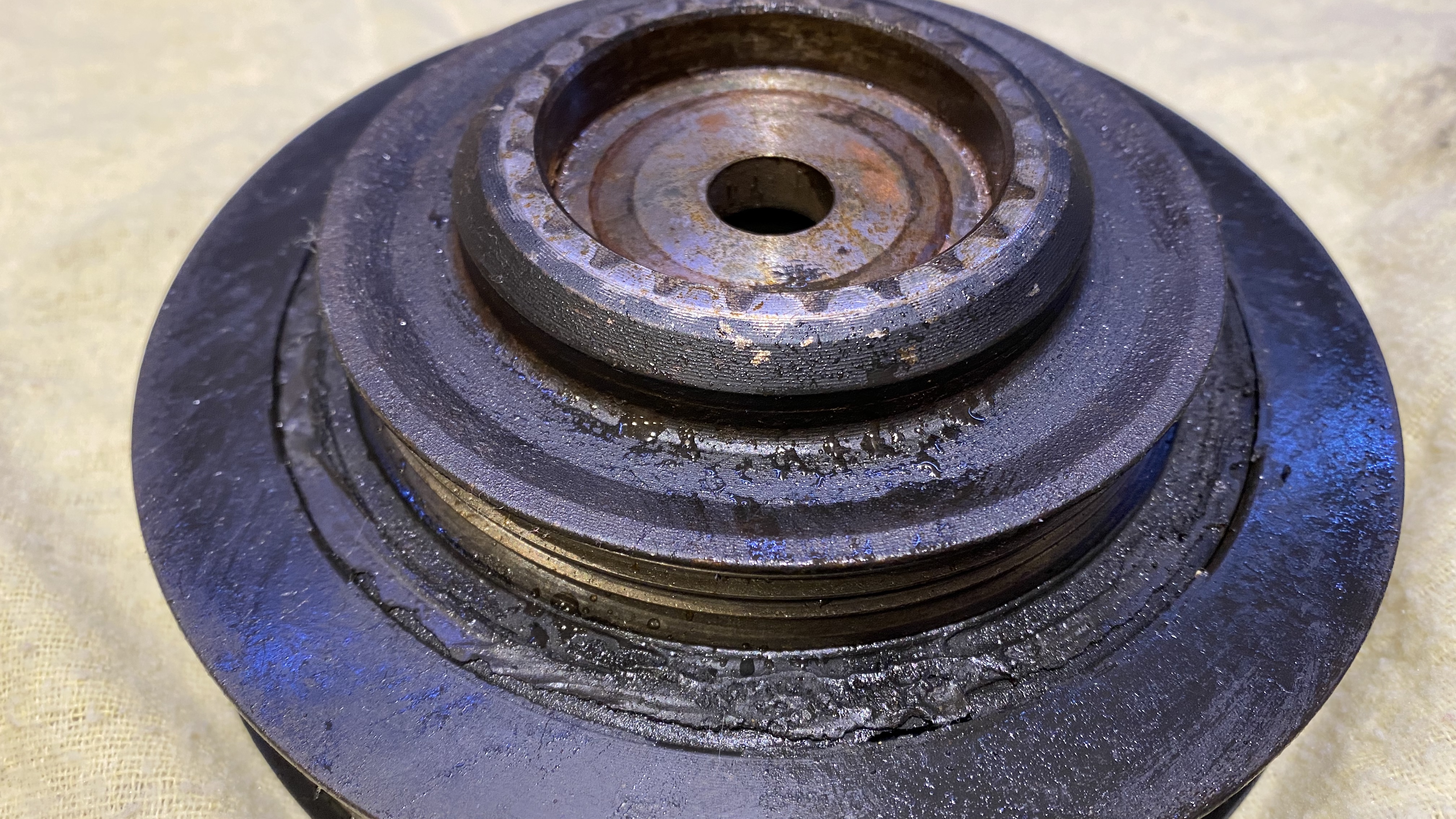

Its been running rough since purchasing it and have changed most items that invlove the ignition, timing and fuel supply. Tonight I removed the harmonic pulley/crank pulley and had a squeeky bum moment when i realised that the pulley is totally wrecked and the cambelt was 3 teeth out at the crank. im hoping that there is no valve damage, but this will only be evident after the new cambelt is installed along with a new pulley!
