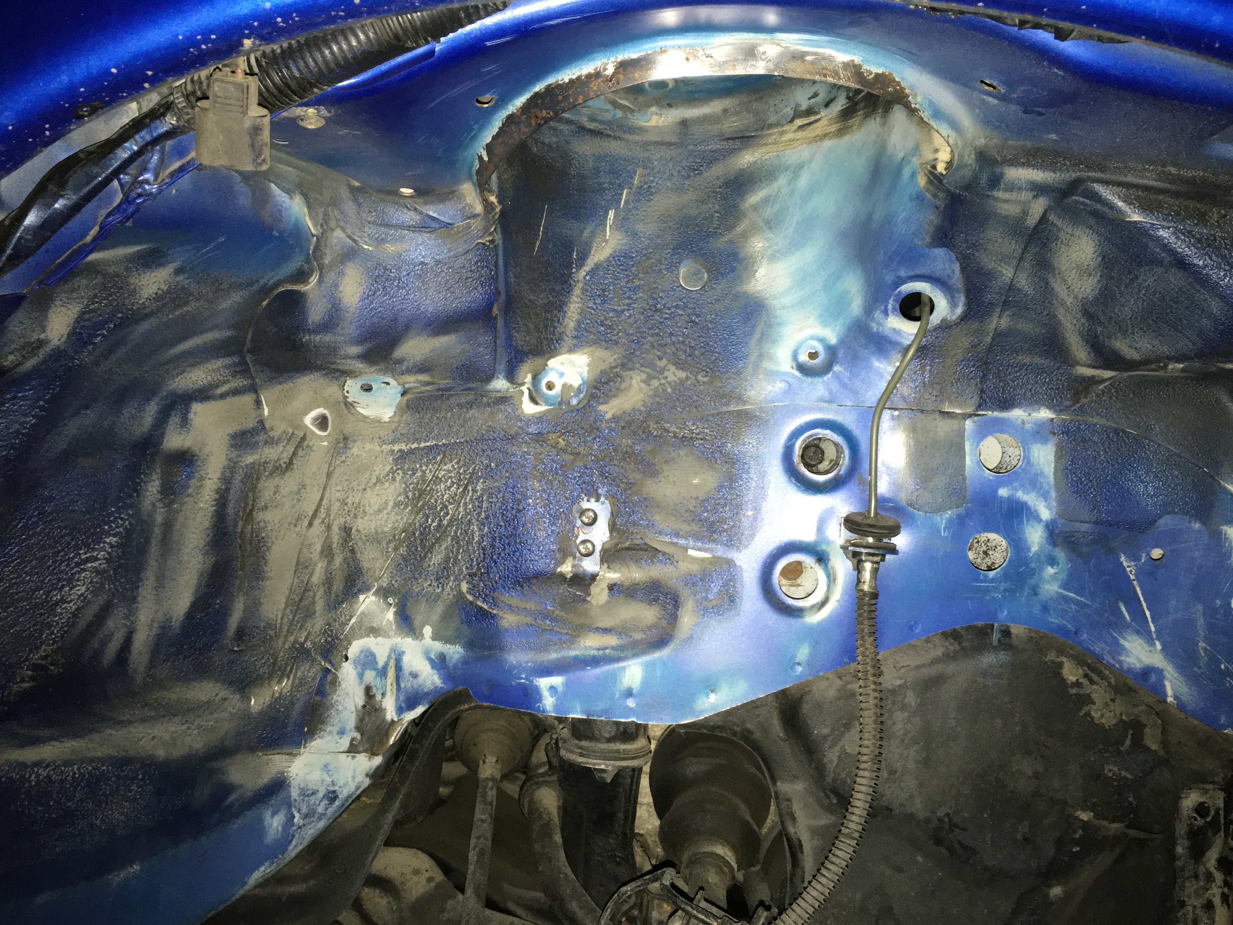

What was supposed to be a simple LED fog light upgrade turned into something bigger. After removing all of the plastic shielding, I noticed the undercoat was chipping and the original paint was still intact.
My OCD kicked in! Decided to restore and clean the 28 years of muck despite my efforts of keeping it clean.

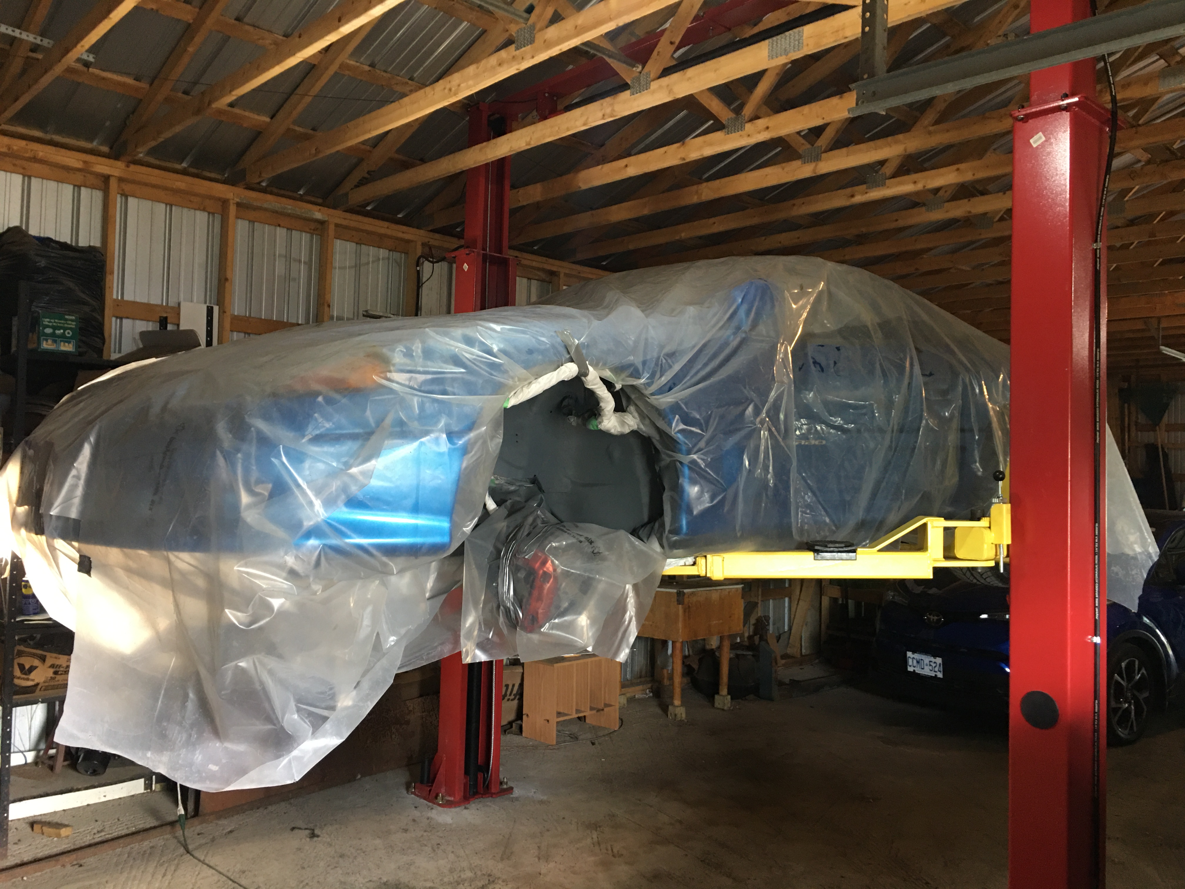

Finally Got it on the lift for primer. “Prep is the worst part”.

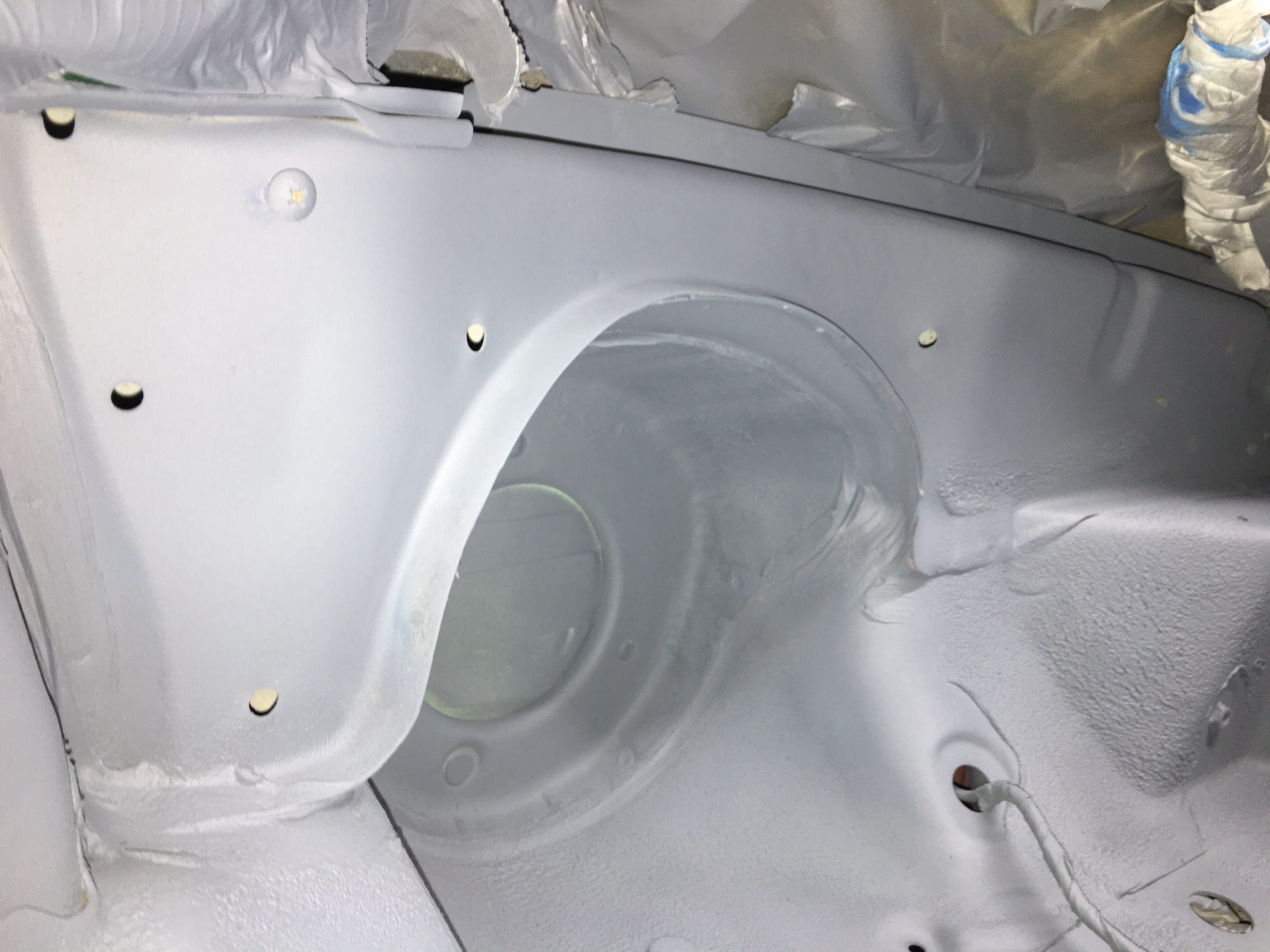

A 2K Primer by Spray Max was used.
Took a long time but worth it. The paint I used is Dupli-color Bahama Blue. It looks very close to match. I’m thinking that the colour on my car is Bahama Blue. 4 coats was applied with 10 minutes between coats. Finally 3 coats of Spray Max 2K clear was applied 15-20 minutes after colour was applied. Remember to keep the paint wet. Light coats but not to light so the paint dries before it reaches the surface.
Nice clean job there :+1:
