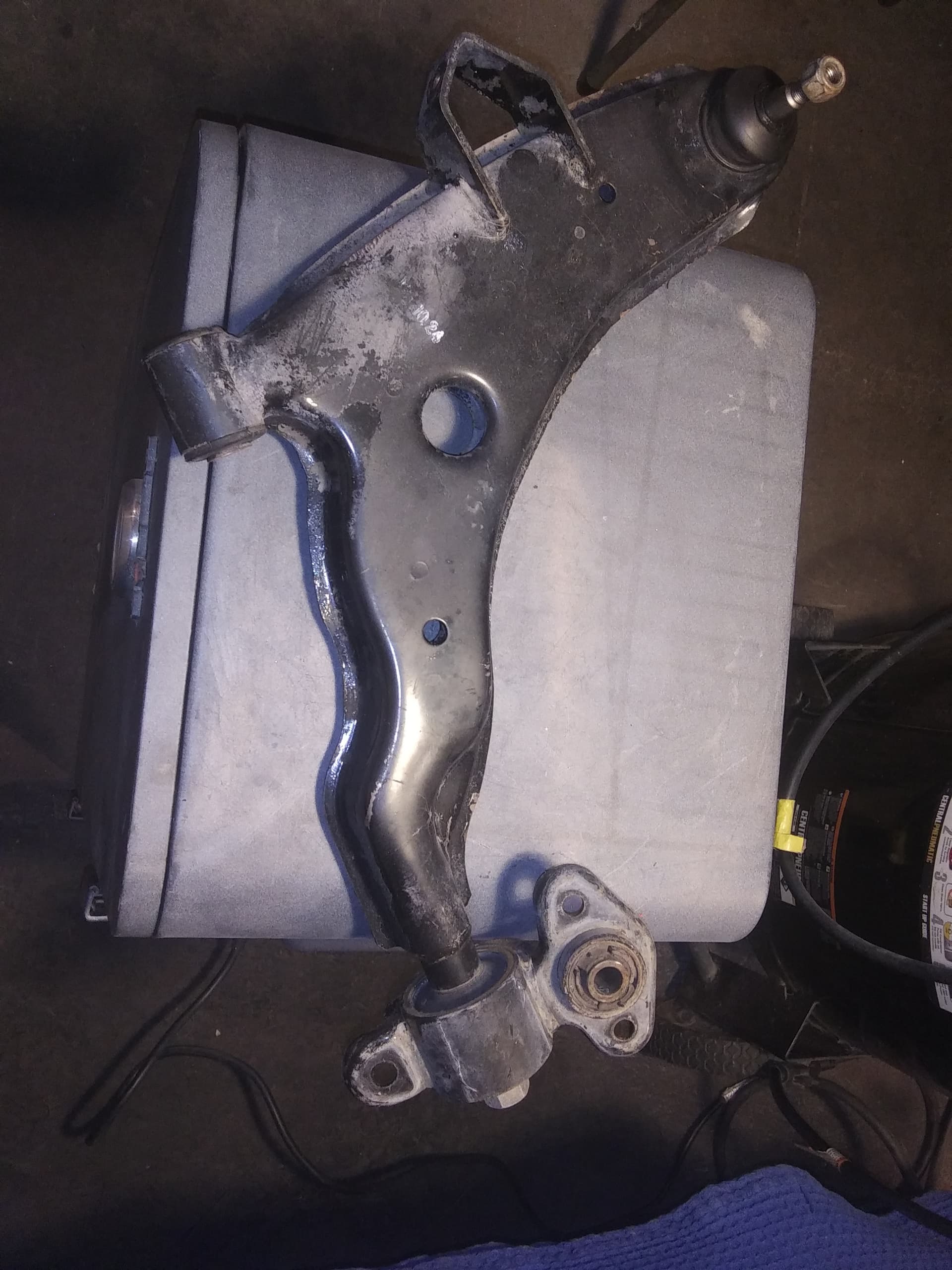

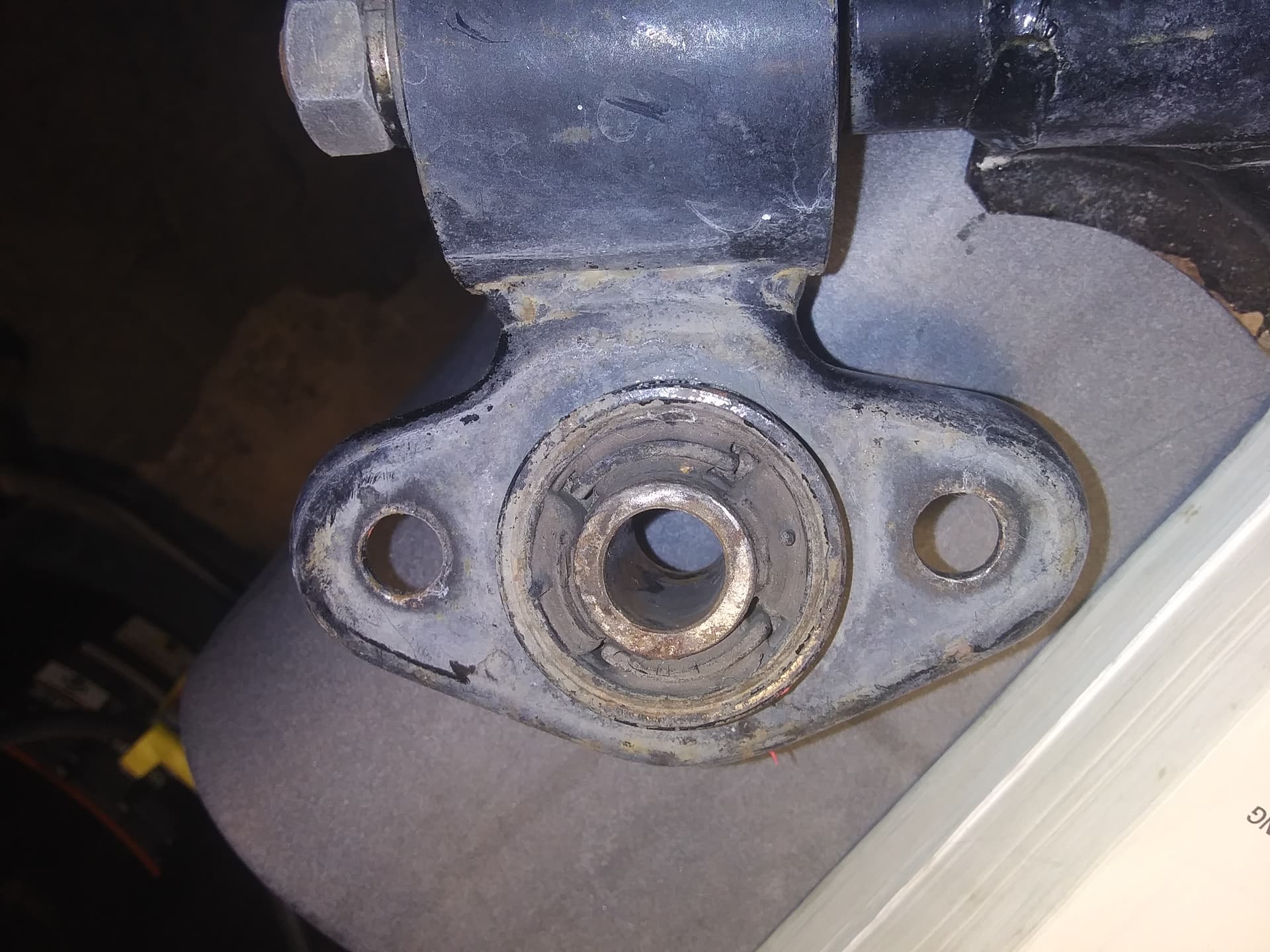

There are three different size bushings and one ball joint in the LCA, as seen in the pic, the small bushing that is fitted vertically is pretty much disintegrated and is around 33mm in diameter and 37mm in length.So, if anyone out there has replaced all these bushings or the one that I have made reference too, would love to know where they bought it. Any help

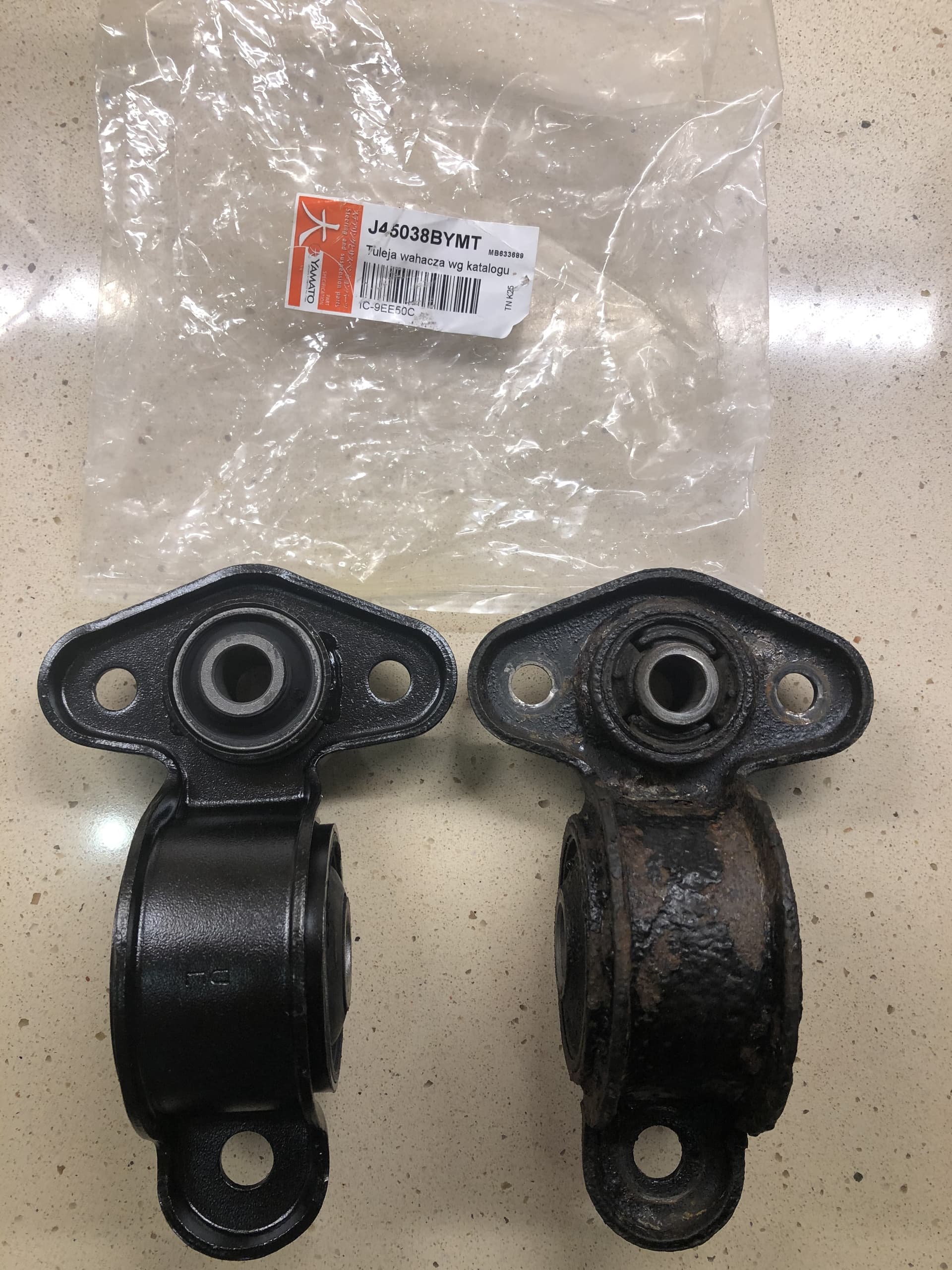

I found this site http://www.yamatoautomotive.com/ When i was looking for Ball joints. I think I got them elsewhere though, however I did keep a picture of the replacement units. You could try to contact them and see how you get on, Best of luck
