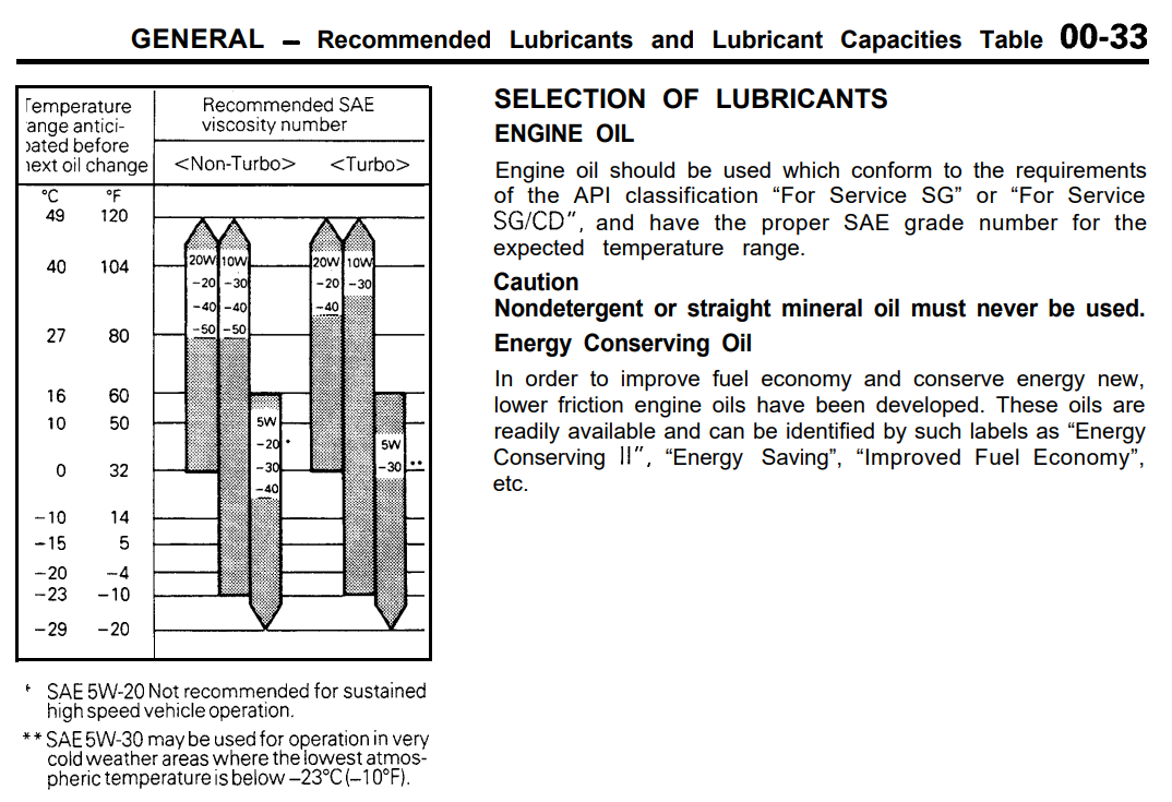

If I’m not mistaken, the oil should be 10/40, semi synthetic. This may account for the problem. Anyone else got any ideas?

as Joe has said standard is 10/30w or 10/40w depending on climate. I have previously rebuilt an engine on another car and the break in period is involved, 1kmiles change 5k miles change, never sitting at the same RPM for too long, lots of driving under vaccum ( throttle closed but in gear). I used millers break in oil but not sure they do the correct weight for this car.

#1 5w30 is way too thin. I’d personally run Rotella 15w40

10w40 oil is what Mitsubishi UK used to put in these cars semi or fully synthetic oil. Been running shel helix on both my TT cars for years with good oil pressure :+1:
I’ve used synthetic 10w40 without issue (2 oil changes so far) on mine which sat a decade before I got it. The pressure gauge sits a few marks below the midpoint under normal driving conditions. It goes slightly over the midpoint at higher engine speeds like 5th gear on the motorway
