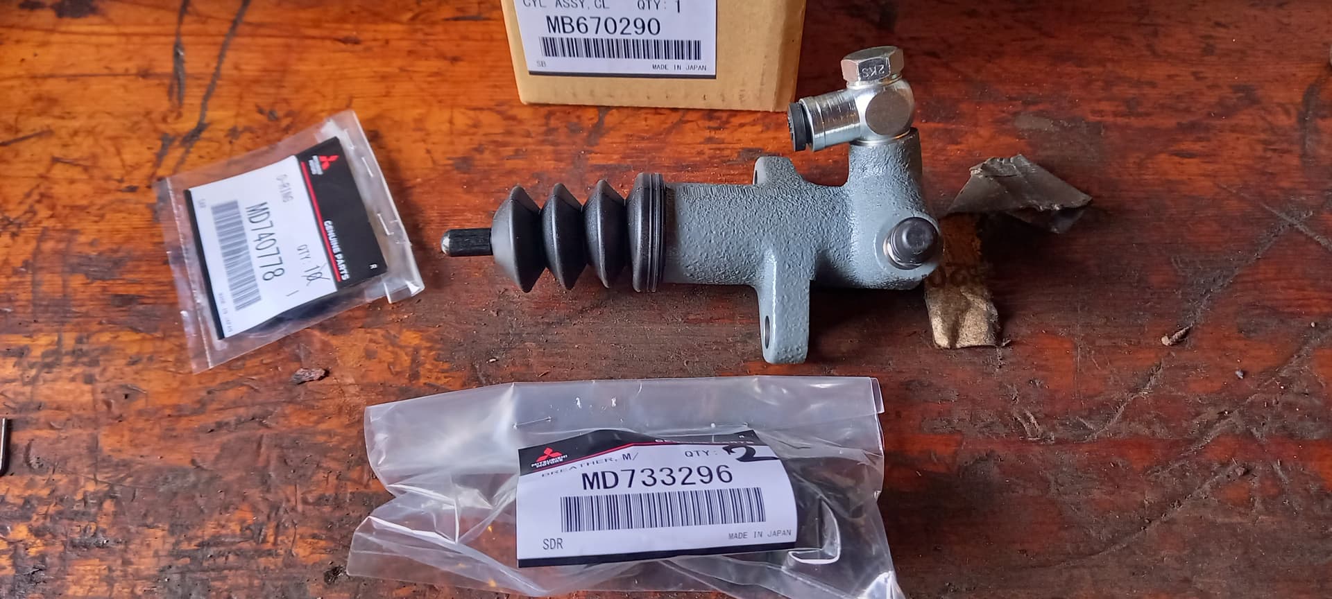

The clutch system barely takes any fluid so what seems alike a big loss is not very much at all. Mine always has a small drop on underside of the gearbox which I thought was the rear crank seal. Then one day the clutch went straight to the floor. Removed the battery tray and a few bits and there was oil all around the clutch push rod. Moving the rubber sleeve, fluid was coming out easily. There is also a small area ontop of the gear box where it can collect so you don’t notice the leak till it too late.
You can just see the cylinder in the centre of the picture between the gear change cables and hoses. I replaced the cylinder and cleaned up the whole bay and no problems since. Replace the gearbox breather whilst you are there. There are two different types so check carefully. Also replace the small o ring in the clutch damper which sits just above that hexagon shaped splitter in the image. Then bleed the whole system with nice new DOT4 fluid. There are two two bleed nipples. The first one to do is on the clutch damper and the next one is on the push rod you have just replaced.

Thank you guys for the information which was very helpful the photos in particular made life easier. The problem was the slave cylinder leaking. As you said, remove the battery and battery tray, I disconnected the screen wash bottle from the tray and moved it to one side. The cylinder isn’t in the easiest location to remove, I had to disconnect the feed pipe to access the lower bolt and trying to get some pressure on the bolts to crack them open after 30+ years was a bit of a challenge. I also replaced the fuel filter whilst I was at it. Many thanks again for your help.
