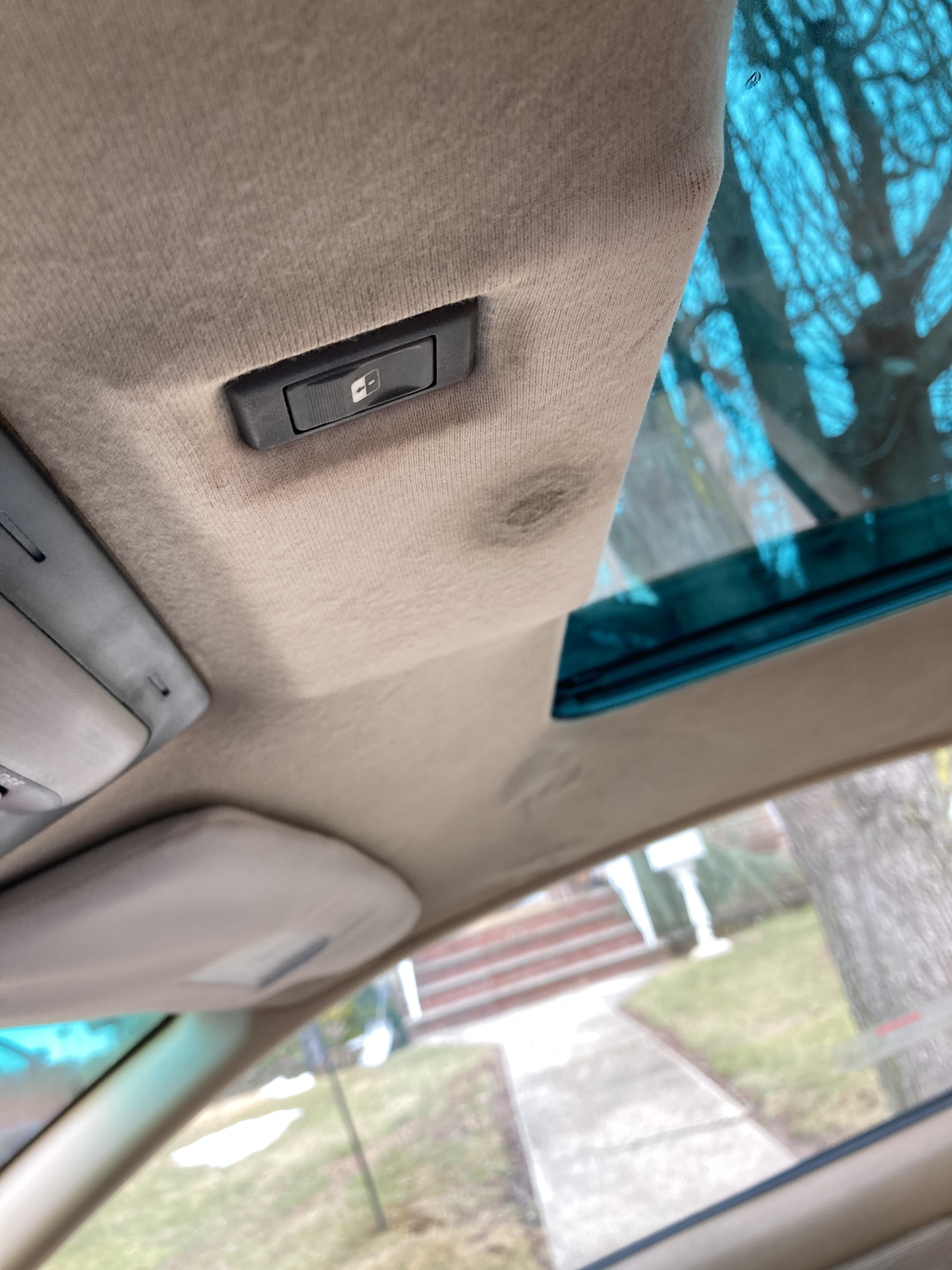

The power switch is definitely different. Ill take a pic next time i get a chance but there is no cover to remove if i remember. I Have no idea how to remove the headliner with the type of sunroof i have. I think part of the headliner is glued to that black bottom part of the sunroof.
Here is the 2 pictures I took today of what it looks like inside.
