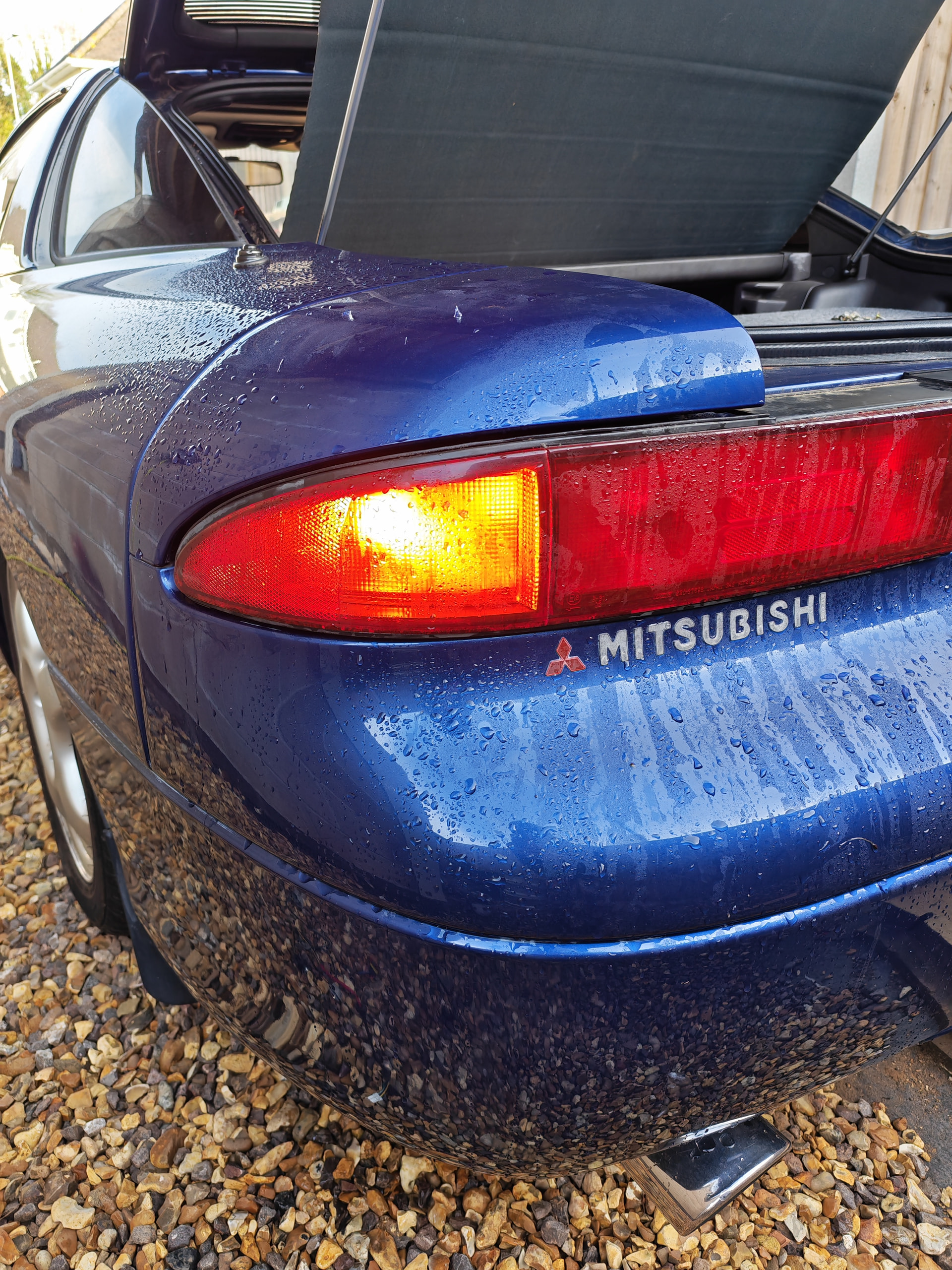

Hey,
I have fitted US style rear lights on my 93 gto. Although the photo may look like the indicator is amber enough, it is definitely still red and won’t pass an MOT. I’m okay with changing back to UK spec rears for the MOT but just curious if anybody has found a way to make them appear more amber. I have fitted very bright led indicators and was thinking of spraying the inside orange, but I suspect this could be a waste of time.

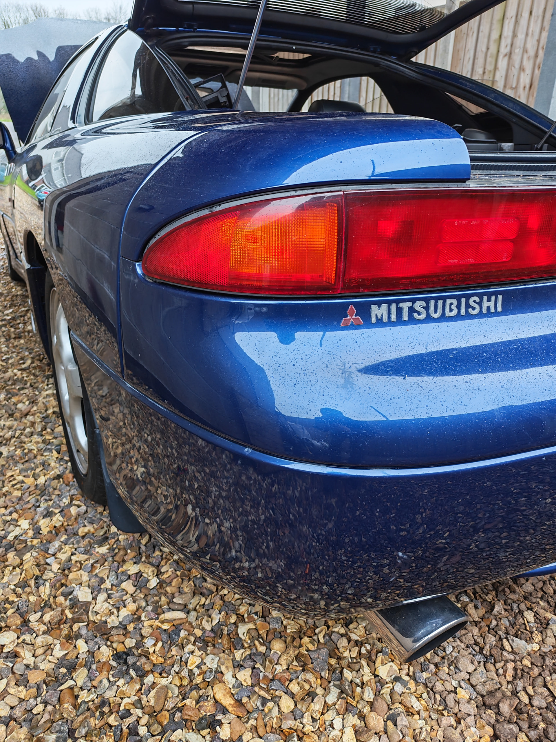

Installed green leds for the indicators. Definitely looks more amber now, however man is it dull. Not too bad in the dark but in daylight I’m not really sure they’re safe! The photos make it look duller than they actually are but you get the idea.

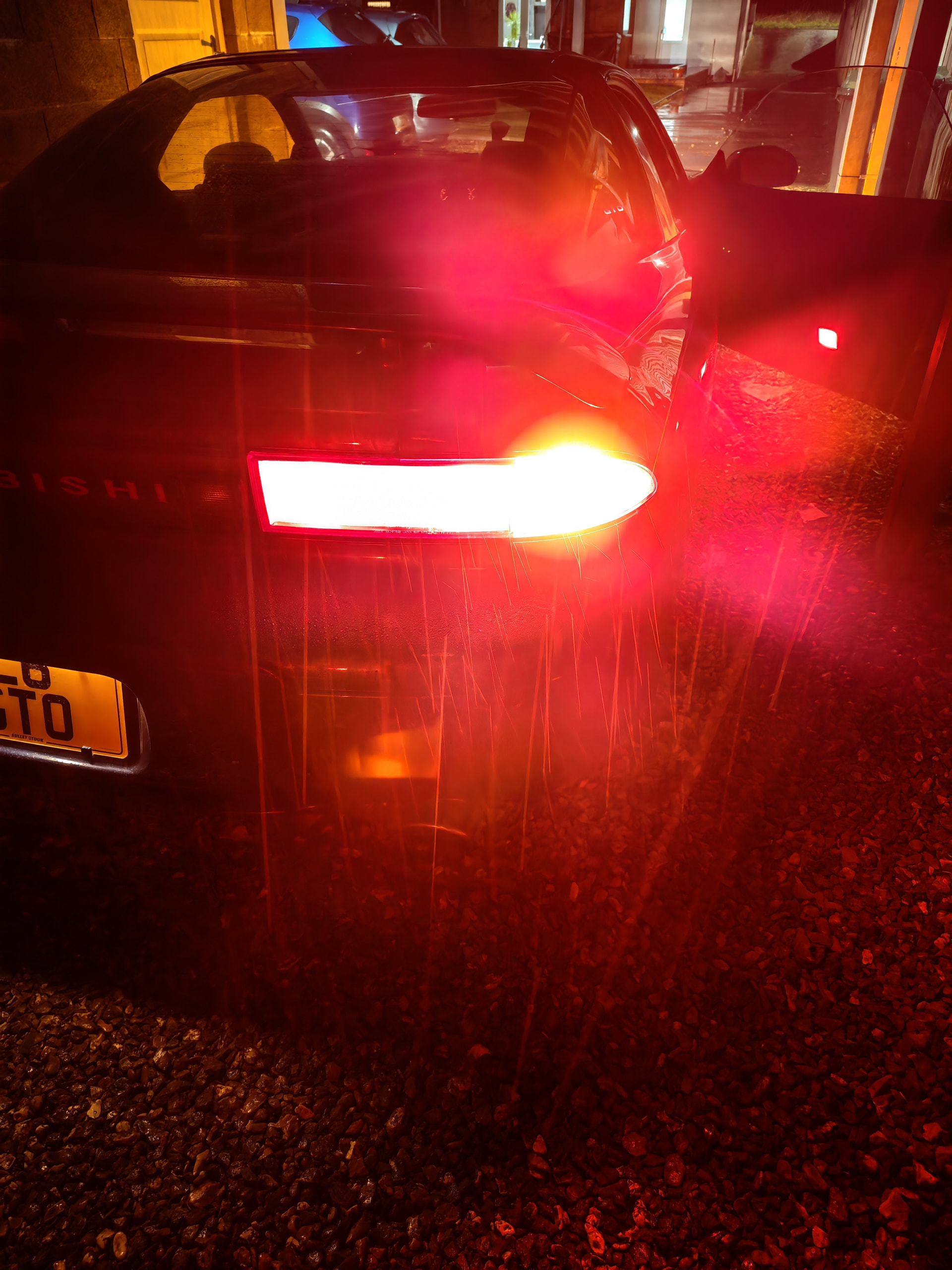

At night:

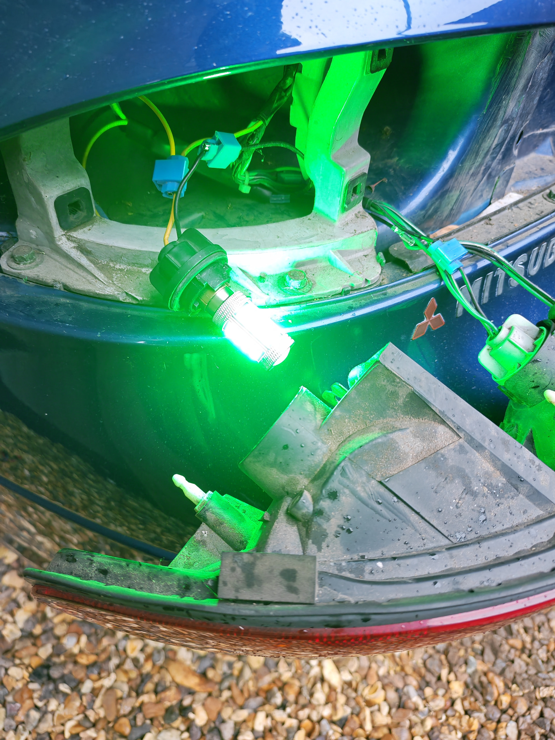

The led bulb which is very bright:

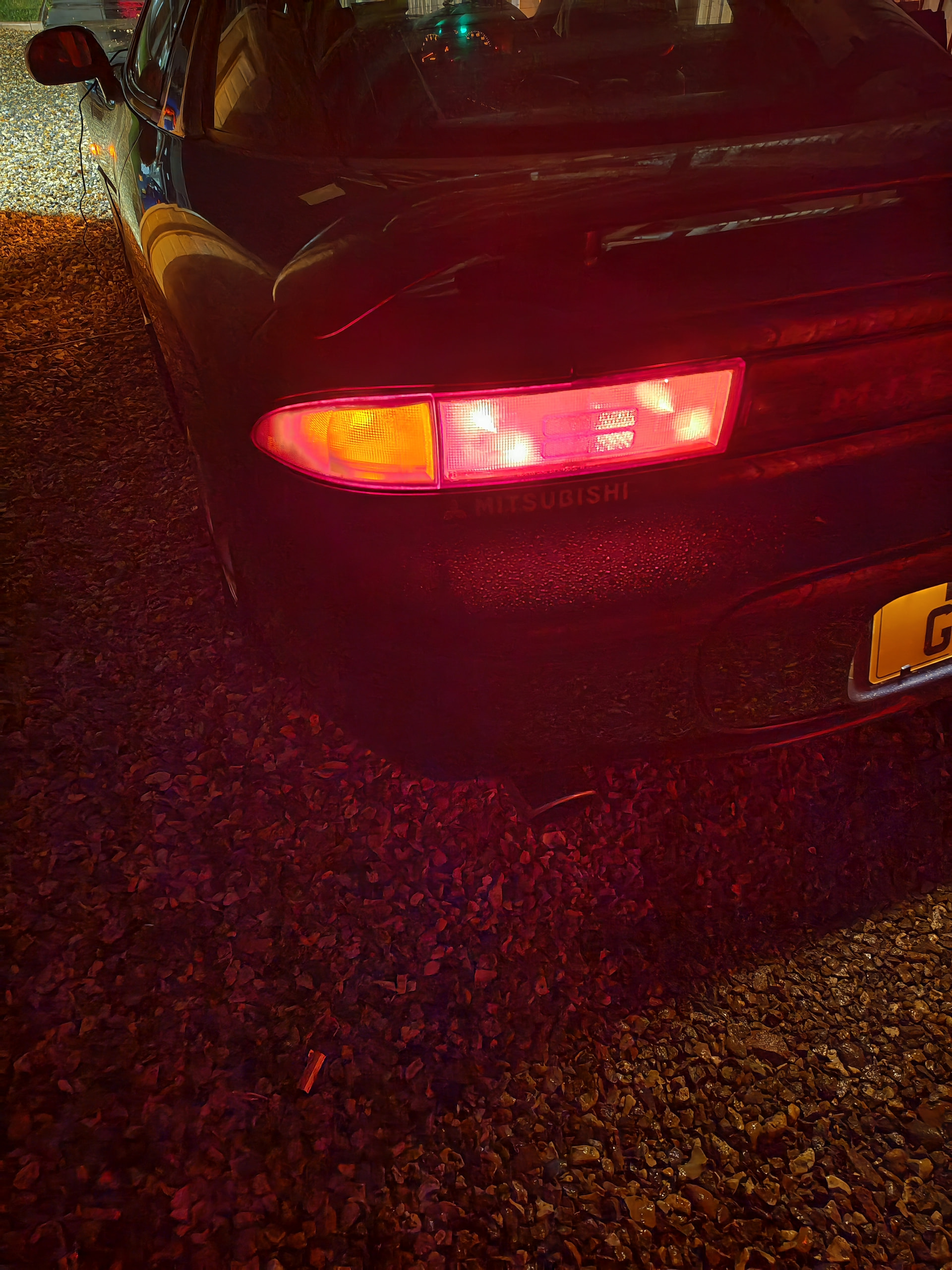

This is the amber led, which during the day is nice and bright (although it looks more red than amber) but at night it’s probably too bright
