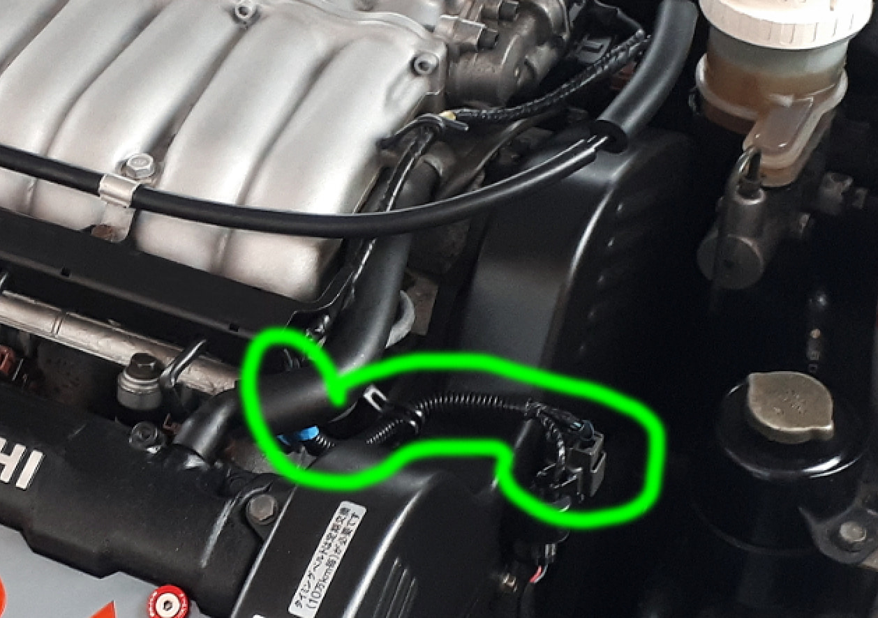

Thanks for the reply Joe. Is it the cable that leads to both the cam and crank sensor connections you mean? (pictured). also - when I scan it still gives me the error for the cam position sensor (even after replacement of the sensor and timing done etc). thanks.
Is that your car in the picture? It looks like new. That is the cable that I was thinking of but you need to check it end to end. Looking at the general condition in the picture would suggest that this may not be the problem but worth checking anyway if you don’t have any other ideas come along.
Hi Joe, yes thats my engine, I do try and keep it as clean as possible. Thanks, I will try to check the wires the best I can. Looks like the cable may go directly to the ecu? I just can’t think of anything else it could be if the scanner tool keeps showing the cam position sensor error. Thanks again.

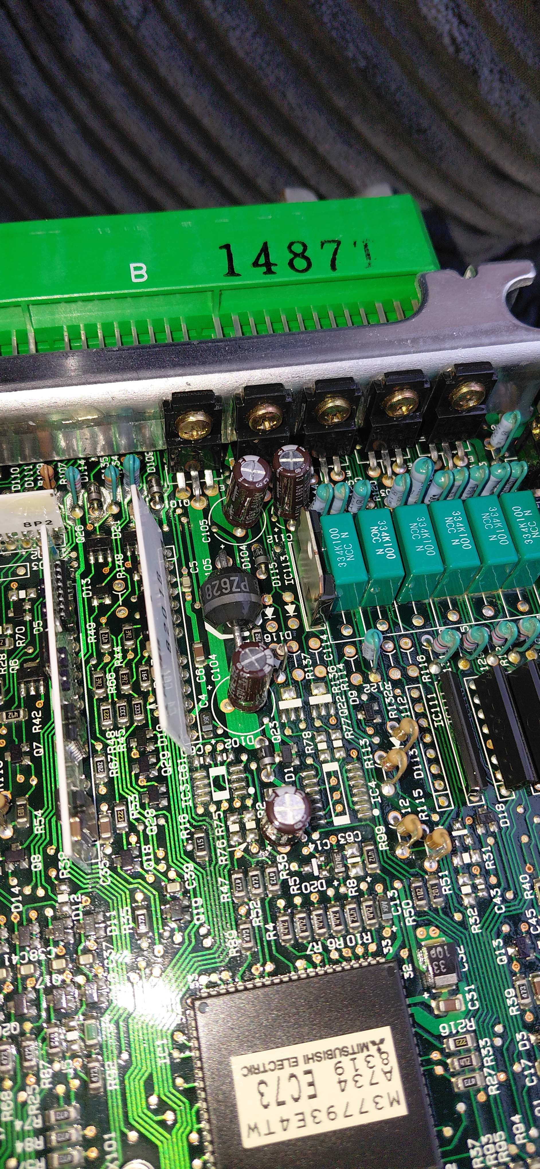

I had the exact same fault, mine ended up been the caps in the ECU, swapped them and it ran great again, I swapped my cam shaft sensor, you don’t need to remove the belt or pulley to swap it though, mine came off easy.
Thanks for the reply. I think I defiantly need to send my ECU off to Joe soon to get it refurbished.
I removed my ECU this morning (not as bad as I thought it was going to be). Capacitors dont loom like they have leaked. I take it that its still a good idea to replace them. Does anyone have any idea where I can get replacement ones? Thanks
Capacitors are A9813 x2, A9728 and A9745. I’ve looked and looked but can’t seem to find anything. Thanks.
I have no idea what those numbers are that you are quoting. You need the uf, V o/c, lead spacing and capacitor dimensions. You will no doubt find them on ebay and a thousand other component suppliers in the UK. Google is a great tool.
