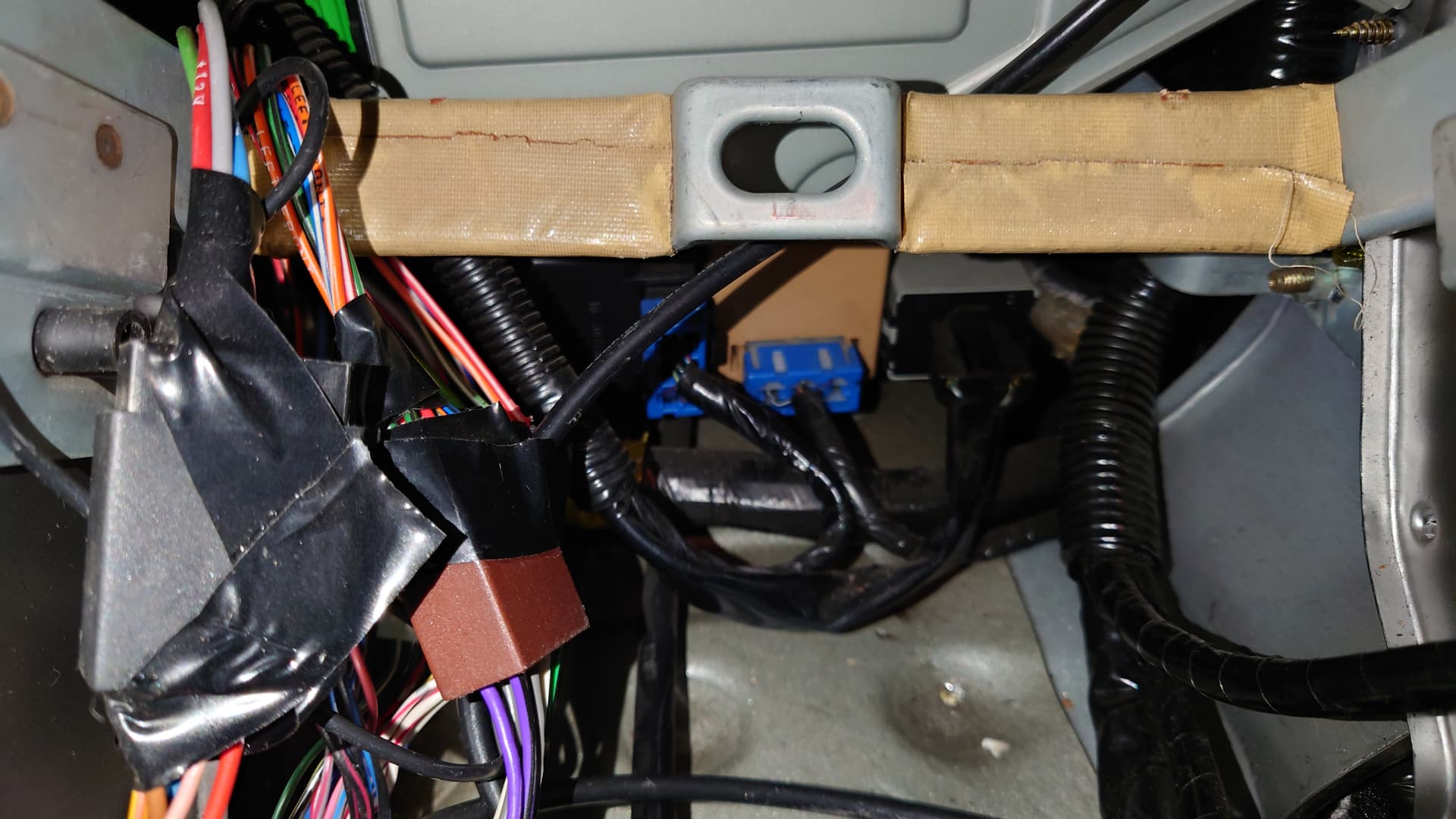

My problem is that the headlight washer pump isn’t working. I already took the front end off, removed the pump and fixed the stuck brushes within the motor. After it still wasn’t working I suspect that it is the relay or the switch on the steering wheel stalk. The problem I have now is locating the relay for the pump. According to a wiring diagram it shows the relay should be about where the beige block with blue connector is (behind the radio just underneath the ECU), but I am not 100% sure. Has anyone else replaced or refurbished the relay? I found no information about it other than a wiring diagram and no one ever mentions it online in the forums I have been to. It is a system pretty much only used in Europe.
Ok, so I realized that the relay is to the left of the beige block. Makes sense as it states cleaner relay!
Can anyone tell me how to get the connector off? I can’t seem to get it free. The black tab on the right side doesn’t seem to move and I can’t find any other way to release the connector. Pushing on the black tab does nothing, pulling it out doesn’t work either. I am a bit worried about breaking something. Anyone have experience getting these things off?
