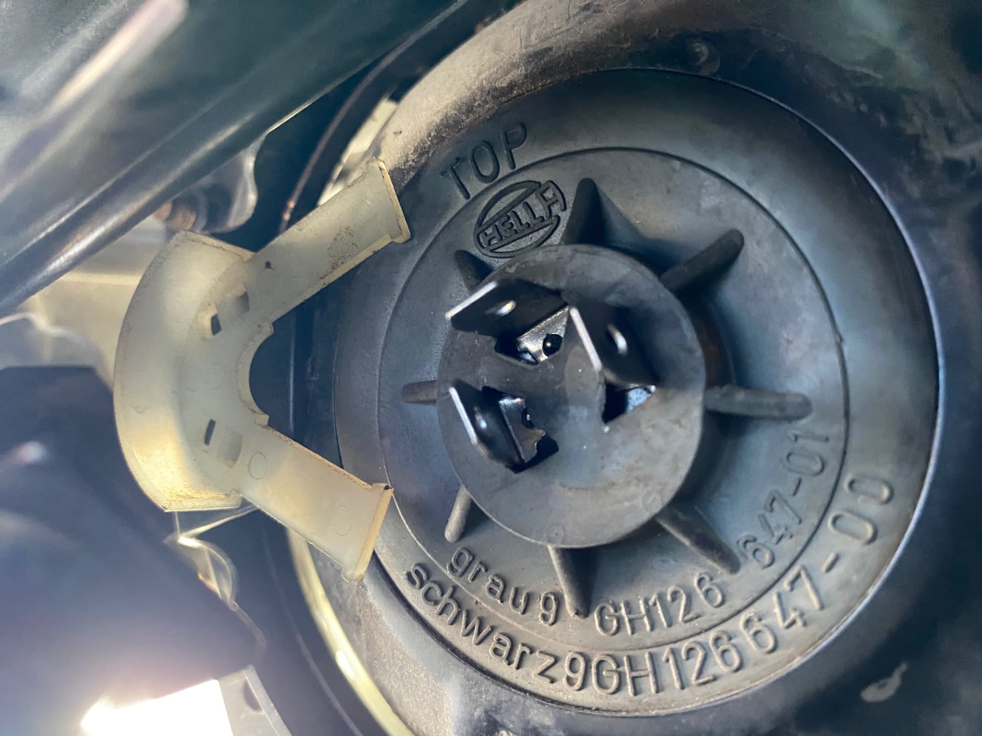

If I flip them open you can reach the contact from the engine bay, Looks like the pic attached. I suppose the grey rubber sealing should be rotated but I don’t know. Either way you need monkey hands to get there!
