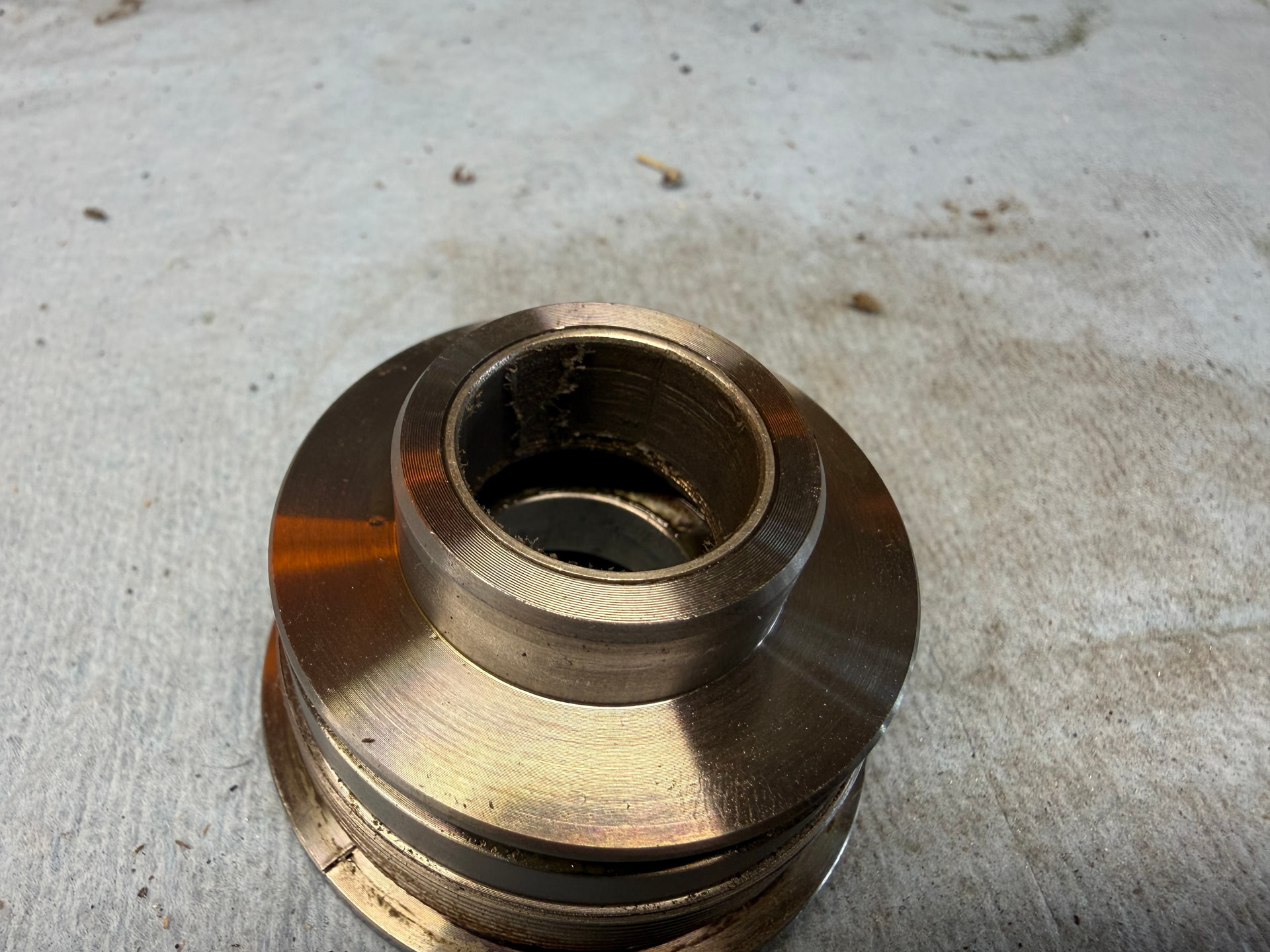

Oh, and one additional question; inside the endcap, and the end of the tube for the rear rack, are small thin bearings/bushings. I think these support the drive piston rod on the ends to prevent scoring and allow for smooth operation. Did you source a replacement for these? I didn’t when I rebuilt my US version as these were good; however, the bushing on the endcap from this GTO unit I got was a bit eaten up (I had a heck of a time getting the endcap off the piston rod for some reason so I think that contributed to the damage to the bushing).

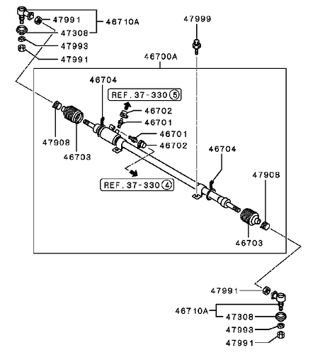

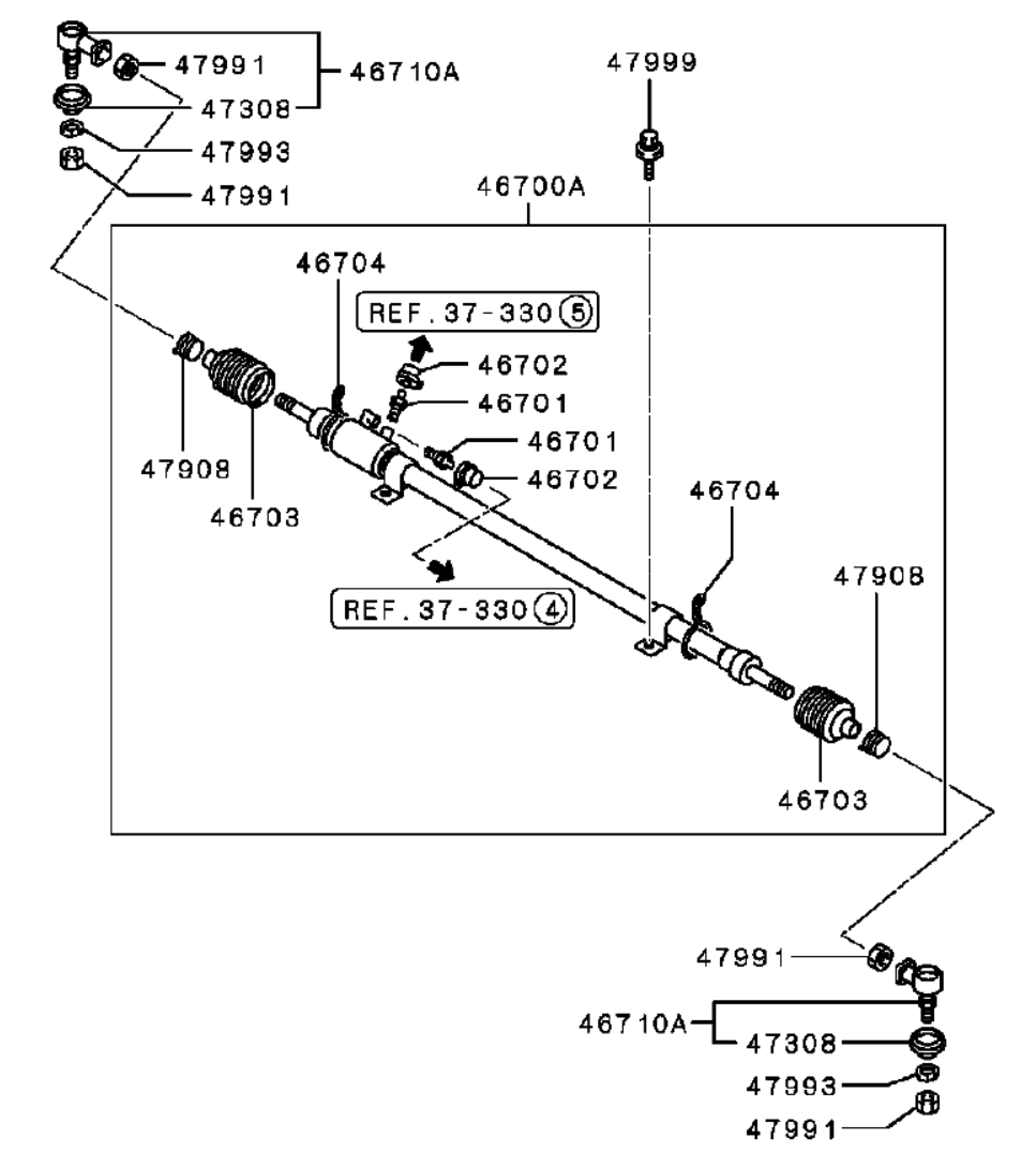

As for the bushing question, there seems to be some confusion or miscommunication. My question pertains specifically to the rear steering rack. Of which, ASA does not list any serviceable parts outside from boots and end links for the most part:

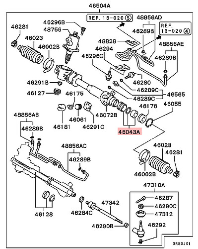

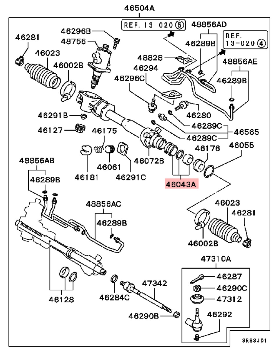

The part number you provided, MB949339, is for the front steering rack:
And, I have all versions of ASA, so I’m able to look up the part numbers so that’s not an issue. The bushing I’m referring to is specific to the rear rack, there is one inside the end cap and another on the opposite end of the rack housing (the small end) and is a guide for the steering rod inside (for what I assume is to prevent scoring of the rod during rear steering operation). When I removed the endcap for this GTO rack, the bushing was scored from what I think is a poorly made steering rod inside the rack (like the end was too thick to push through the bushing, it was a chore to remove the end cap off of the steering rod; my US one when I disassembled/reassembled it a few years ago, didn’t have this problem). Here is the bushing I’m referring to:

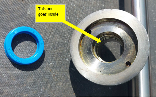

Hi Almos
So you are looking for this seal as per picture attached in blue. I took my old seal to this Company www.Hydraseals.ie which was about 20 miles from me. And they had off the shelf seals that matched the diameter and thickness of my own. I would assume that you would have a similar supplier or outlet there that you could try.
@Pken No, I found the SKY-18N o-rings during my first round with this (I have a picture to add later in my diatribe that shows the markings on the back side of the o-ring with this label so that’s how I refer to them). My whole response would have made more sense if it were not for the limitations placed upon my account (I get why they’re there, but, it is really impacting the conversation).

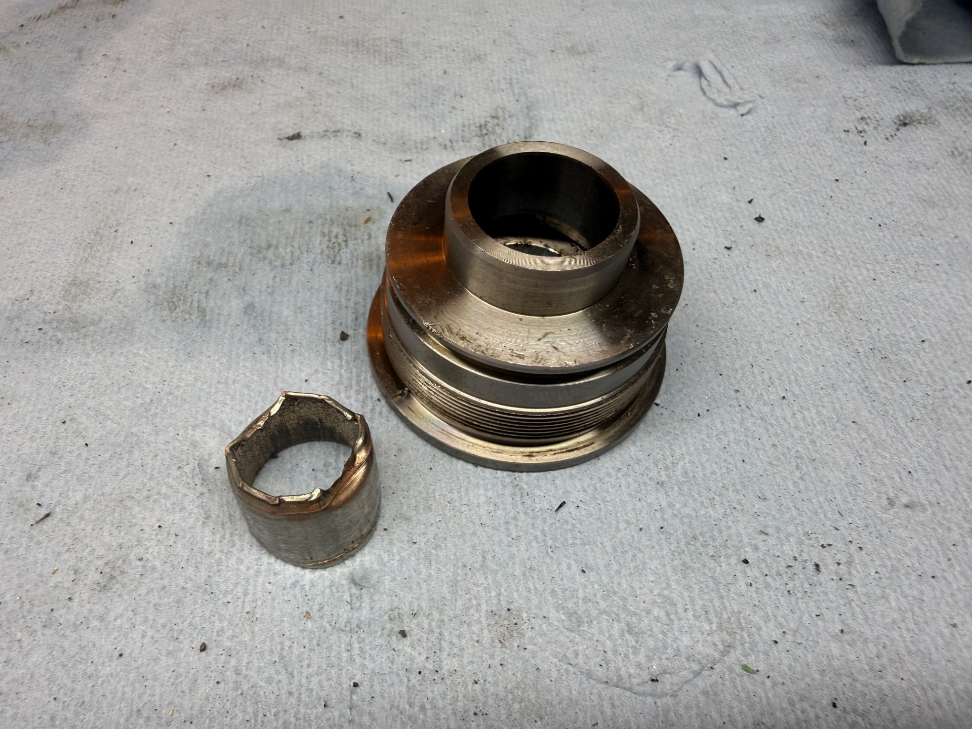

So, following up from my last post, here was the next bit. Again, I’m specifically asking about the bushings in the ends of rack. These do not seal but prevent scoring of the drive rod inside the rear rack.
Unfortunately, the bushing got a bit mangled upon removal. I tried to press it out from the other side (outside end) but the opening is smaller diameter than the outside diameter of the bushing so any tools I used to press on it actually slipped inside the bushing exacerbating the problem. This also meant I couldn’t press it through the end cap; so, I pressed it in slightly, deformed the inside a bit to create a lip, and then pressed it out the way I had intended (it came out from the inside of the end cap):
I’ll add a couple more responses below which were typed out before as part of my response train yesterday. Again, these were all meant to be part of the same post to provide context to what I’m asking.

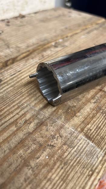

NOTE: I found your method of removing the end cap a bit more inventive than mine; I simply cut up a socket to turn it into a 2-pin spanner which I could hit with an impact to get it apart.

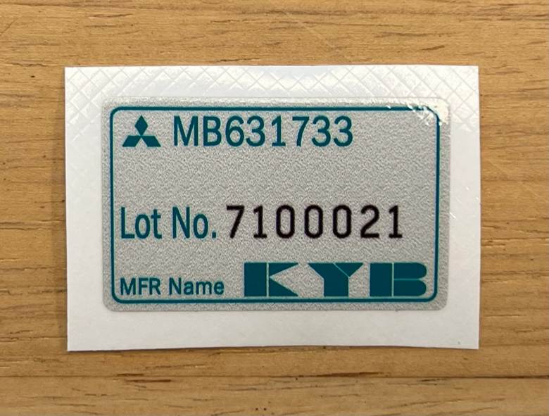

When I refurbished the factory rear steering rack on my US car, the sticker was in ok shape and showed that KYB made the rear steering system; I reached out to them at the time to ask if they provided any sort of replacement parts for maintaining the system. What I got in return was basically that they didn’t and considered it proprietary (so, I was on my own). Here is the replica sticker from my rear steering rack:

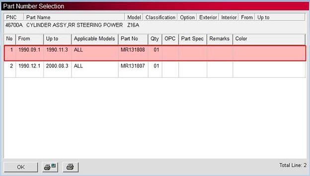

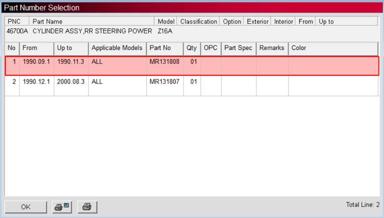

Continuing where I left off; again, only trying to provide the full scope of what I’m working on and to provide you guys (at least for those interested and still reading this thread) the differences in the 2 versions of the AWS system.
You’ll also notice that the part number on the sticker I showed earlier, which was made off of my original one, does not match what ASA shows for the rear steering rack for the early GTOs; GTOs built between September and November 1990 share the same system as all US cars; afterwards, the GTOs got the system you have (funny enough though, all the Euro 3000GTs got the later GTO system as well - according to ASA):
EDIT: I found the discrepancy in the part numbers. I have an old .pdf of part listings I think Mitsubishi provided dealers for quick reference (not sure why I didn’t look at this before); perhaps it pre-dates CAPS (the predecessor to ASA). Anyhow, it says the rear steering assembly for 91-94 USDM 3000GT VR-4s is MB631733 (the number I had on the original sticker) and that for 95-99 USDM 3000GT VR-4s, it is MR131808. The weird thing is, while my car is a 94 Stealth, I replaced my original system with a setup from a 98 VR-4 due to excessive corrosion (this was some time in the 2006/7 timeframe). When you search in the US version of ASA, you only get MR131808 as the part number for US rear steering racks for all years; so, I think they did a database/part number update which removed the old numbers (again, a guess on my part). So, this at least confirms part of what I think happened; I just don’t know if the same change was made to the part numbers associated with the GTO’s rear steering system (hence my OCD having me go around asking folks for pictures of their original GTO’s rear steering rack sticker).
