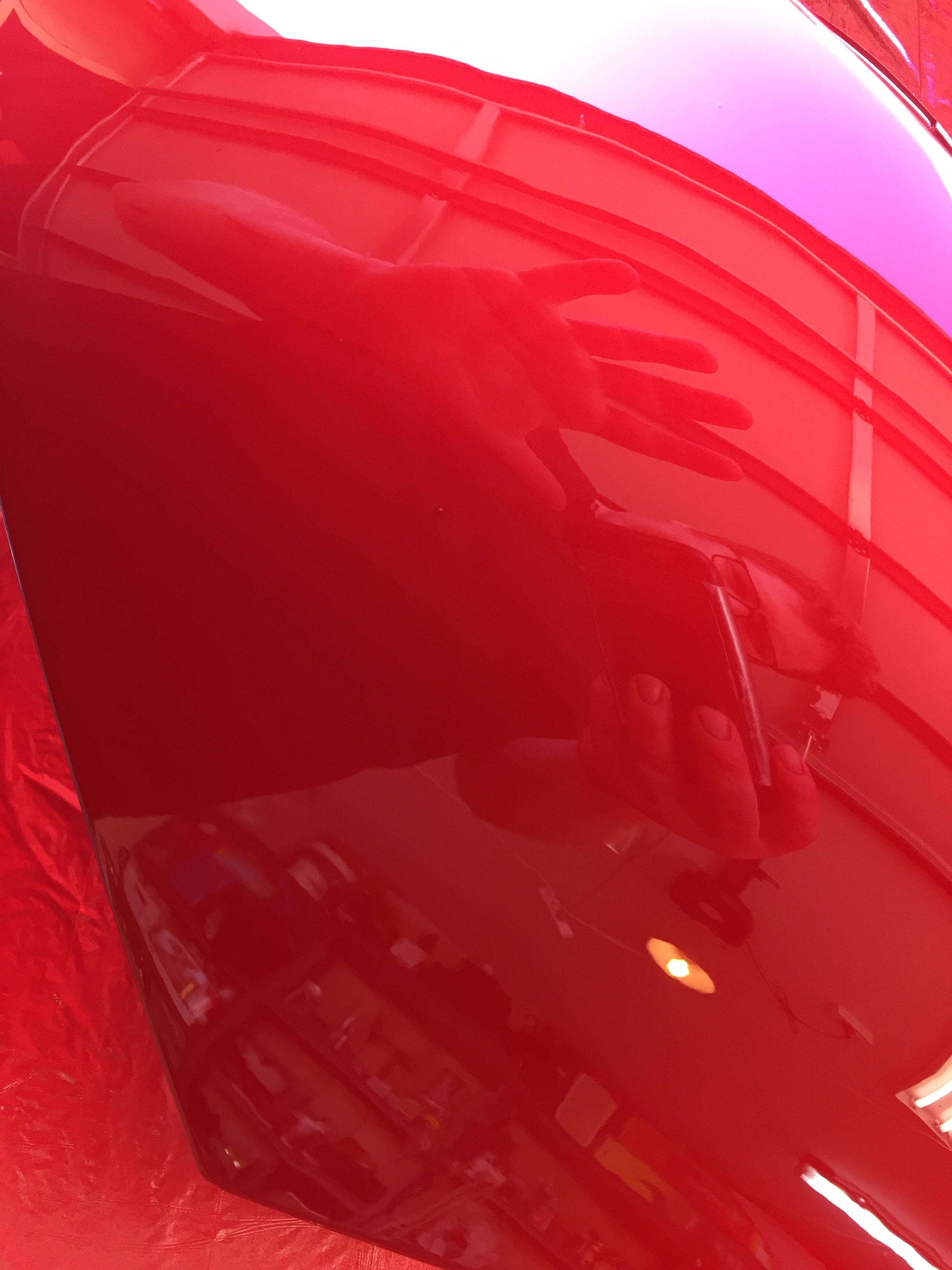

Hi forum members and of course Joe I just wanted to send some pics of my Monza Red respray on my 1990 GTO. I’m taking my time as I’m learning to spray as I go, I’ve switched from acrylic paint to 2pack and will never go back haha

Unless you are sanding down to bare metal, you shouldn’t need primer because your car already has it. Always try to respray using the same paint format as original. Some early models were done with 2K, also known as 2 pak or 2 pack. It is a much more durable paint but it is now banned in most countries. In the UK, you can still buy it if it is for a classic vehicle, a tractor or motorcycle. About 1l should be enough if you don’t put it on to thick. Don’t forget that you will need to add hardener and thinners so the actual volume of paint will be more.
If you are using base coat and clear coat, you will need about 1l base and a little over a liter of clear coat if you want a deep shine.

Hi mate I’m using 2pack and a full respray would be 3- 4 litres of colour and 2 a 3 litres of primer. 2pack covers way way better then acrylic, I’ve tried both and no going back now

Booth 2 pack paint today and got exactly the same advice in the paint shop that 2 pack covers a lot better and that 4 liters should be enough to spray the whole car
