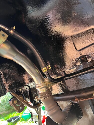

Check the rubber house that allows air out the tank when filling with fuel- the smaller diameter one in this picture. It doesn’t take much to allow fuel vapour to escape- can be worth replacing some of the old rubber vapour hoses as they’re pretty old now.
You haven’t really mentioned the general condition under the car. I have seen a number of the filler tubes completely rotten and leaking. Also check the rubber hose that connects the filler to the tank. If there is rust around the connecting points, vapour will seep through, especially on warmer days as the pressure builds up in the tank. Make sure you remove the plastic arch covers to get a really good look.
Thank you both. I had the car up today with the wheel arch cover off, a bit cruddy on the whole but structurally sound. There is a little rust on the filler neck nearer to the top, the protector had 1 screw rusted away and the hose clamps near the tank are cruddy also (but not thoroughly rusted). It was dry weather and I couldn’t see any wet spots which would indicate obvious leaks in the area.
The vapour hose itself didn’t seem bad either but the clamps were fully browned. I’ve got some spare fuel hose and clamps so will replace that as a first call since it’s convenient then see if the smell persists.
