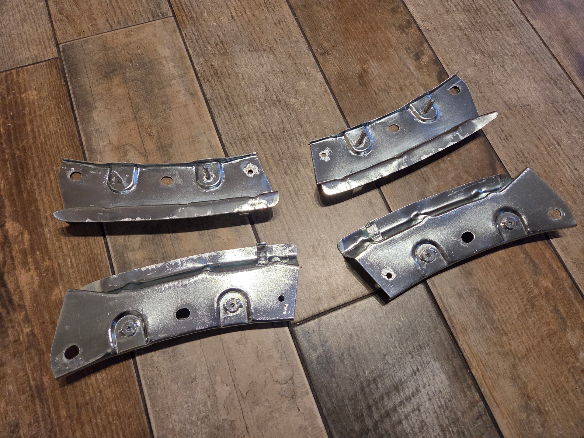

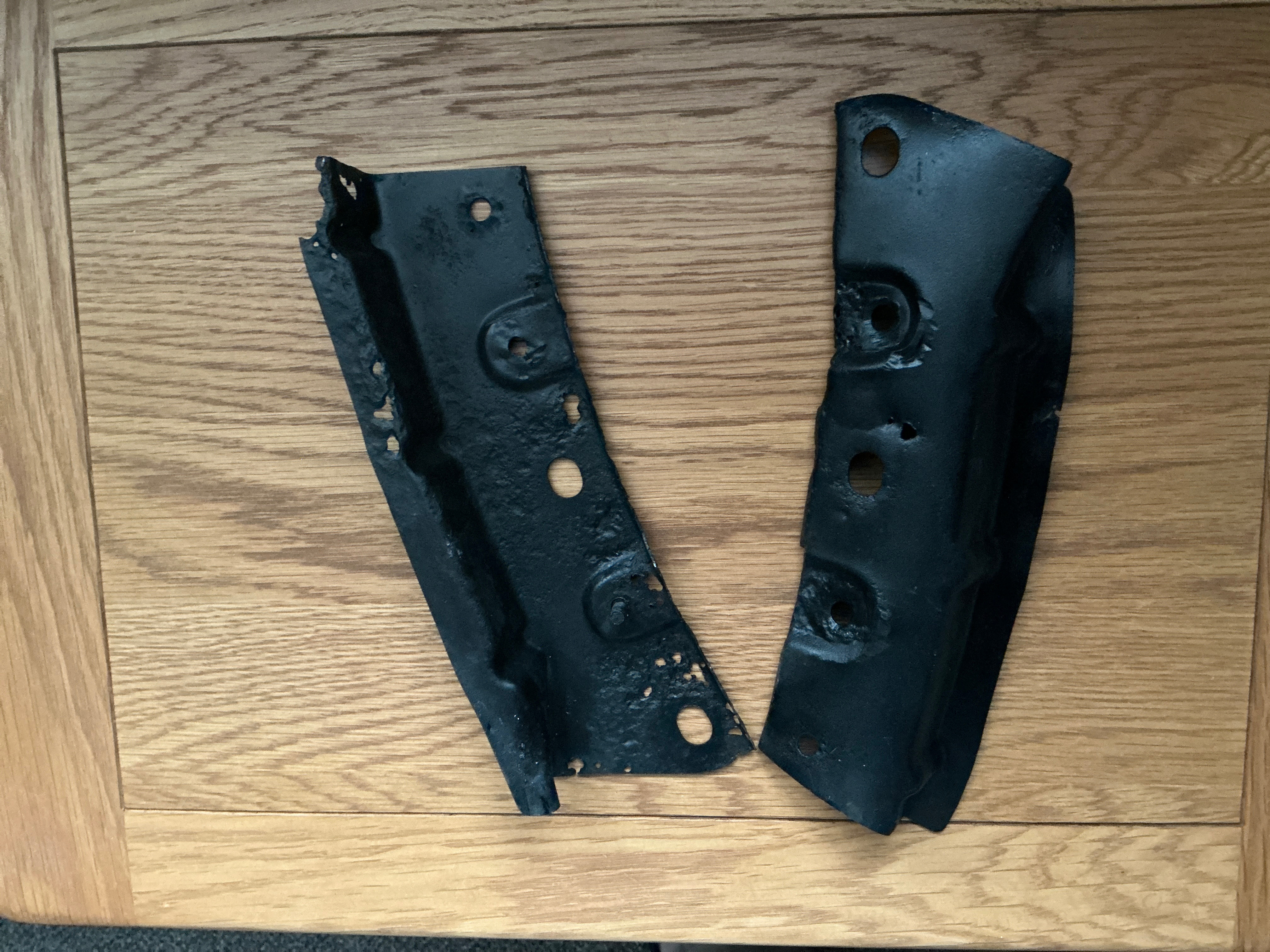

Some time ago ( 18 months) I removed the front aero , panel and head lights. I have these brackets , does anyone know where they fit please?
They are the lower sandwich plates for the front bumper that go with the upper brackets where the headlights are. Without these fitted the bumper will sit a few mm lower and wont be clamped properly to the headlight buckets. I dont think you can fit them without removing the bumper, not easily anyway. They tend to rot away, I had a fabricator make me some replacements as they are no longer available…
Thanks for the advice, front panel still off the car, now it’s seems obvious where they fit but it’s been 18 months since strip down for painting front panel and reconditioning parts.

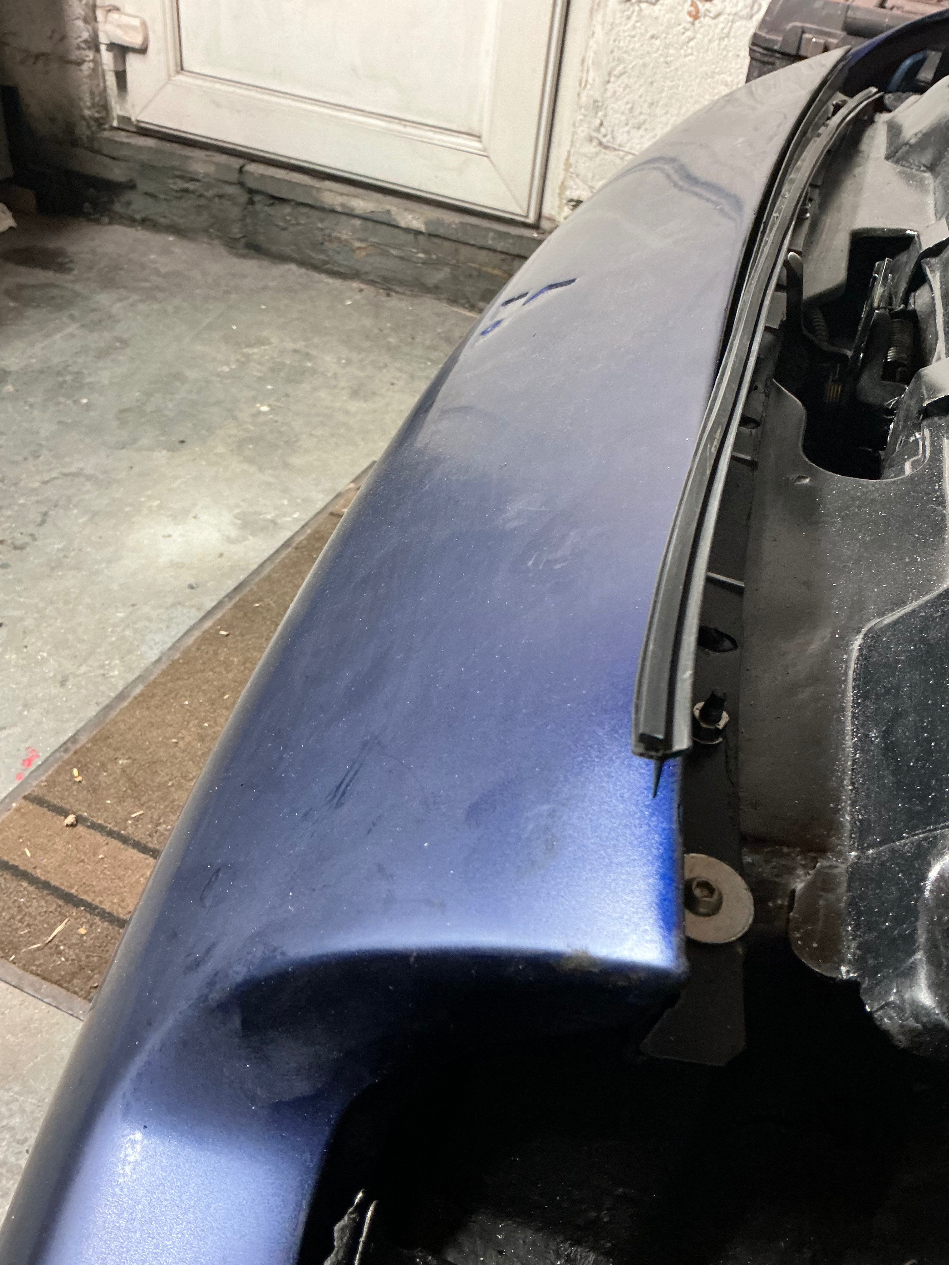

This is the rubber I need, fits between two curved angle brackets on the front
Mine is split and it’s gone hard and brittle.
Yep, I got one of those spare. I’ll grab it tomorrow for ya

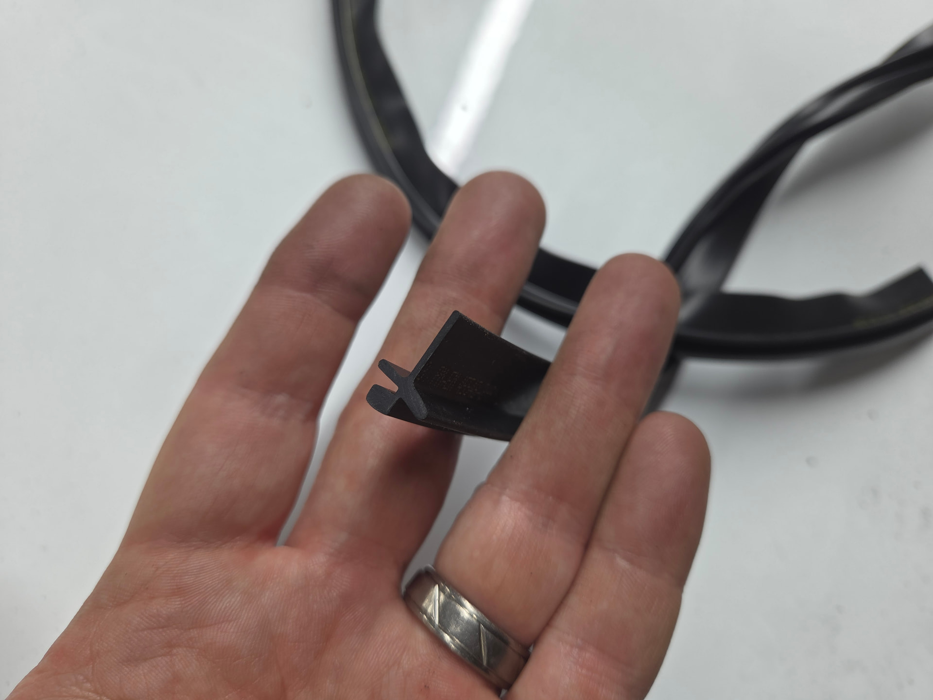

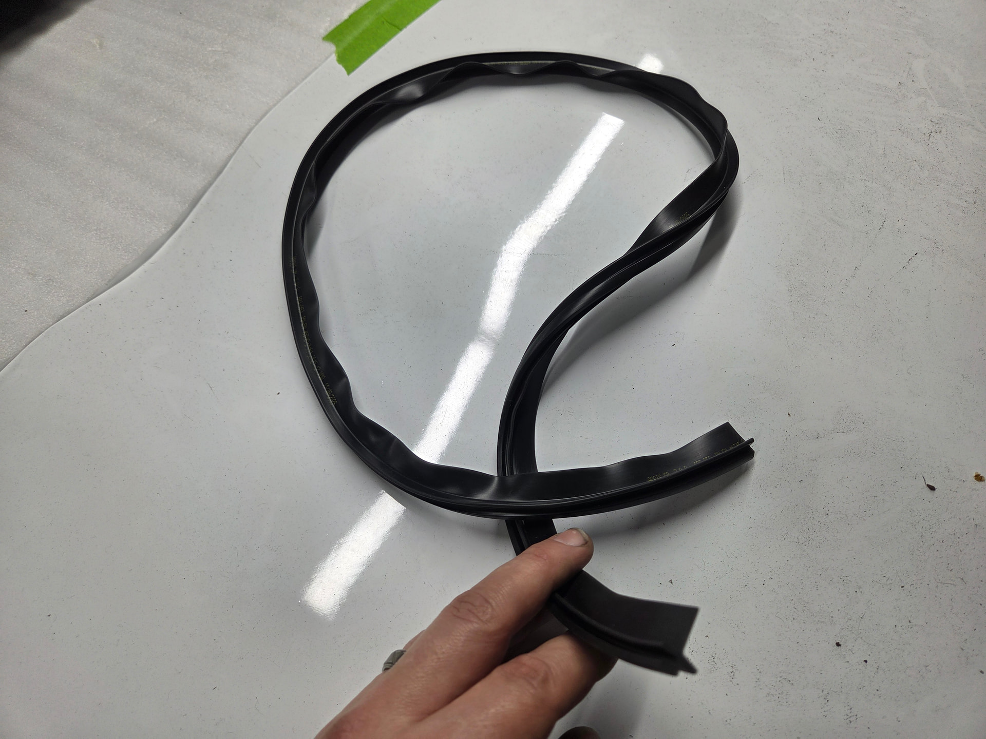

Hi bud. I retrieved a seal and heres some pics;
I bought 3, I think they worked out about £25 each. So I can do it at that posted in a padded bag as they are very flexible and were supplied curled up.
