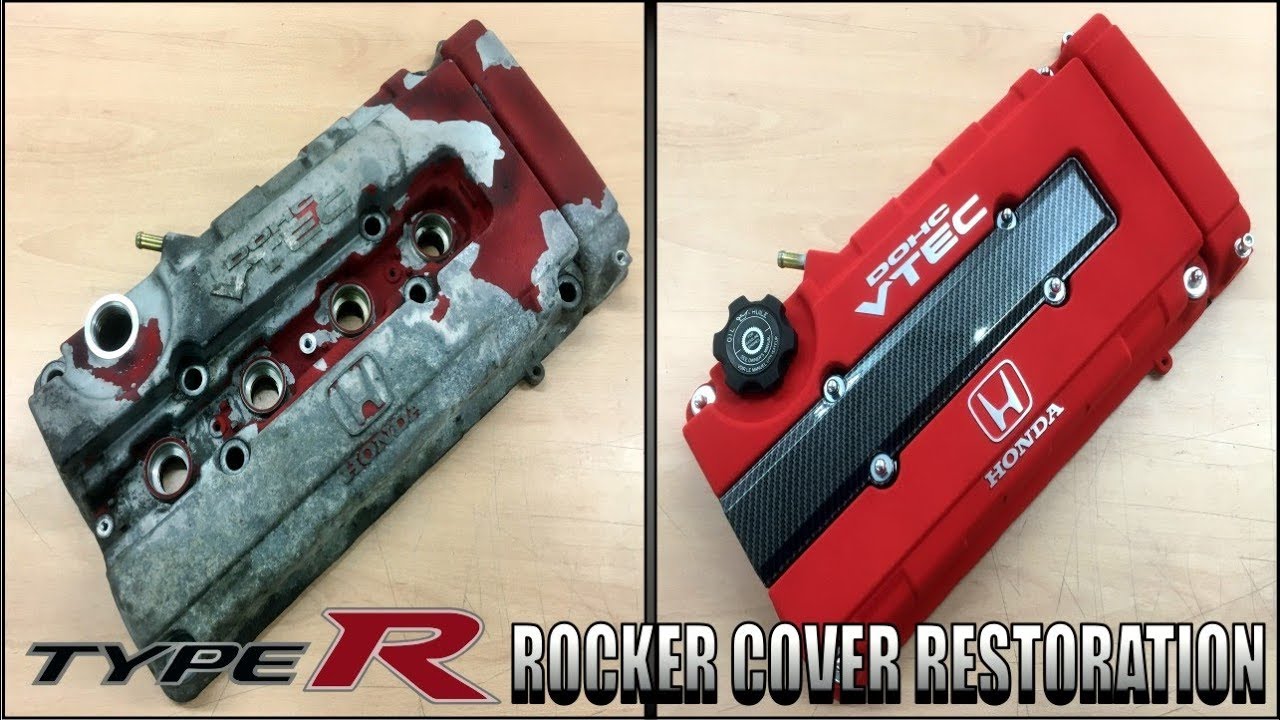

I’ve been looking at this video, looks easy enough, I kind of like the Wrinkle Paint effect,
I might give this ago at some stage, If it doesn’t work out, i’ll just get it blasted off again.
