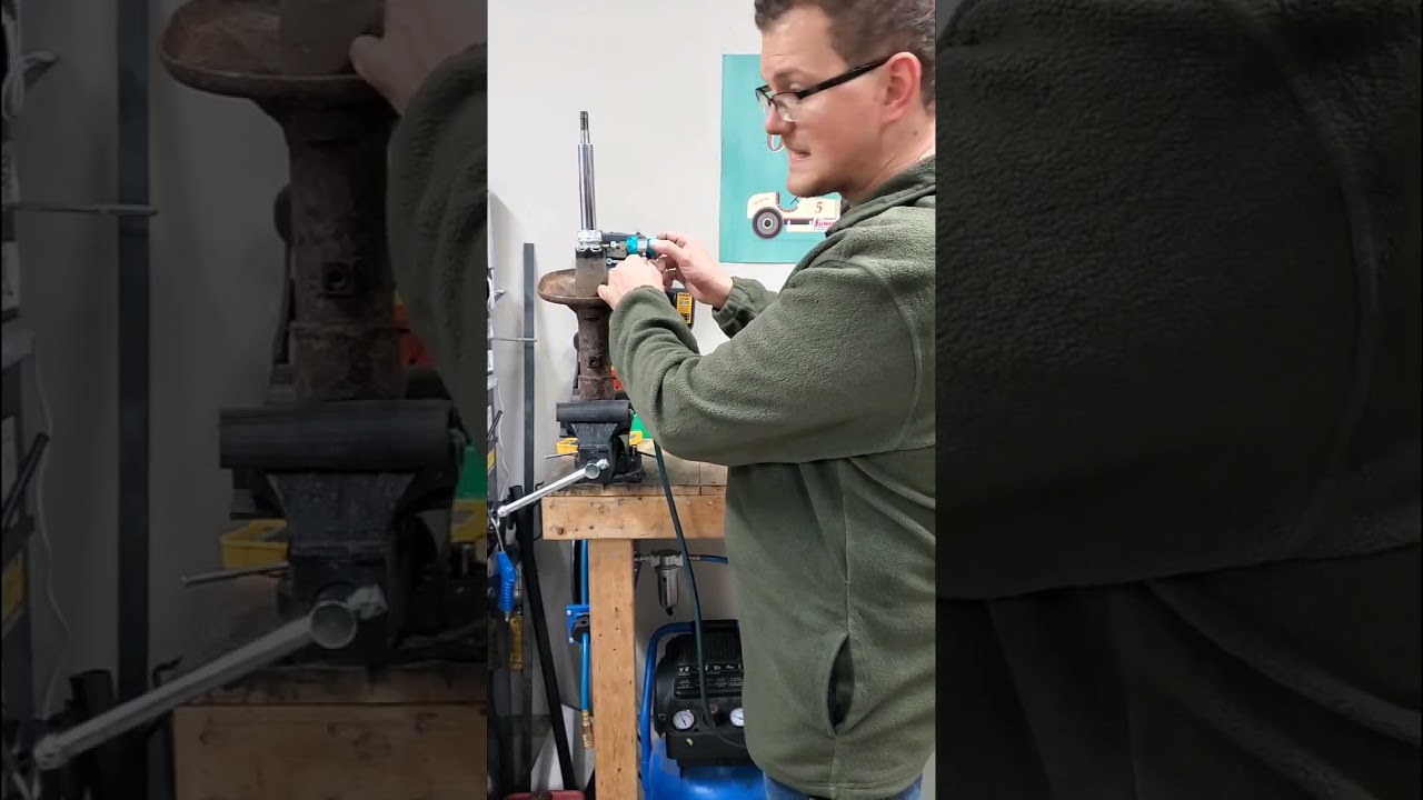

I’m proud to announce I have developed the tools and methods required to service our Front ECS Shock Absorbers.
A little bit of background on this project. I’m a mechanical engineer living in Vancouver, Canada. Back in 2019, I purchased the last six factory fresh ECS front Struts (MB892370) in North America. I kept two specifically for this project and sold the balance. Using these as a baseline, I’ve run them on the shock dyno, measured nitrogen pre-charge, oil amount and viscosity at different temperatures to establish factory baseline numbers. I’ve purchased several used and blown out pairs of front ECS struts, developed the service procedure and dyno tested the results to EXACTLY MATCH the factory parameters. To ensure my process and parts stand the test of time, I performed static pressure tests to ensure proper seals, high-cycle tested on my shock dyno and am currently road testing. I will post the shipping address once testing is 100% complete. Target completion date is Mid-October.
My Base Service for Front ECS Shocks ($200USD/ea, $350USD/pair)
  • New NOK Oil Seals
  • New Shock Oil (Redline Brand) mixed to OEM Viscosity
  • New Piston Rod Guide Bearing
  • Piston Rod Cleaning and Buffing
  • Base Valve and Main Valve Teardown, Clean and Inspection
  • Piston Rod Motor and Switch Check
  • Nitrogen Charge to OEM Spec
  • Shock Dyno Verification + QC Report

Update. the nitrogen in the strut should not be more than 15 psi.
There is also a way to add nitrogen through the top seal. watch following link:
