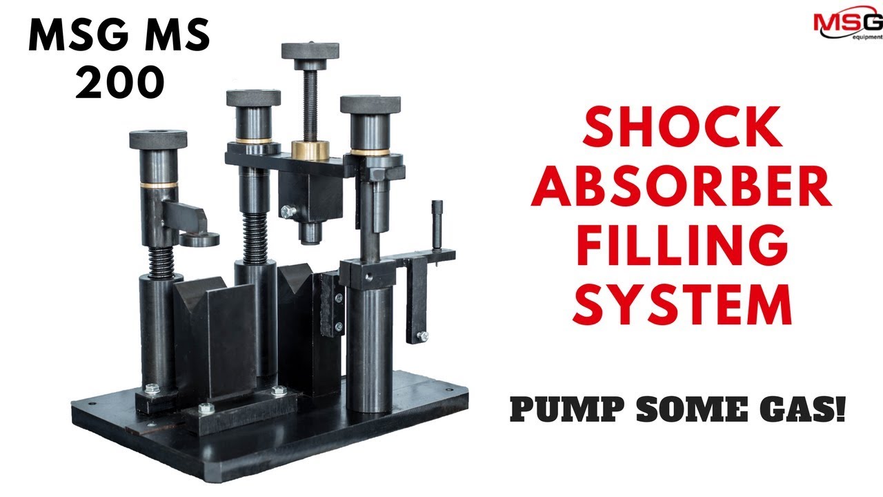

Related videos for getting to the point of correct service rebuild
Also…
Min 10:30 shows this nitrogen filling device much better!
https://www.youtube.com/watch?v=US38YT4SSdg&list=PLt3oHqVdOfXIpgoLQbvPMuUmHB6Lw3FNk&index=12
Whilst these videos are a great source of general information, they do not show or give any information what so ever about KYB electronic struts.
Can I also say that using the wrong volume of oil will severely affect handling of the vehicle.
Finally, the struts in the video have a much thicker wall than the KYB struts. If you try to modify the wall or add the wrong pressure of gas, there is a very high risk of explosion either whilst injecting the gas or when driving. Both could be fatal.
I have not gone ahead with the second referb video on these struts because I don’t have accurate corroborated evidence of oil and pressure. I will not risk lives by giving random information gathered from the internet. I hope you understand. I will allow the uploading of these videos on the understanding that they are for general information only and that I do not endorse these methods for our struts at this time.
