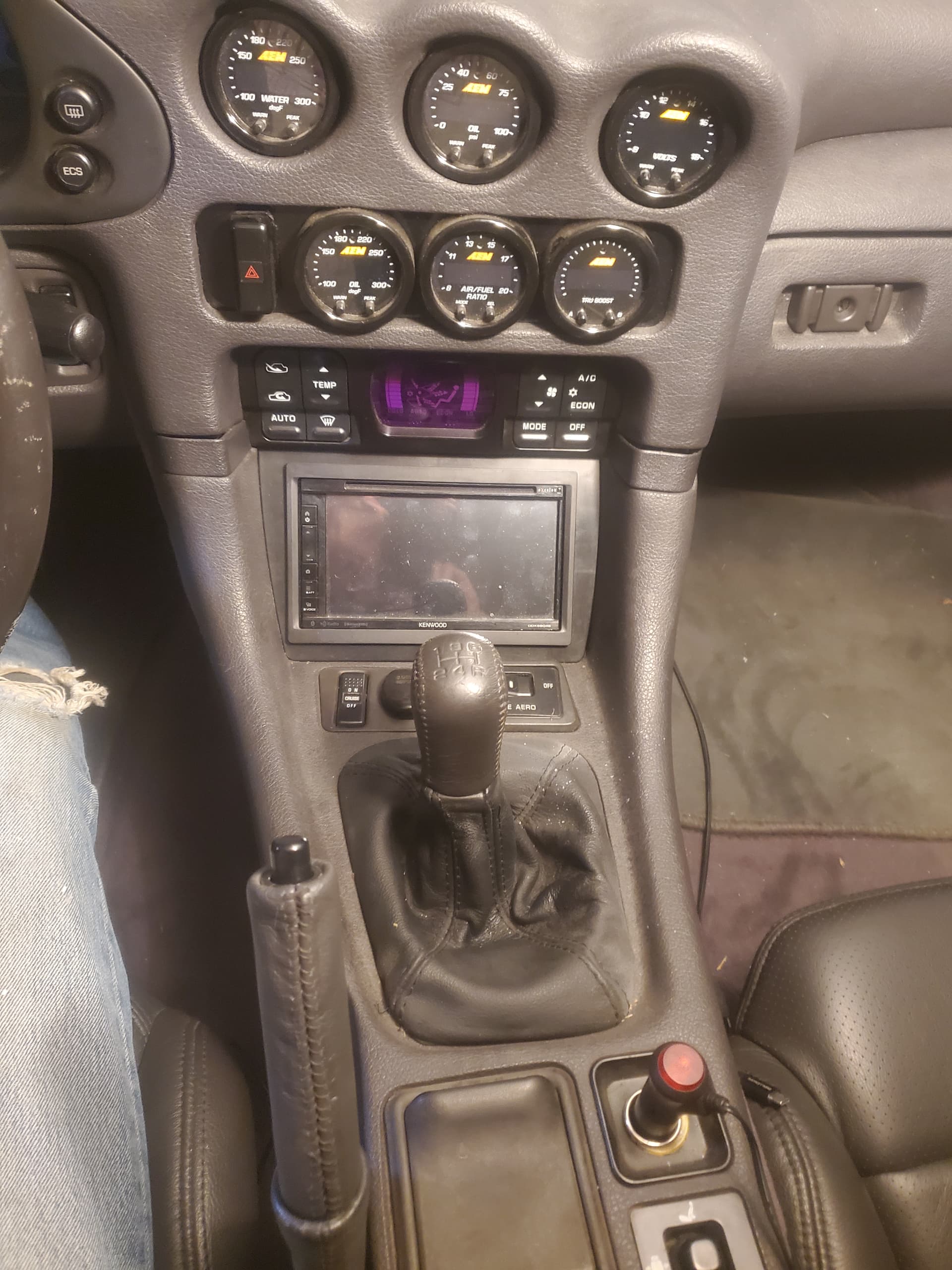

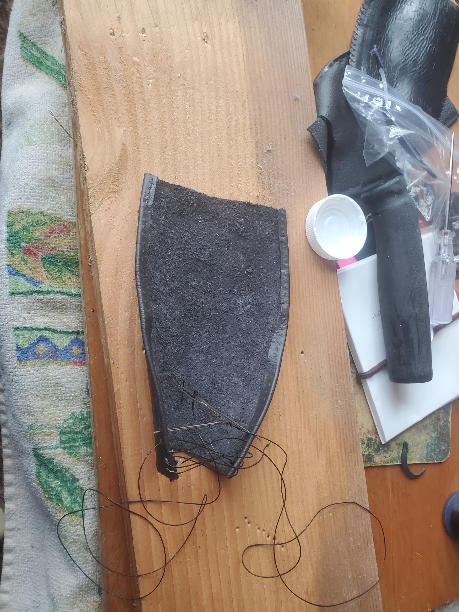

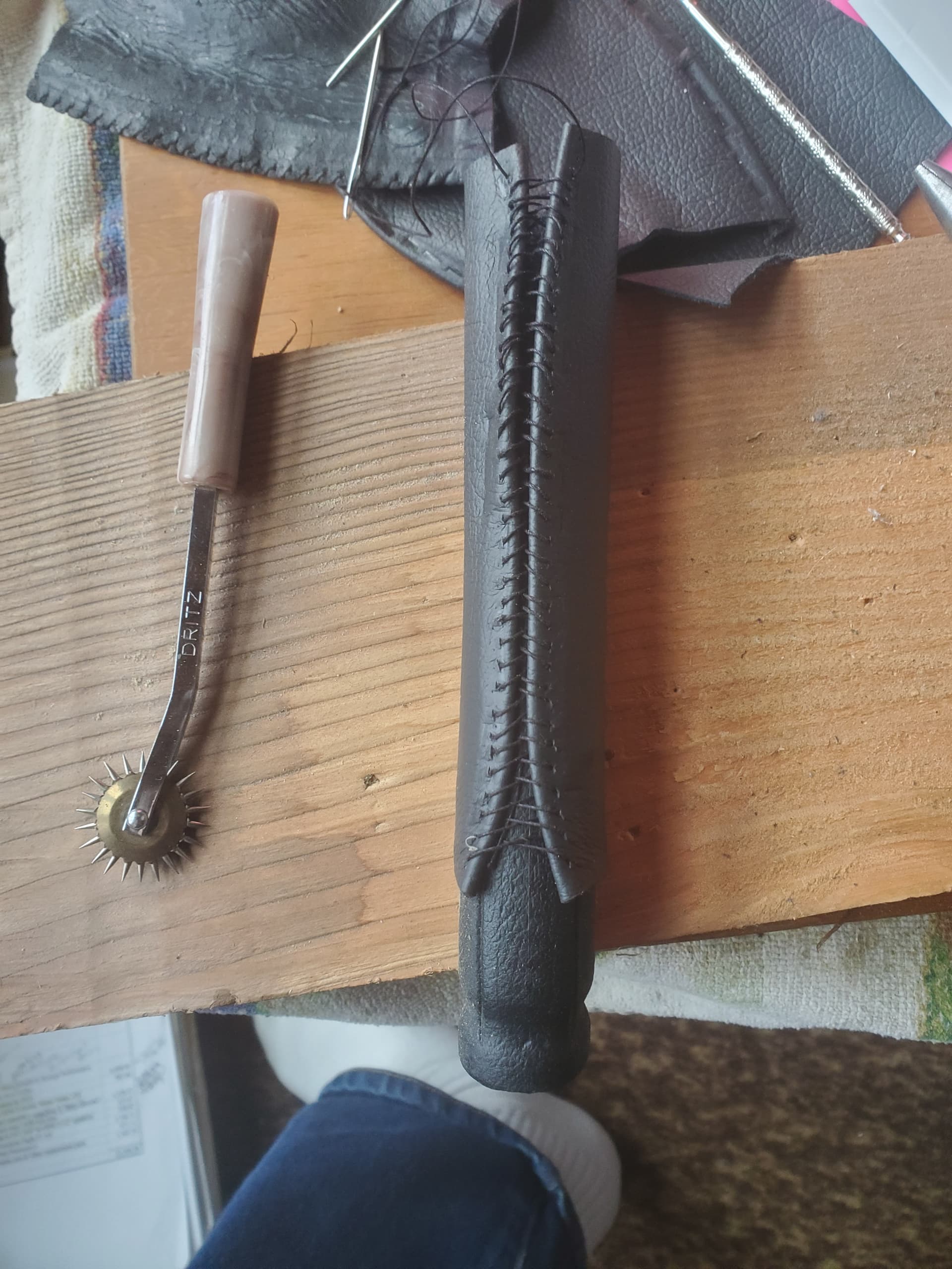

Recovered my e brake handle. Brake handle slides off e brake bracket. I used gray leather left overs from recovering front and rear seats. Used old e brake handle leather for pattern to cut new leather cover for handle. Sewn leather on handle.

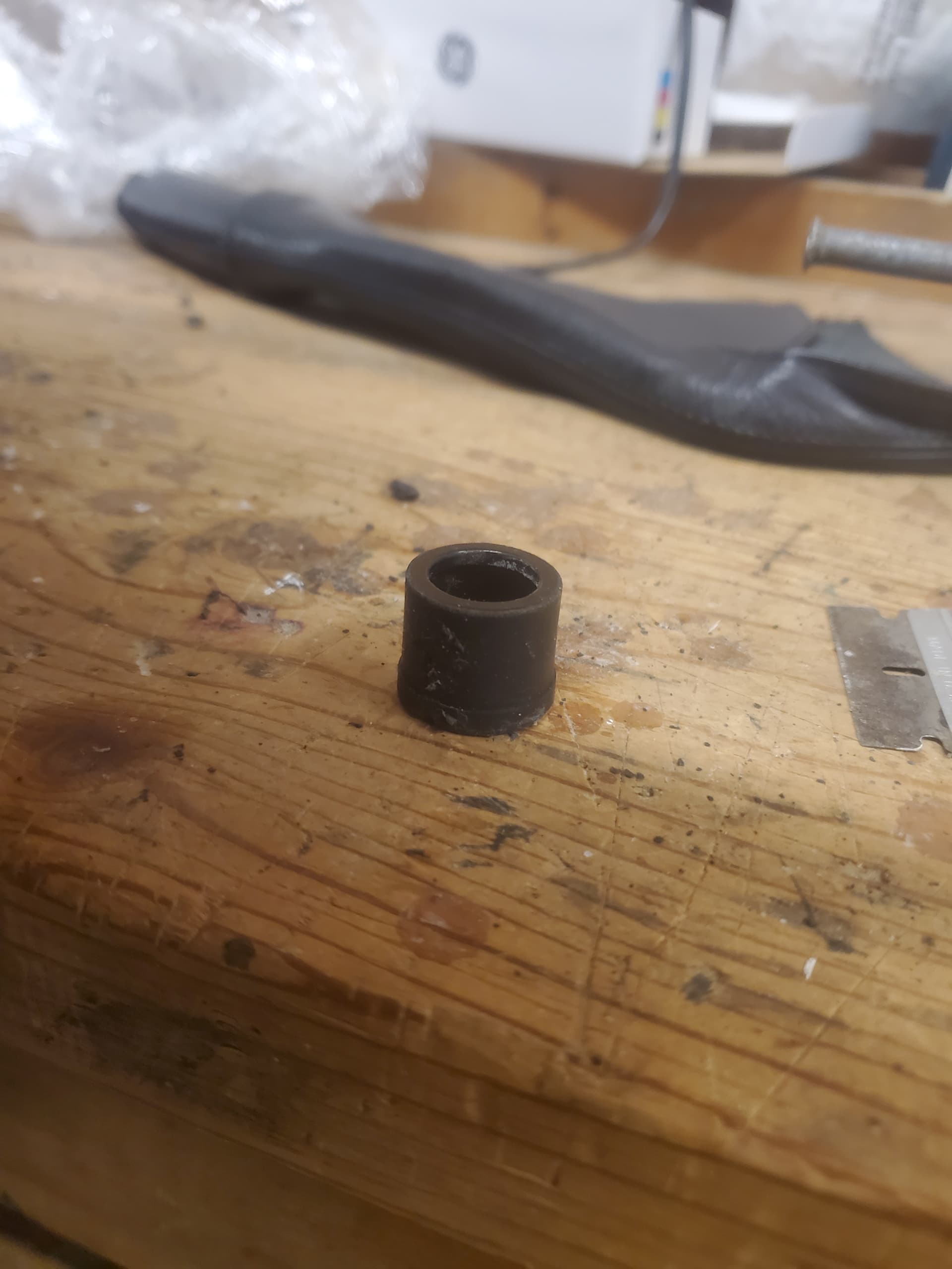

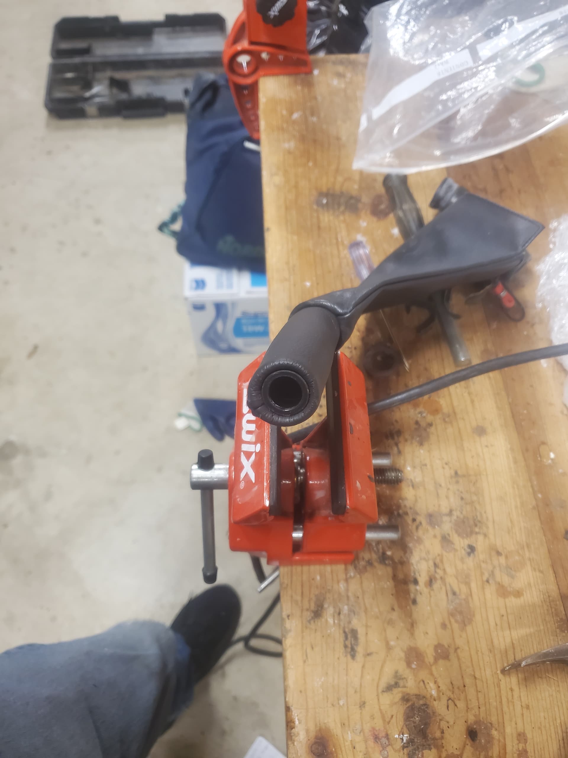

Bought a beat up 3000gt leather e brake handle on ebay. Cut the handle to get the insert out of the handle. Press incert into handle.
Also bought 3sx e brake handle button and screw it on.
Not bad.
